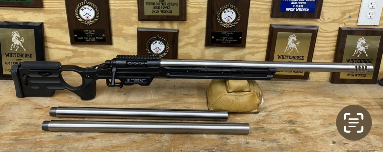

I have one action and .223 , 6BR, 6.5 creedmoor, .308, 6.5 PRC, and 300 WSM barrels.
I like prefits.
I can recommend Altus for a great 6br one. Mine is from them and is a hammer.

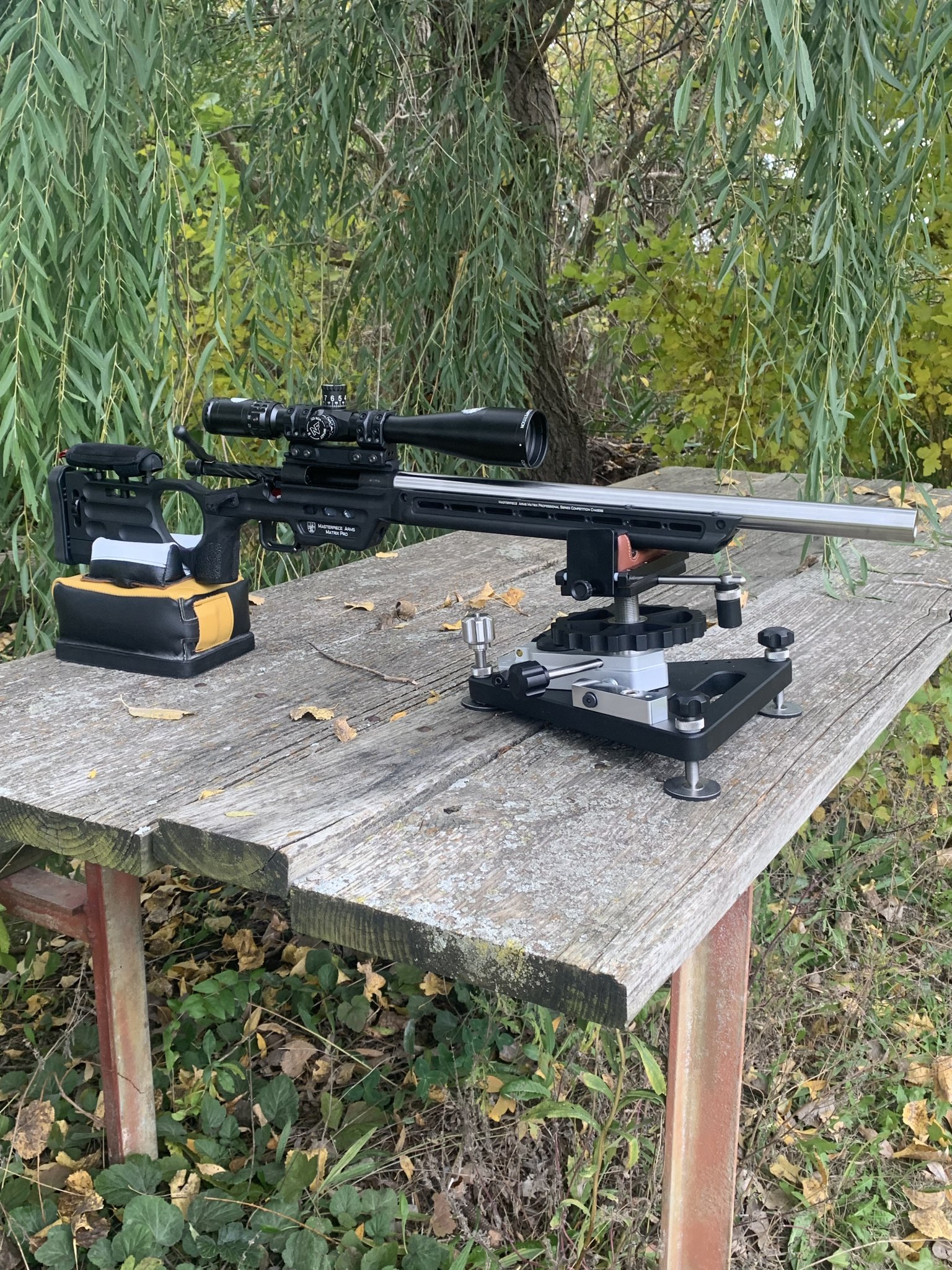

I am running a Zermatt Origin short action.
You can change the bolt head at home with no tools.
So I can run all 3 in a short action.
Then just swap barrels.
I am biased, and they (the Zermatt actions) are just darn good.
My 6BR shoots unbelievably well.
As does my .223, .308, and 6.5 prc.
Havent shot the 300 wsm yet and soon.
Barrel swaps are a breeze with an $80 barrel vice (I use the PMA Tool one) snd a Zermatt action wrench ($80).
I mounted the vice on 2” tube and can lock it down in my receiver hitch, bench vice, or with a couple clamps.
