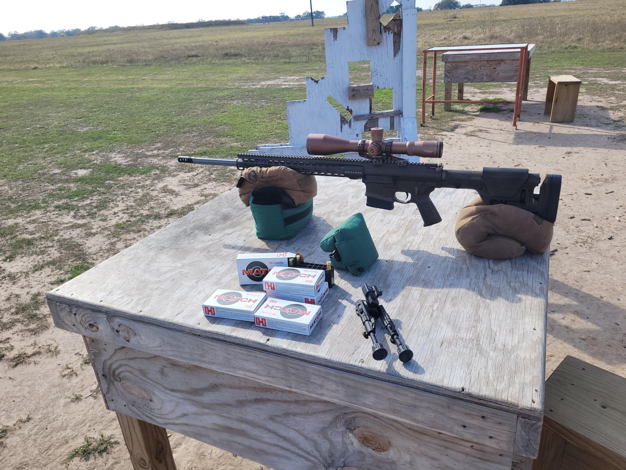

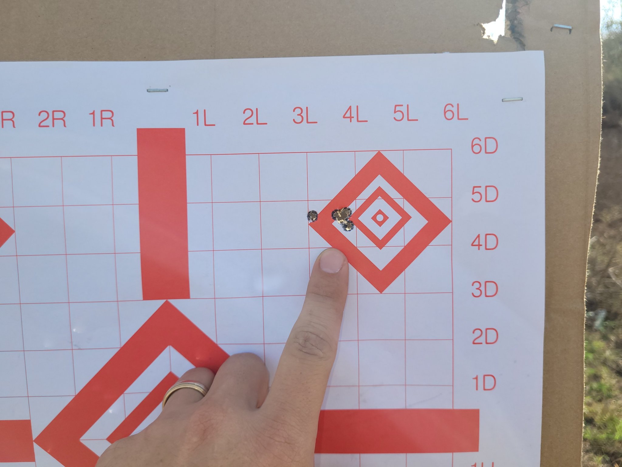

Took mine out today. I'm way way out of practice.
Shot three different rounds through it, 12x (I don't remember) Winchester White box, 140 Berger and 140 Hornady American gunner
They all did well, the burgers grouped best but the American gunner was close. Id get a good group of 3-4 then id start pulling shots and I know it was me.

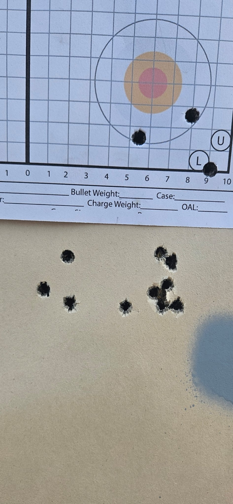

I will say, while not super impressive, this was 10 rounds rapid fire at 100y with the cheap Winchester White box I bought. Just to see what happens. I was most impressed with this. About 2" group. Rounds were sent as soon as I got a sight picture again so definitely quickly

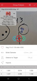

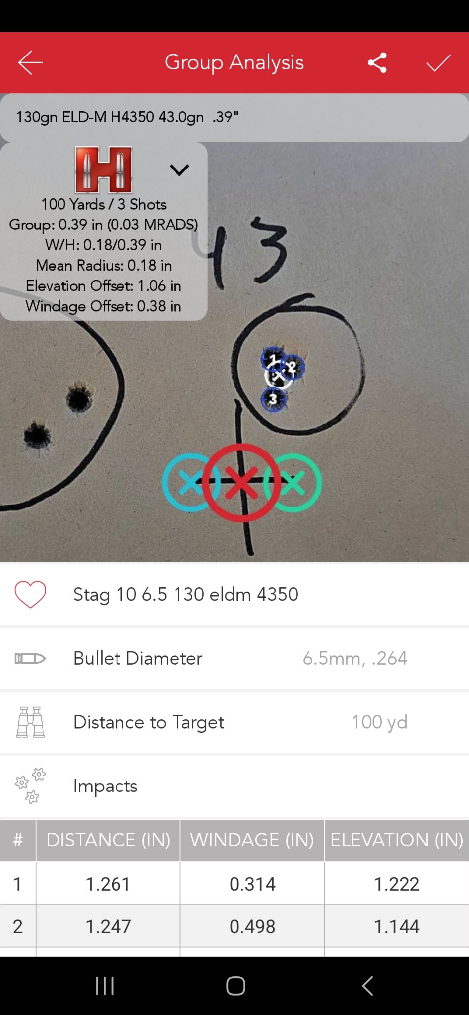

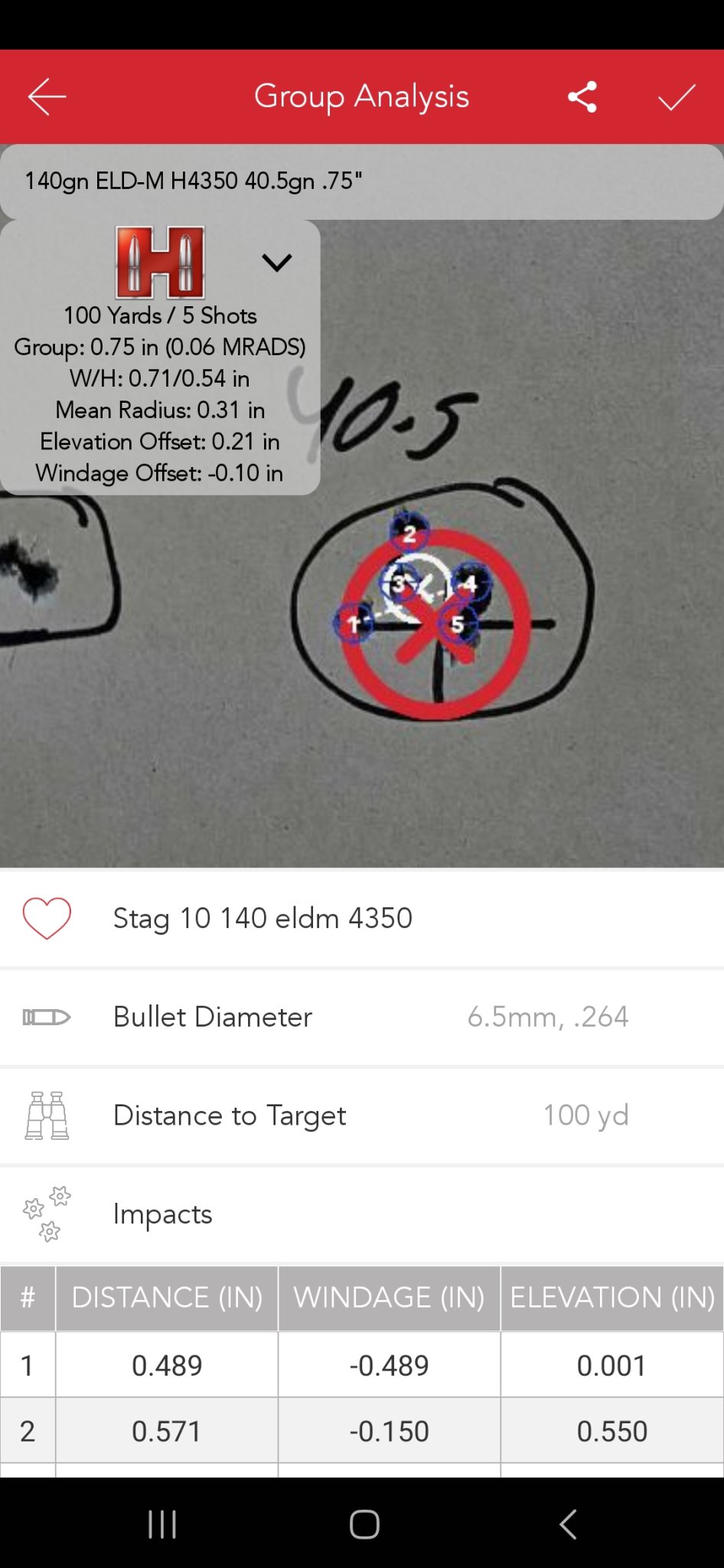

I got it back out to the range this weekend. Originally i was semi happy with the way it shot, but not stellar over the moon excited. I need to set my expectations because my last 6.5cm was a bolt gun with a 31" Brux heavy palma barrel so yeah completely different animal lol.
Did some quick load workup for 140 ELD-M's and 130 ELD-M's using both 4350.
I haven't tried to shoot for groups in almost a year now and the bench i was shooting from had a very low seat so was very hard to get into a position that i was stable and comfortable in. But overall it did well and i think I'm right where i should/want to be for a budgetish gas gun.
That was Friday, Saturday i was supposed to shoot a F-Class match that ended up getting cancelled due to weather while i was enroute. I asked the Match Director since I was already halfway there if i could still do some shooting and he said sure.
I didn't bring any targets with me as the club uses Shot Marker electronic targets and since the match was cancelled they didnt set anything up. We do have steel gongs at the target line so i spent a couple hours in 20-30mph winds shooting at the gongs. There is a 4', 2' and 1' gong and was able to repeatedly make hits on all three at both 600 and 1000 yards. No idea what the grouping looked like and was definitely fighting heavy winds. But the BA barrel seemed to do really well. I also was still only shooting the factory ammo i had bough so i can get some of the brass fire formed. I am excited for next month to get back out and see what it can really do.
Was a blast shooting rapid at 600 on the big gong and by the time my 10 round mag was empty i could still hear 4-5 impacts hitting after I was done firing. And the wind definitely added something 'extra'
