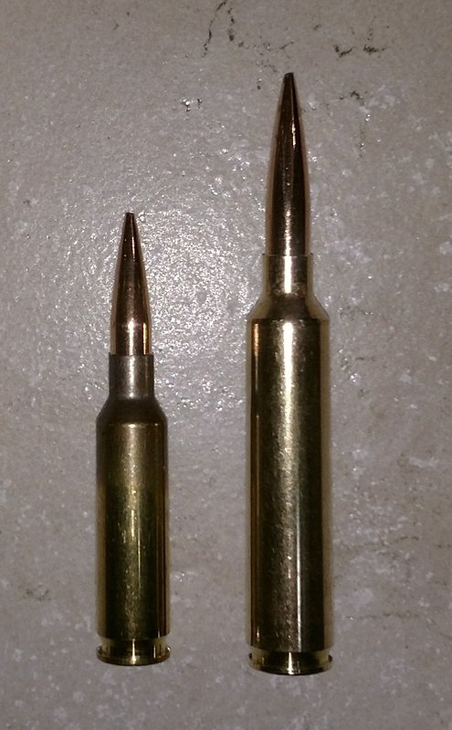

    Just received my first batch of 28 Nosler from Copper Creek. They are loaded with the 195 Berger's. Should have my barrel in a couple more weeks! Can't wait. I snapped this pic next to a 6.5 creedmoor for comparison.

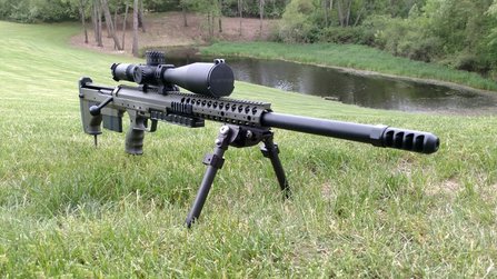

    I had my 28 out again this weekend. I am so impressed by this cartridge. Accuracy right around .3 moa, recoil is way less than anticipated and the wind cutting ability is incredible. This is by far my favorite caliber now.
    Todd
    Todd
    That looks mean. What brake are you using?

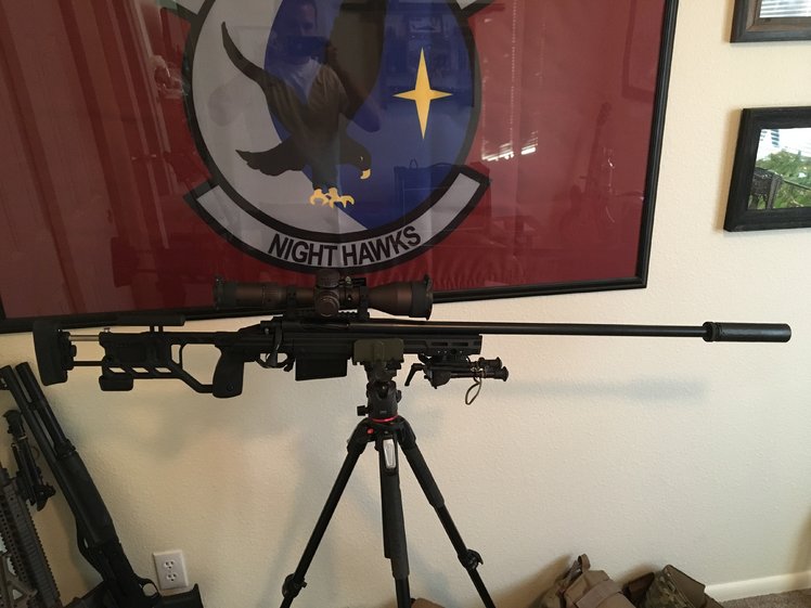

    Here's mine. I just got done with eye surgery so I'm not sure when I'll get to shoot it, but I'll be putting together some test loads this week.
