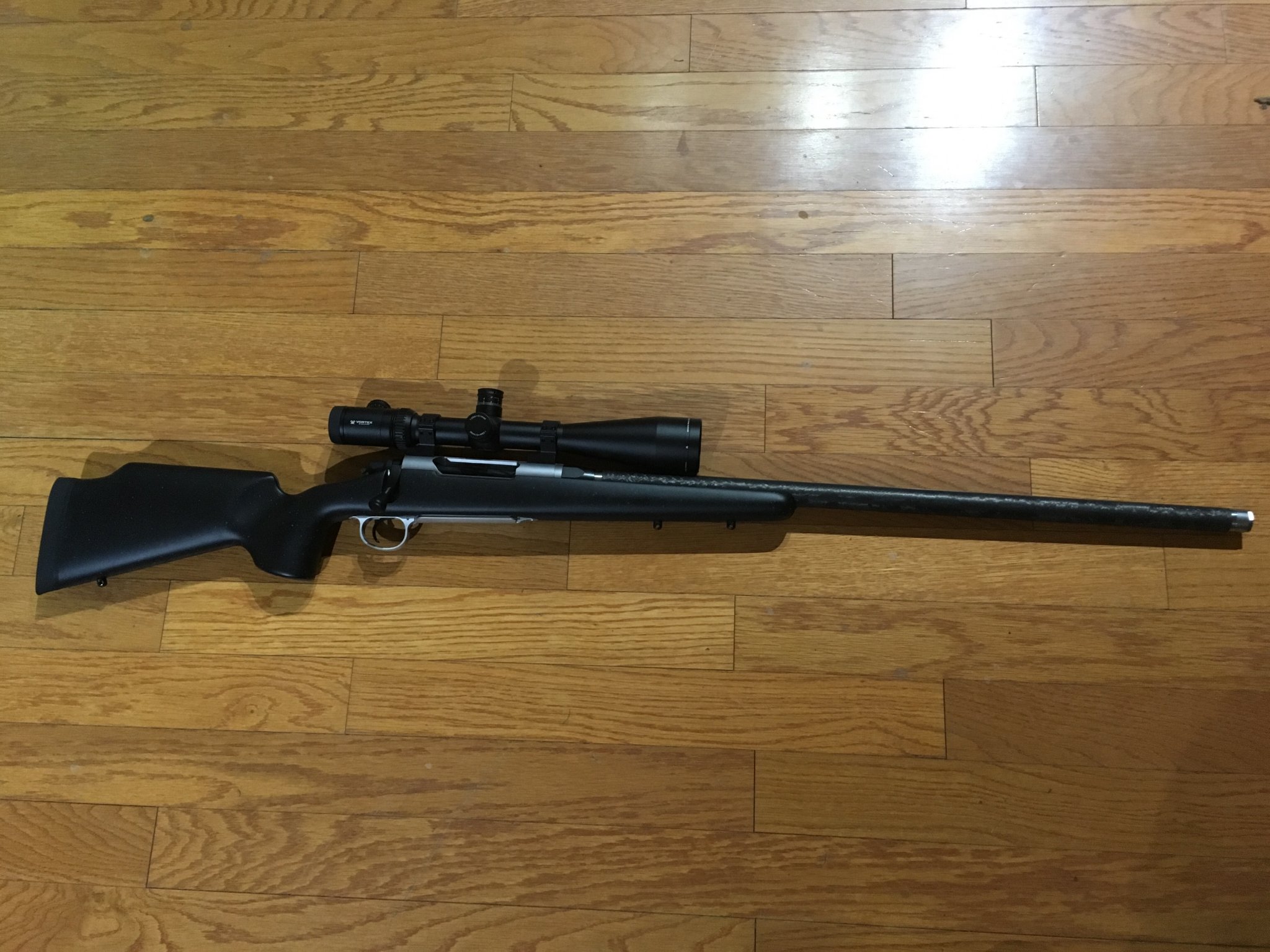

Check out Mesa Precision Altitude stocks. I went with it on my 6.5-284 build that weighs 8lbs 7ozs with a 28” proof cf barrel, shilen dgr long action and a vortex viper 6-24x50. The stock weighs25 ozs with the buttpad and is already inletted for an oversize recoil lug and proof contour.

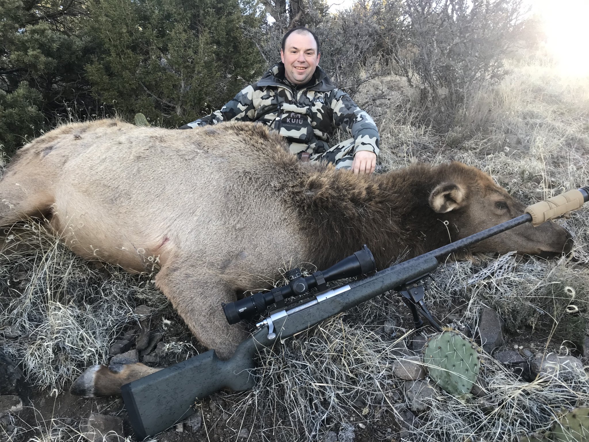

I took my cow elk this year with a 180 ELDM and couldn’t of been happier with the retention and lack of jacket shrapnel in the meat.
