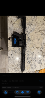

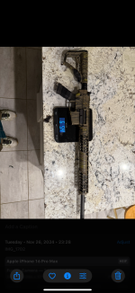

Nice rifle. What would you estimate that rifle cost you to get so light? I'm adding it up in my head and it looks like you're probably pushing $4k in parts, am I in the ballpark?

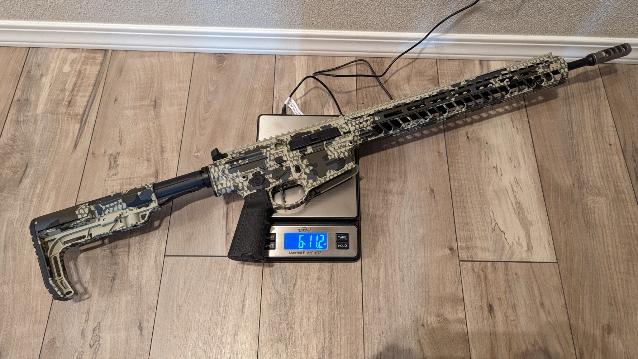

Here’s a few pictures of my Faxon 🫣 Gunner weight 16”barreled 6# empty AR10 on my clubs 600 yard range. Take a look at the 10 ring and x ring as I walked my shots into it on the electronic target with a bastard old Leopold illuminated 4.5-14 Mark 4 with TMR reticle and MOA turrets 🙄. I got really lucky with that Faxon barrel. Light AR10’s can perform; who knew.
I bought parts on sale over two years before I put those together, so I have about $2400 in each one, but that was 2015-2017 time frame. So yeah, full retail in today’s money would very likely put them in the 3k to 4k range I would guess. I paid $120 for that Faxon 308 barrel on sale a Brownells for example and my most expensive titanium bolt carrier was that Cryptic Coatings one in the 6.5 and it was a blem on sale for $350. It’s not cheap to go light. I bought blem received sets from 2A for $450 instead of the $700+ range and I don’t know why they were blems.

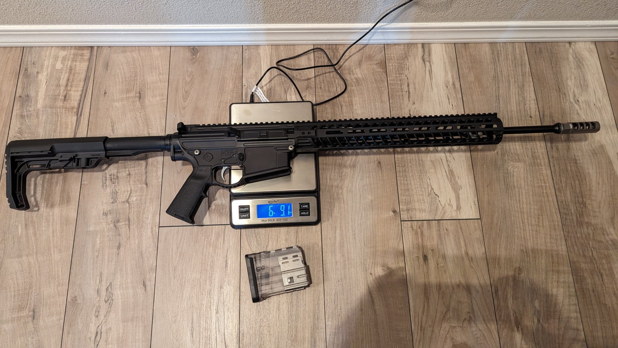

Some photos of past projects:

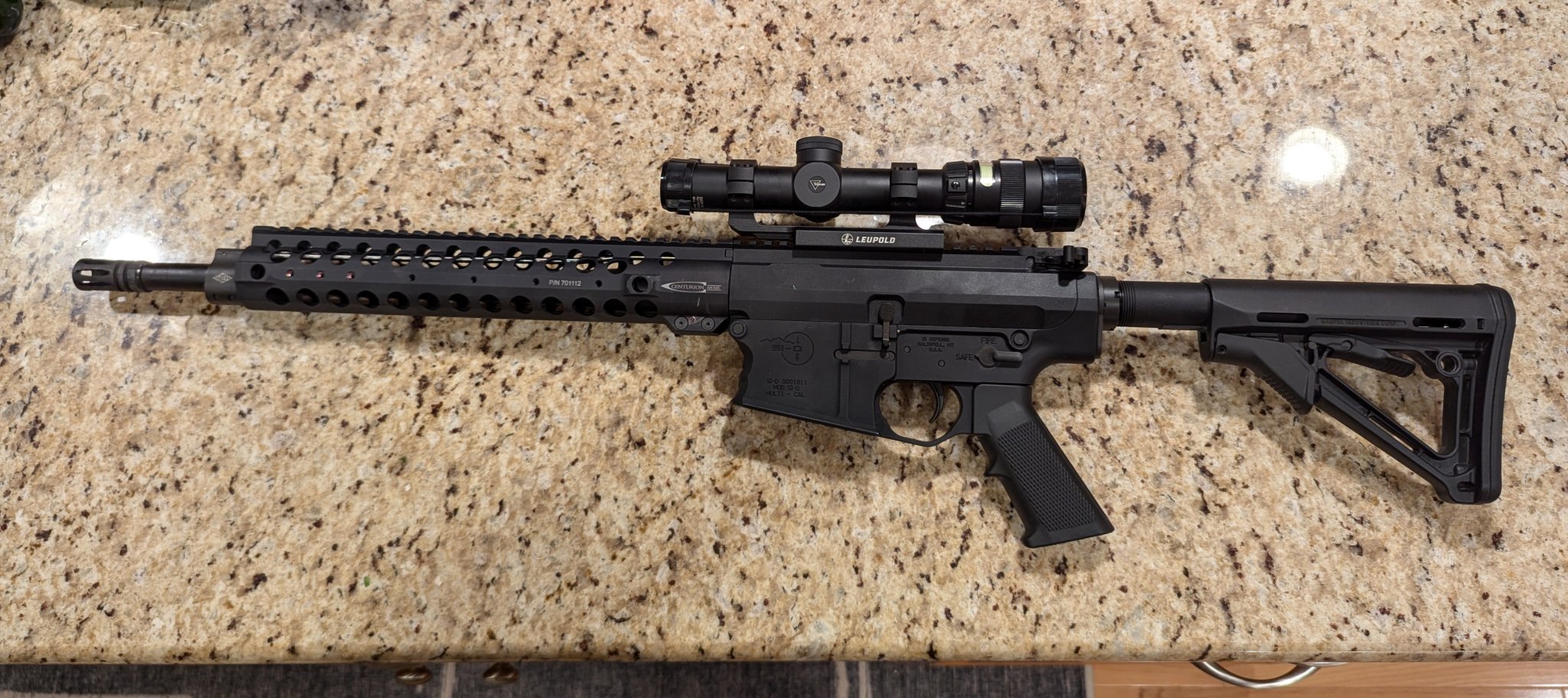

A pic of the not quite so lightweight carbine, but you get the idea of how compact a 16" 308 is... PS the TR24 is also quite lightweight and is a great choice for a short/medium range carbine

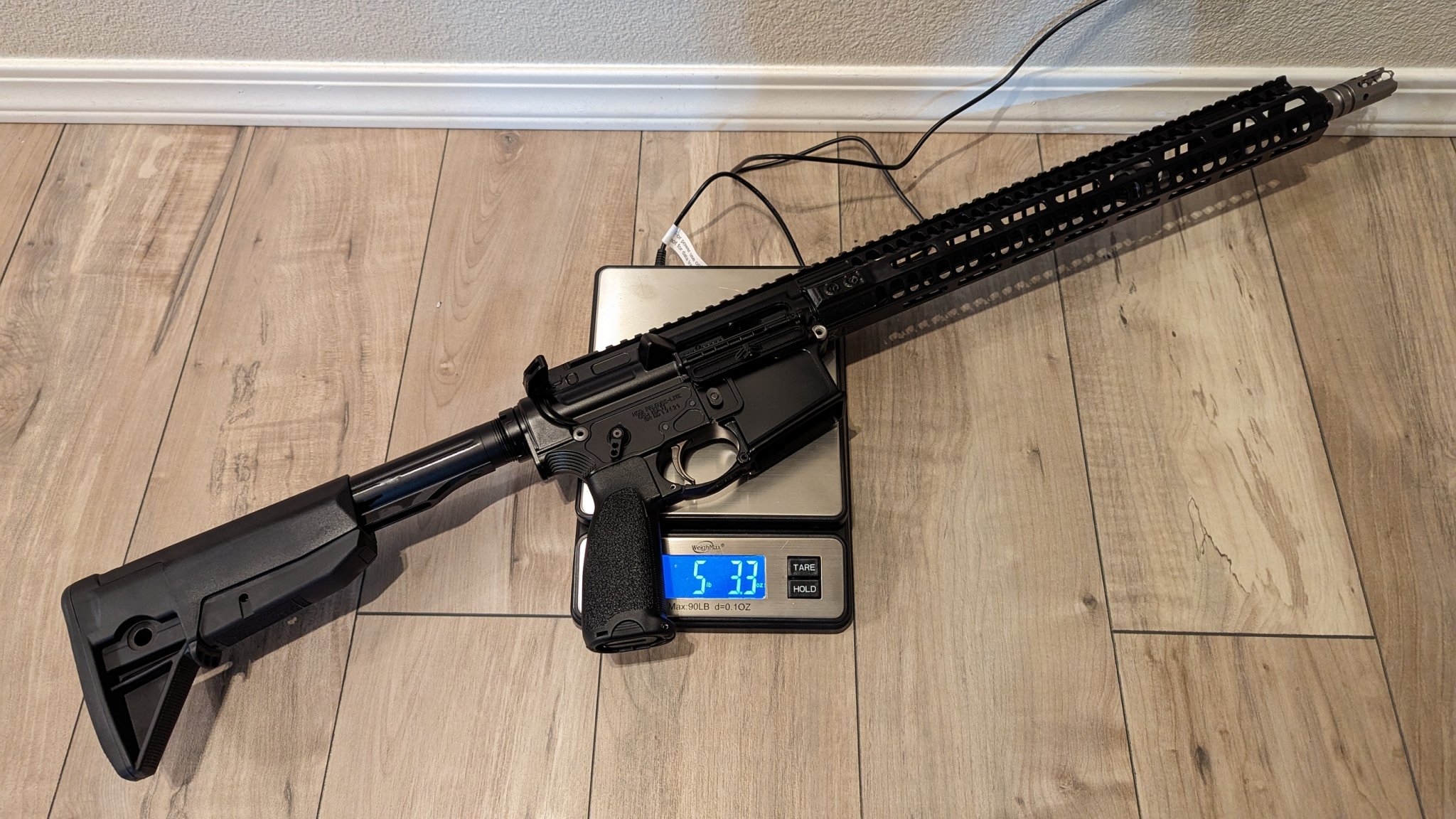

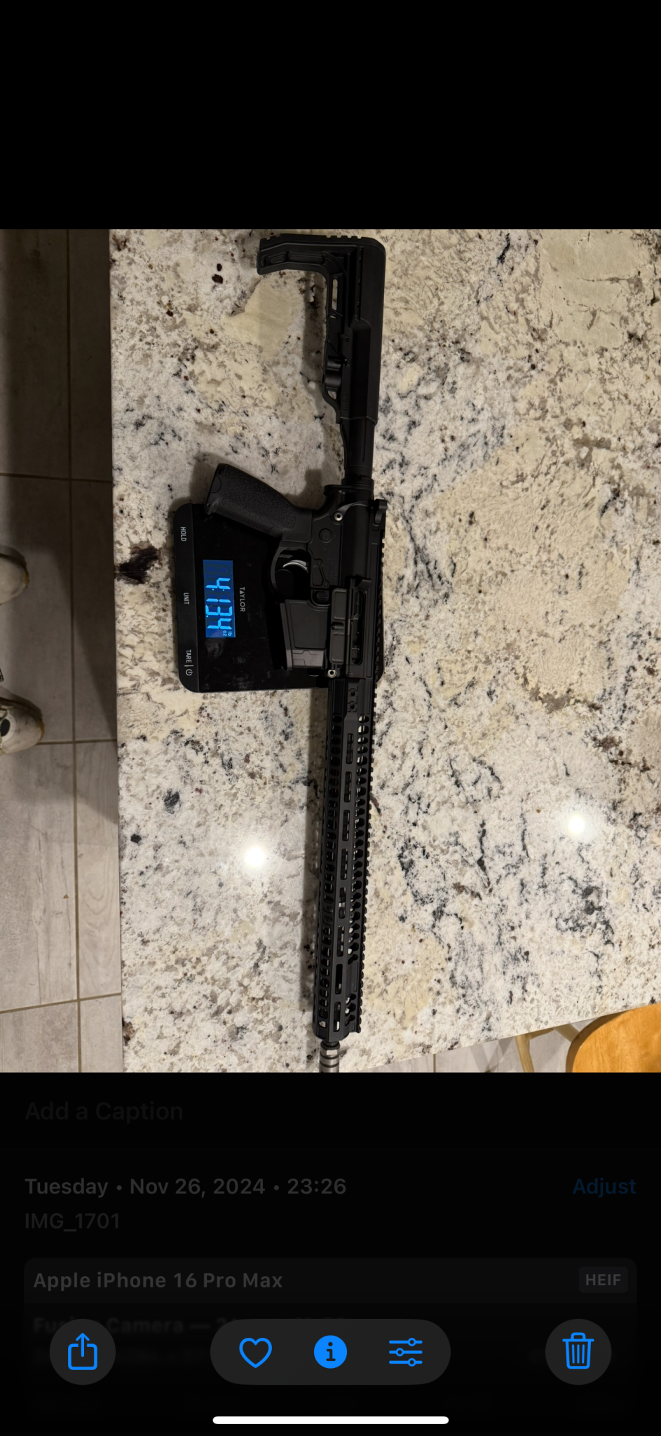

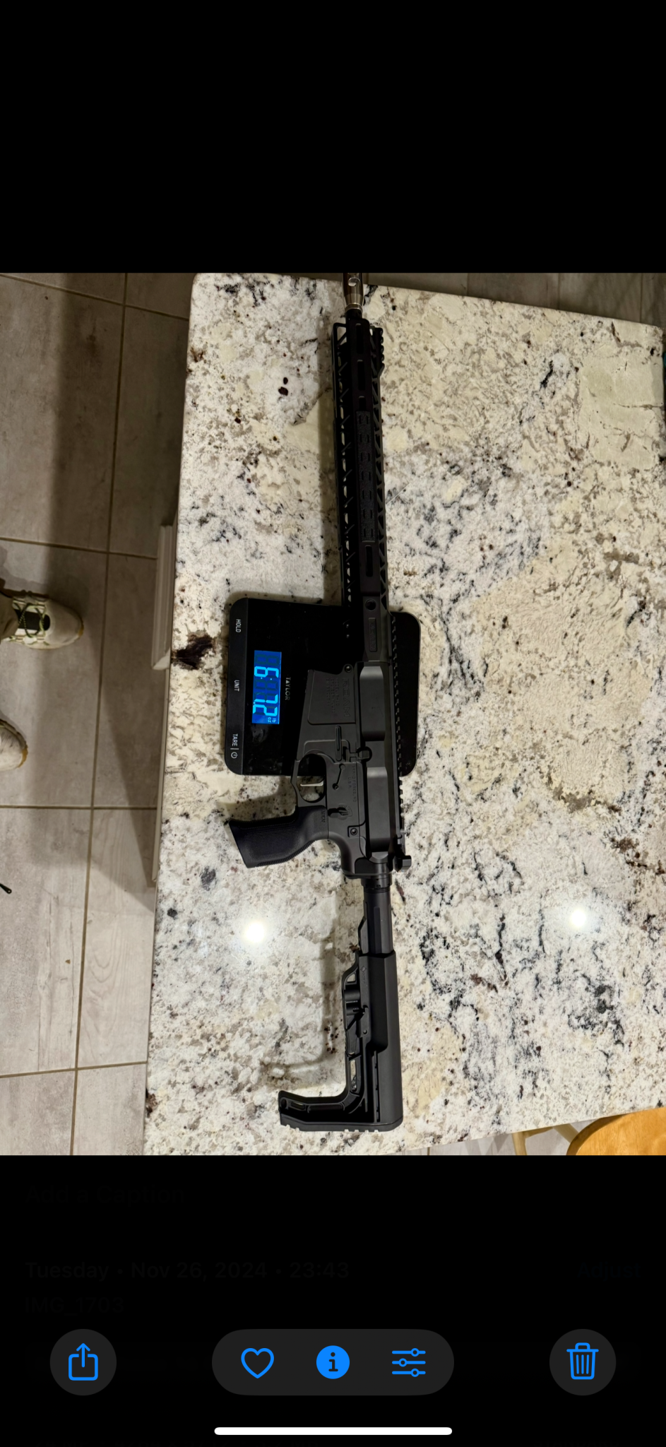

So here ya go, here’s a few of the ones I mentioned. As you can see I have nothing but good things to say about 2A, as that’s my Balios Lite Gen2. However the V7 6.5 with a 20 inch proof barrel and not the Faxon pencil profile barrel is an extraordinary weapon. The 308 Roam with a Criterion hybrid profile barrel is substantially lighter than the same profile barrel 2A rifle. The V7, Roam, and F4 Defense builds I have are just better in sustained accuracy, feel, and function. They are however more expensive and much harder to find.
