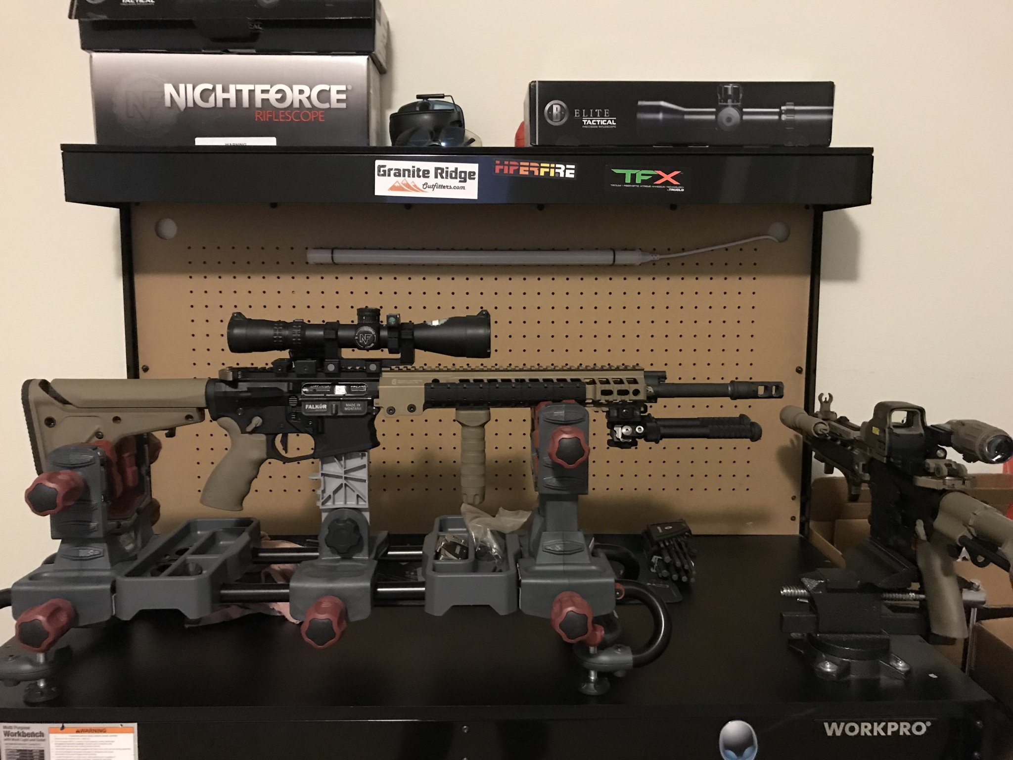

My SPR was built couple months ago with a Criterion 18” rifle length barrel and Sup Arms piston. It shoots pretty good. It has a Geissele Mk13 which barely fits the Sup Arms gas block. It doesn’t have M lok rail on the 11 and 1 o’clock either. I would highly recommend the Mk4 or Mk8 over Mk13 or Mk14. It shouldn’t be a problem if you go with a mil spec upper, otherwise, you might have some fitting issue as I did on my Falkor Receiver set. It took some Dremel work but it’s done eventually. Other than that, Geissele is good to go.
In terms of buffer, I’m going with the JP silent capture with 1 tungsten weight (H1 configuration) and shooting is pretty enjoyable thank to the rifle length. Since you are planning on 18”. I’d recommend to go with the longest length possible which is rifle length to soften the recoil a little bit.
