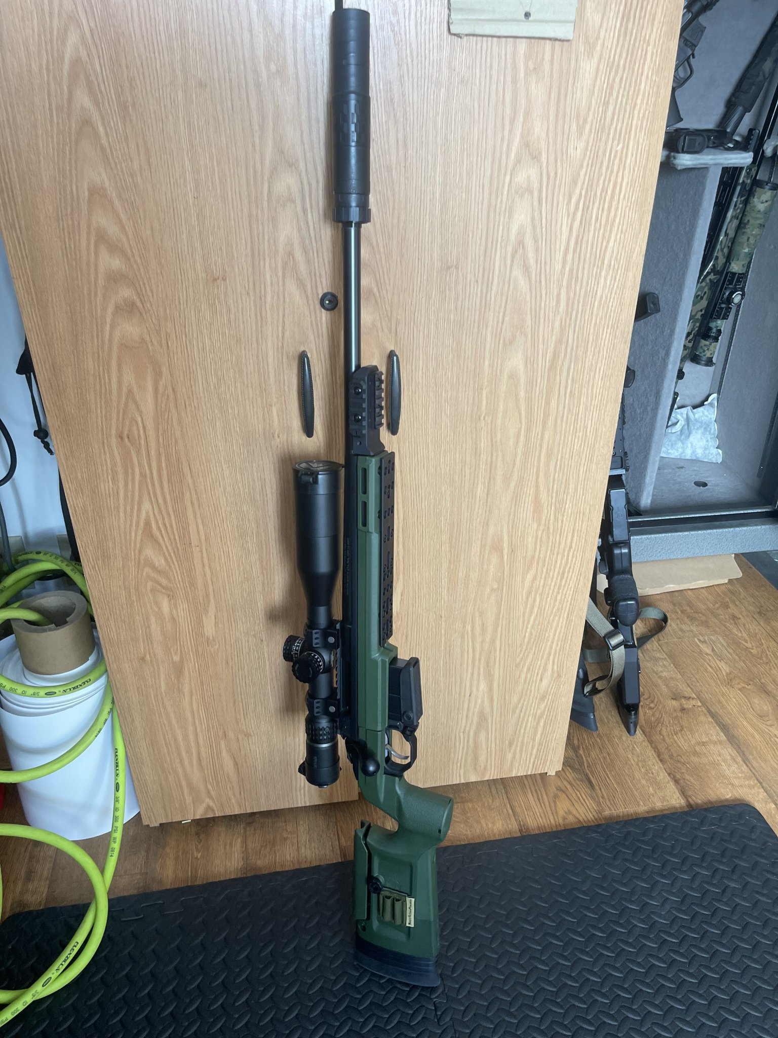

I own a CTR in 308 and it’s a great rifle. Mines setup as a backup hunting rifle for crop damage. I’ve also owned the 4-20 atacr. Nice optic but I wanted more magnification on the setup I had for my use

I did not replace mine above but it’s a inside 500 yard gun primarily and will never see 1000 yards in its lifetime.
