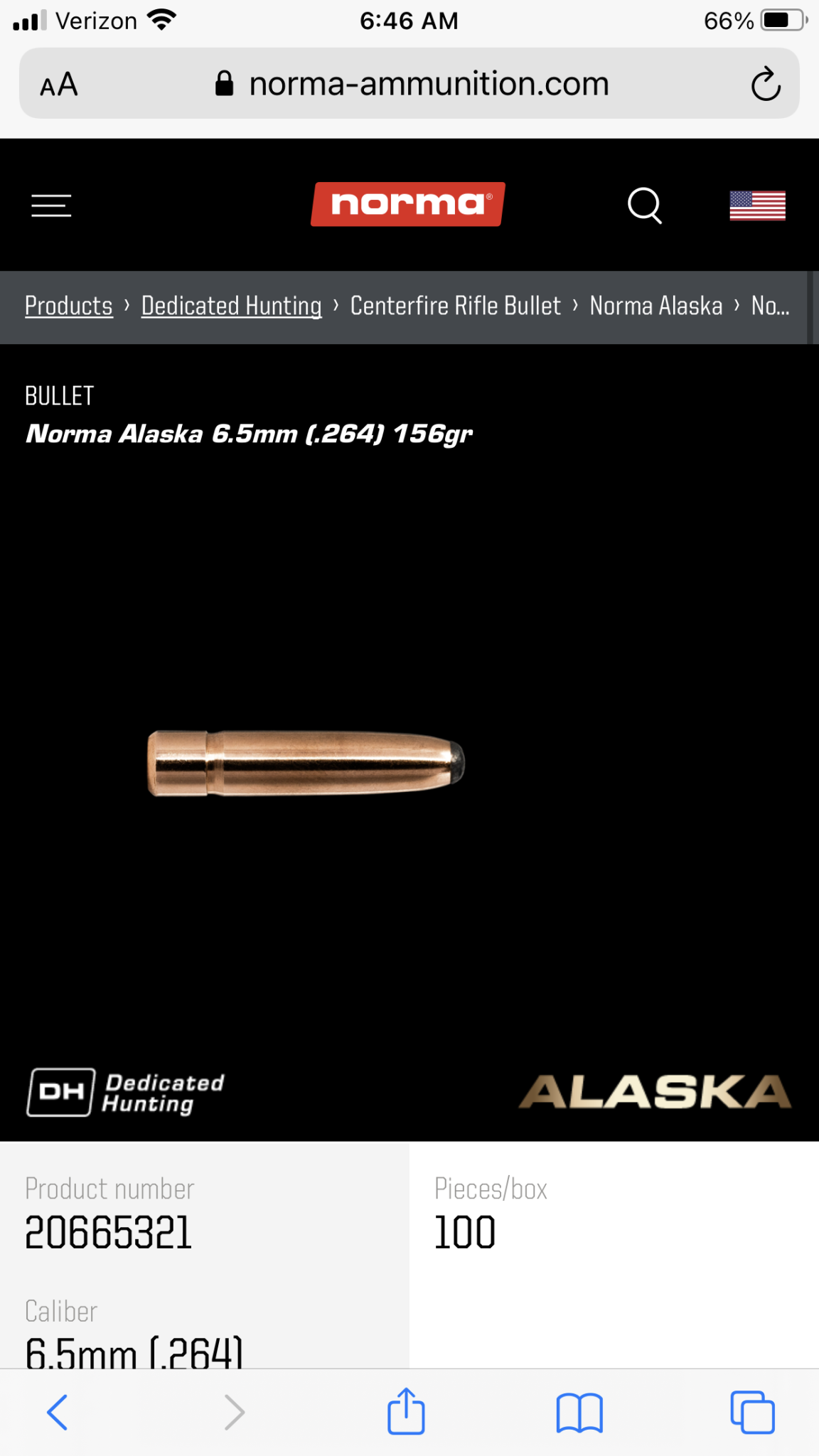

A 6.5 saum, 6.5x284 and 6.5x55 with this bullet would be my choice if I was limited to a 6.5
