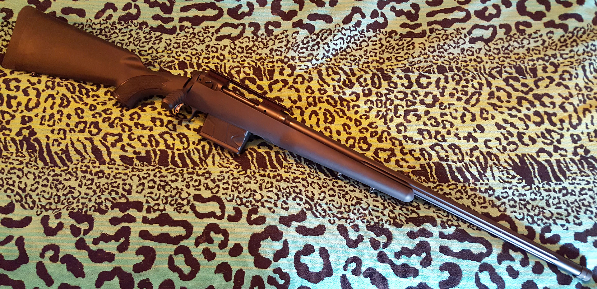

Bought a cheesy Savage 10 FCP-SR in 6.5 CM with a 24" fluted barrel. Started adding goodies/bolt on stuff as I figured it out - MDT LSS-XLGen2 chassis, Atlas Bipod, XLR Extreme buttstock, Ergo Suregrip, blah, blah, blah.
Base Rifle above and it shot sub MOA right out of the box with a $240 Vortex Crossfire scope. Then it went here:
With hand loads I'm still developing it'll shoot sub .5 MOA groups in the hands of an amateur. I have shot very expensive custom and built guns and they are *FaNtAsTiC!* but I have roughly 2K invested in this gun and even my nephew and brother who own guns costing 2X - 3X what this gun costs shoot my hot rod Savage *better* than they shoot their super duper rifles. I shoot their guns better than them but love my hot rod Savage.
Savage has limitations but my point is that I'd be hard pressed to recommend a person spend shit loads on a custom built gun before he has thousands of round under his belt downrange. start at the bottom and work up unless you are made of money and it is no object.

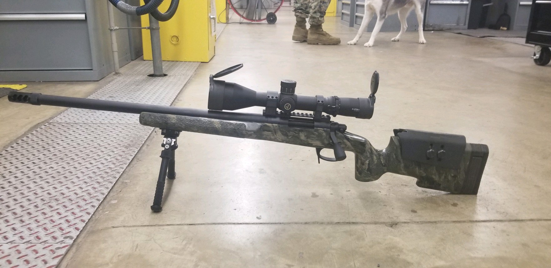

I feel like I’m talking to myself a few years ago. Our creds line up exactly from the USMC to the NFA stuff.
If I could talk to 2015 Eurodriver (assuming the options today were available then) I would’ve told him to buy a Seekins Havak Bravo in 6.5 Creed, topped it with a 4-16 ATACR bought used off this site, and bought 1,000 rounds of factory Hornady 140gr ELDM and just shot.
I have an MPA Switch lug competition and 5-25 ATACR and handload. I am saving maybe 3-5 in SDs and my groups are about the same out to 600 yards on paper between my Seekins and my MPA.
I would’ve saved a whole bunch of time, a whole bunch of money, and gotten a lot of practice in that I didn’t get to because I was too busy trying to find something “cool” and I was spending countless hours annealing and doing all sorts of other pointless shit.

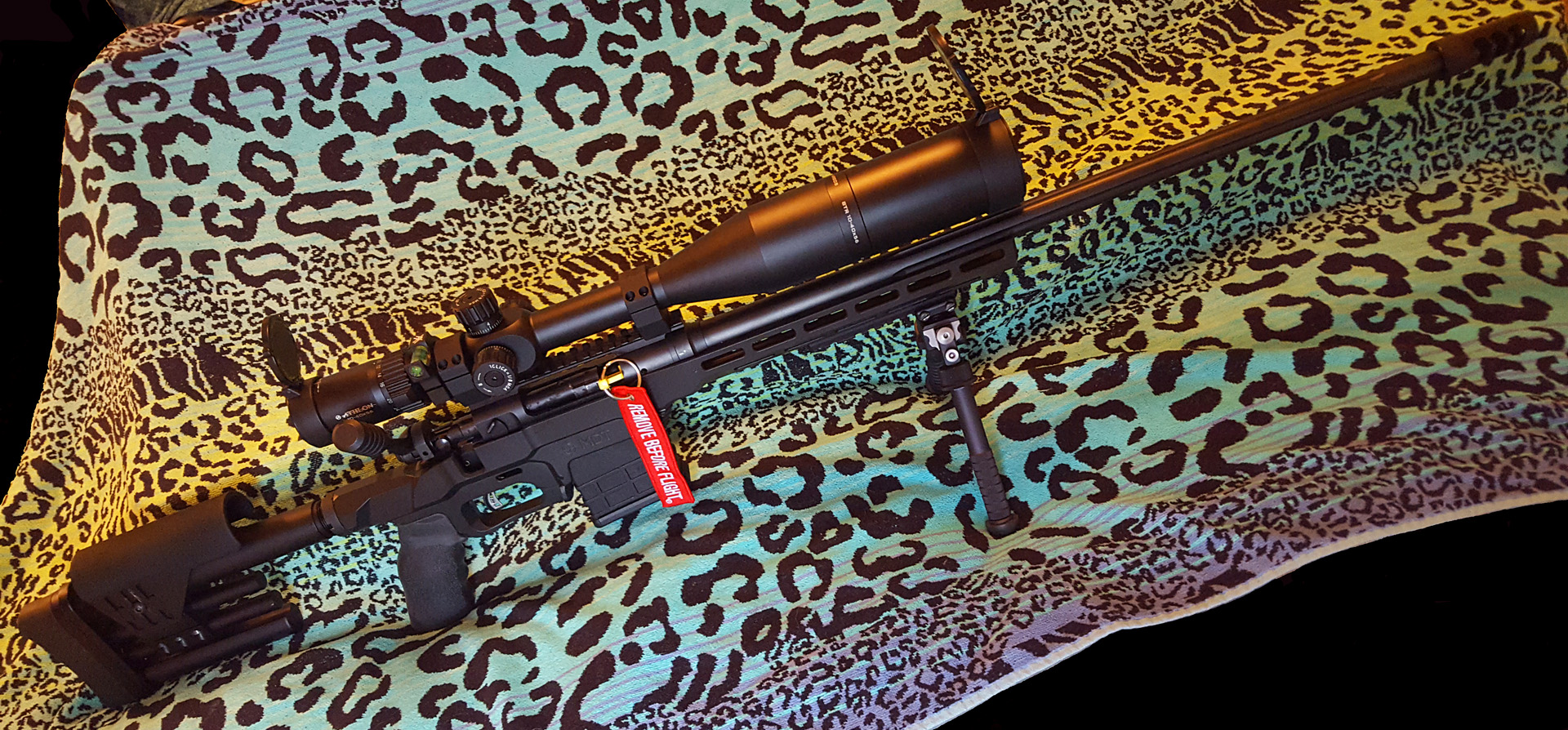

Here's my Savage 10 6.5CM in MDT's LSS-XLGen2 chassis with XLR Extreme Buttstock, Area 419 brake, Atlas Bipod, Vortex Precision Matched rings, Athlon Argos BTR 10-40X56 scope etc:
Worked up my preferred handloads this season/Summer and while I'm still getting fliers that *really* have me frustrated ('cause it's me not the gun) the rifle is capable of sub MOA all day.
I thought I'd start with this rifle and move along but when I burn this barrel out I'll re barrel it and keep going. If I was interested in resale or competing I might look elsewhere but for what I'm doing and the level I'm doing it at I am completely happy with my Savage. Never had an ejection problem but I'm running the MDT AICS magazine and I have never had an extraction issue and it's running stock springs/ejector.
