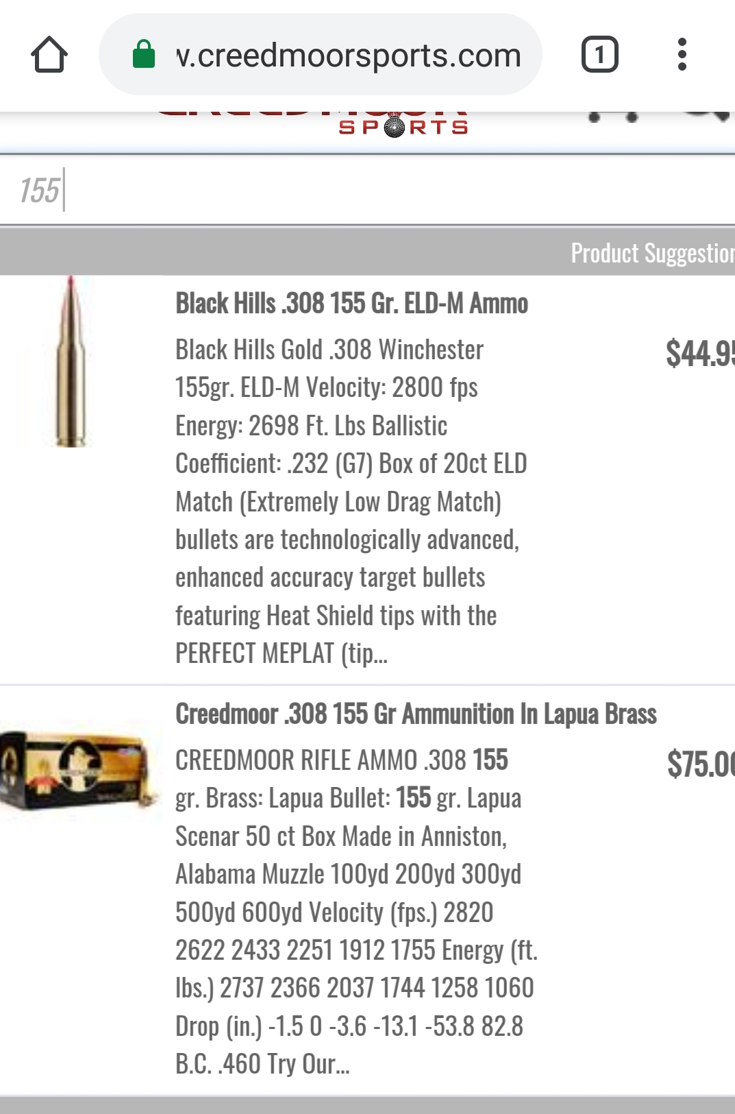

02 - Availability ... only source is HSM

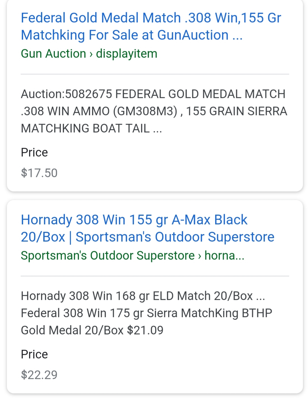

03 - Price .. buying in bulk will get the price down under $1.40 per round, close to $1.30 per round including shipping. The FGMM 7.62 175gr is $1.04 per round with shipping
04 - Erosion ... I presume the faster lighter cartridge will induce more erosion and reduce barrel life, but not sure how to measure that.
That said, if it passes 01, I will probably adopt the HSM 155gr load for one of my rifles, given the external ballistics numbers.
