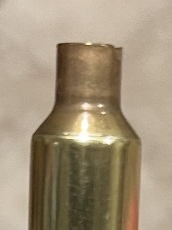

    Got the die and SAC .266 bushing (I got the .266 bc that's what redding bushing I've used).
    Screwed the die in, got it set for a .002 bump and noticed these lines under the shoulder. Wtf are they?
    They weren't there before the sizing.
    Ok

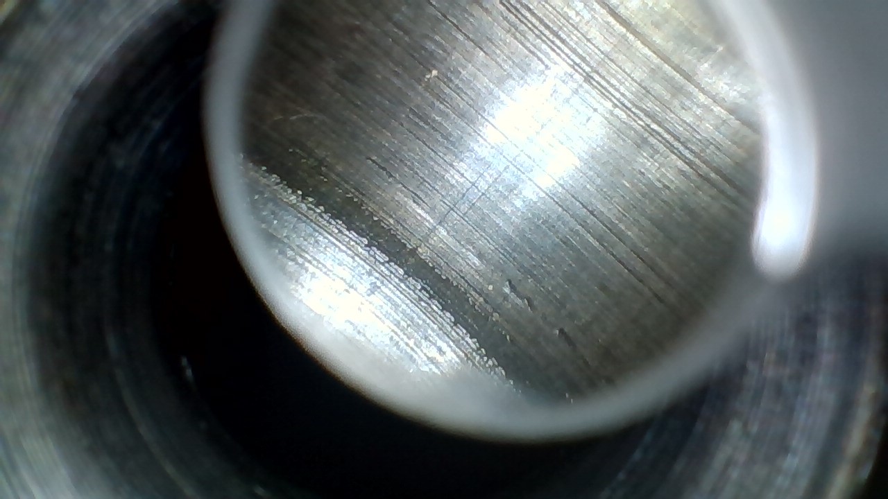

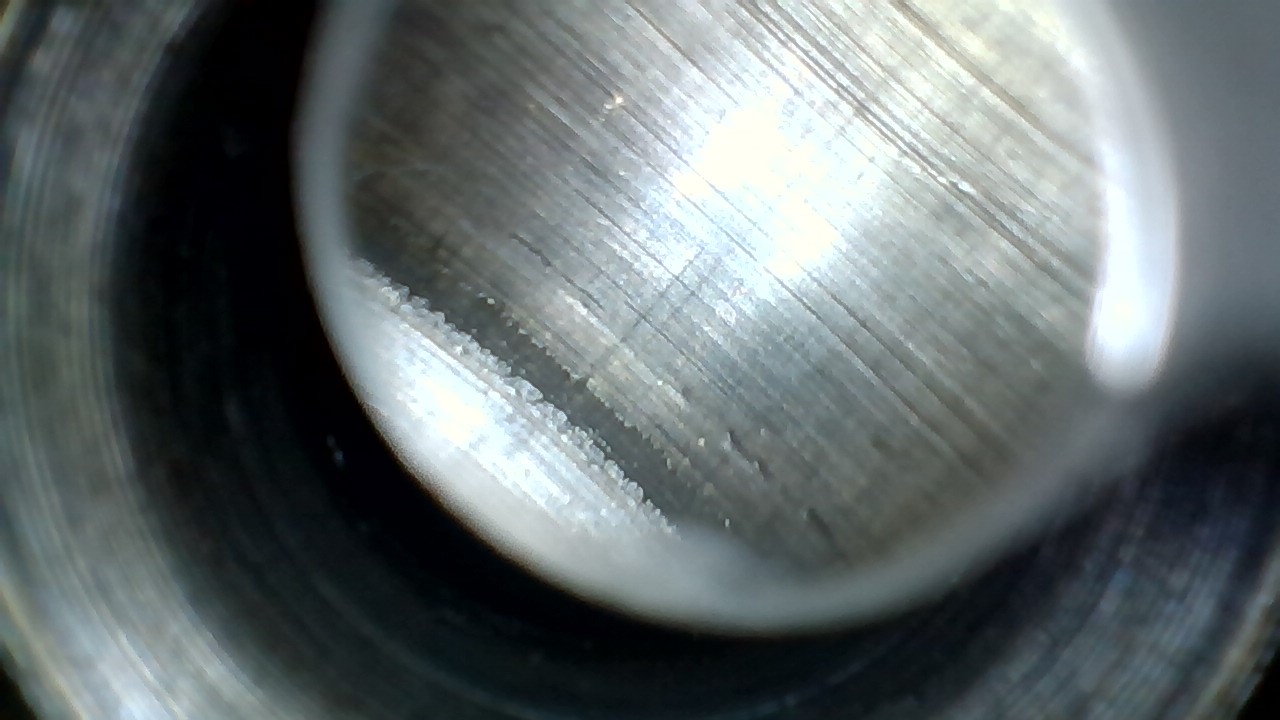

    Bore scope the interior of the die and let us know what it looks like.
    Reactions: BCX
    Here is a pic of the inside of the die near the area the brass has those lines. I just used my redding bushing on a couple pieces and the brass has the same lines.

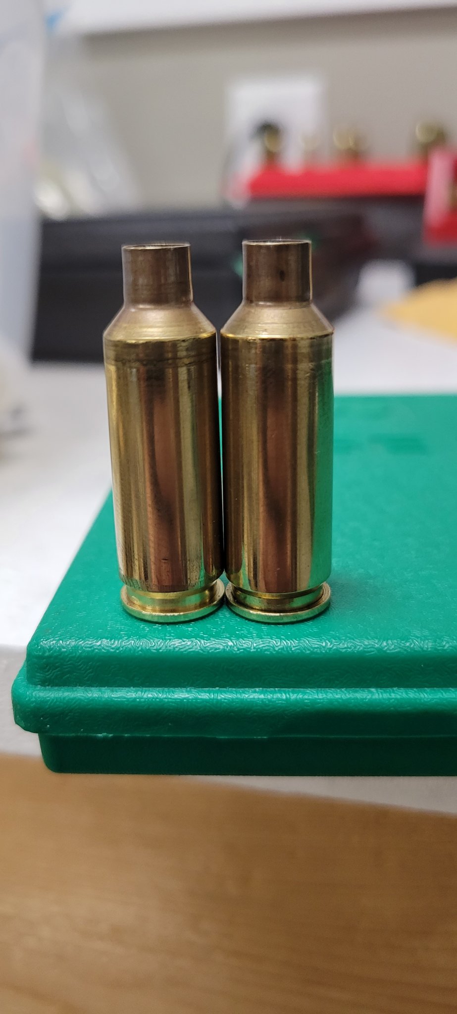

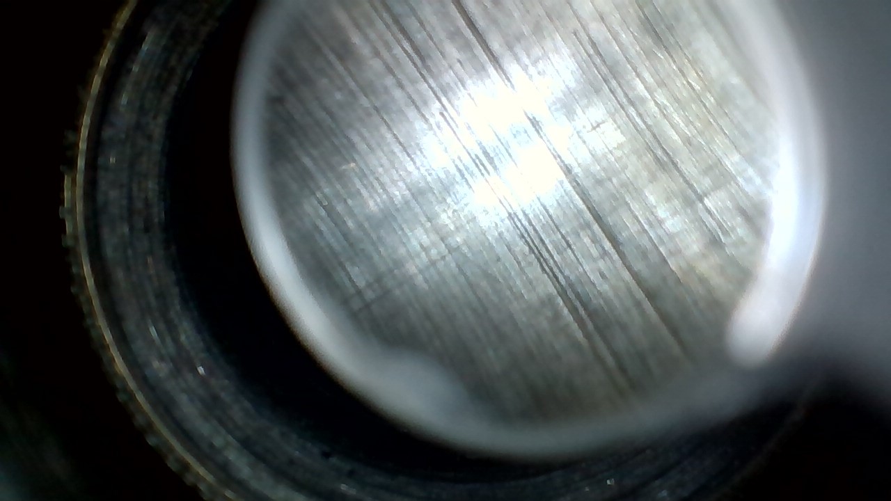

    Just in case someone cares to know ab whats up with the die. I called Bullet Central and spoke with a nice lady. I told her what was going on and she said Chris would be in contact with me within 24 hours. He called me yesterday and asked me to explain what was going on with the brass. I described what the brass looked like after sizing and he said "That definitely sounds like a defective die." He sent me one out late yesterday afternoon and will be sending me a return label for the defective die.
    Yeah I do and I'm glad you updated. Let us know what the new die looks like. If it was a Creed I'd have sent you one to get you by. If the new one is smooth and slick then I guess it's just a one off bad die. Even the best outfits kick out less than great sometimes, it's how it's handled that matters.
    I have all Redding dies and didn't have a quality control issue, but did have an issue and I was less than impressed with how they handled it.
    Reactions: BCX
    Chris said he honestly doesn't know how it was possible for the die to have that kind of tooling marks to cause this problem but he wants to look at it when he gets it back. They are taking care of it so I can't be but so mad. Im sure mine was a 1 off problem as I haven't heard of it before from their dies.
    I had a similar issue with a micron dasher die. They sent me a new one right away but it’s upsetting when they are all supposed to be hand inspected. Also had to return a 22gt die to them for same reason. When they get them right they are fantastic dies but they shouldn’t be letting hand inspected defects out the door.
