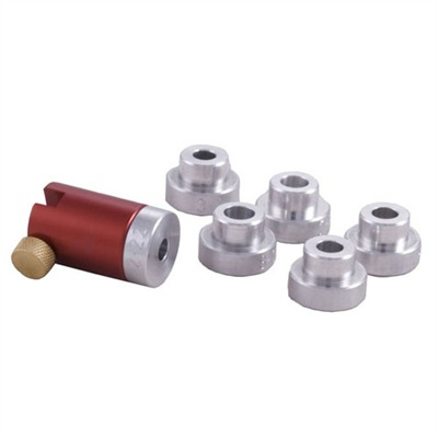

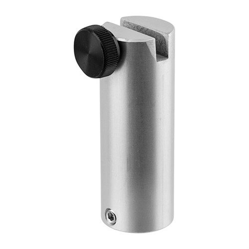

Your title is asking for "Bullet Comparator" explanation, but you're referring to "Case Headspace Comparator" in your post.
Hornady has both Headspace Comparator for measuring off the Datum to gauge how far you are setting shoulder back
7117822
And a Bullet Comparator to measure off the Ogive to give you your CBTO.
7117823
If you're loading long Bullets you may very well find the extended Comparator Body to be of use. Sinclair makes one.
7117827
Some VLD Bullets will bottom out on the Meplat in the shorter Comparator Body.

Yes. It sounds like I want/need a Headspace gage for measuring the datum to determine bump; and I want the bullet comparator for measuring cartridge length from head to Ogive. Also, if I want to sort bullets by bearing surface I need a second bullet comparator.
Look at what I posted for you. One set of gauges is for measuring cases off the Datum, the other comparator is for measuring Bullets off the Ogive. Sinclair and Hornady, basically same same. That doesn't matter. What matters is understanding there are seperate comaparators. One for Cases, One for Bullets.
Go back to @1J04’s post and take a minute to read and understand what all is there.
Okay, now. Notice that there is a comparator body and there are inserts for that competitor body. Together they make up a comparator. For either rough base too give comparisons and for relative headspace comparisons.
Got it? They compare one measurement on a loaded round to the same measurement point on the next, based on your developed load measurements.
As to which brand is better, if that’s really what you are asking, choose one and don’t look back.

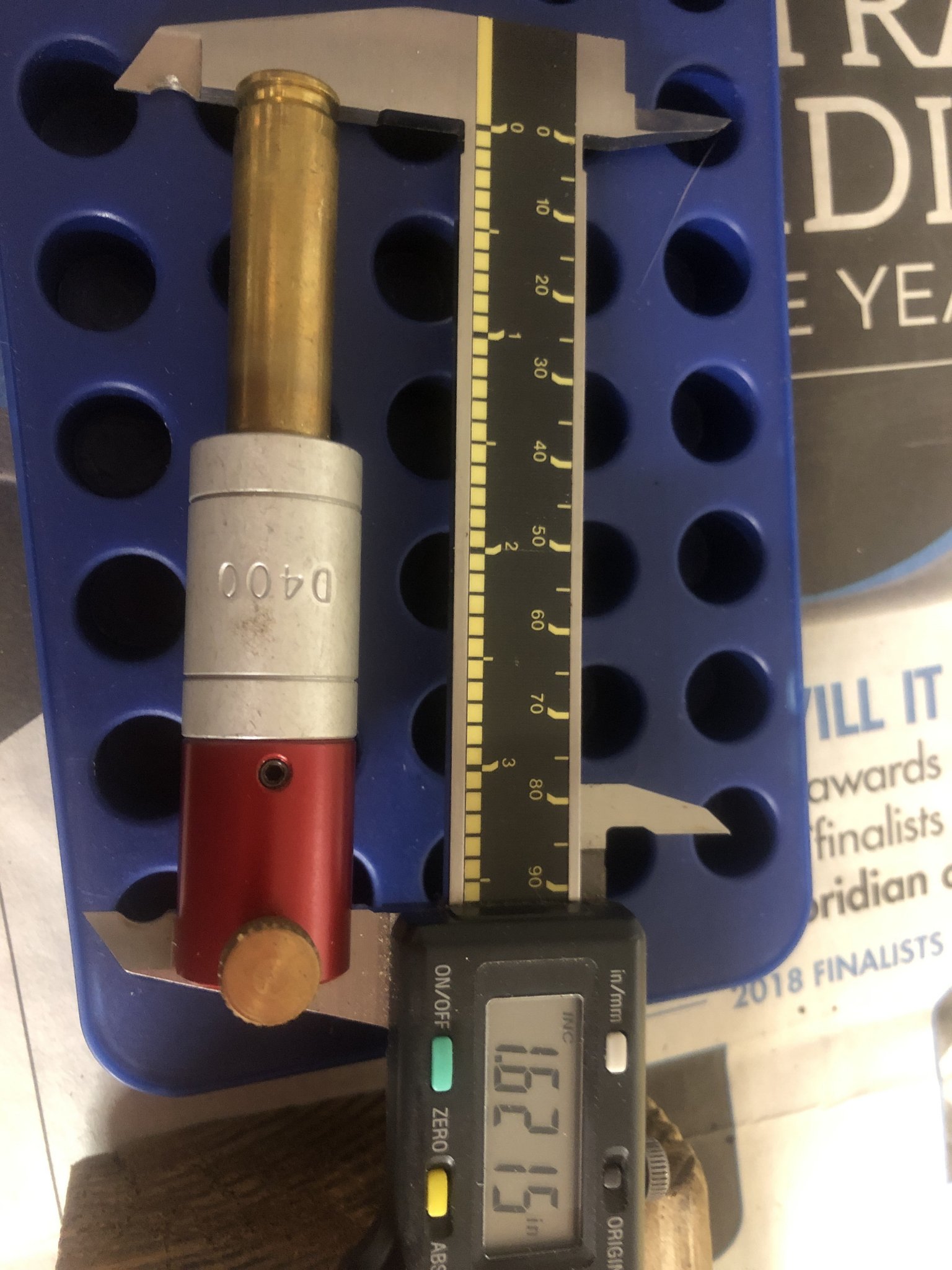

Make sure you compare the datum line on your modified case vs a fired/unsized case from your rifle.
Many times they don't match up and since the modded case works off the shoulder but is measured total length, they can give false results.
That doesn't mean they are junk, quite the contrary. You just have to know the limitation of the tool or make your own modded case from your fired cases.
Reactions: 1J04
Yes. Need to measure datum on 5 or 10 fired cases to get an average. Then measure OAL from Ogive because meplats can vary quite a bit while the Ogive is very consistant. Got my Press mounted last night. Will be ordering supplies soon. Off to read more load development threads and start loading to magazine length.

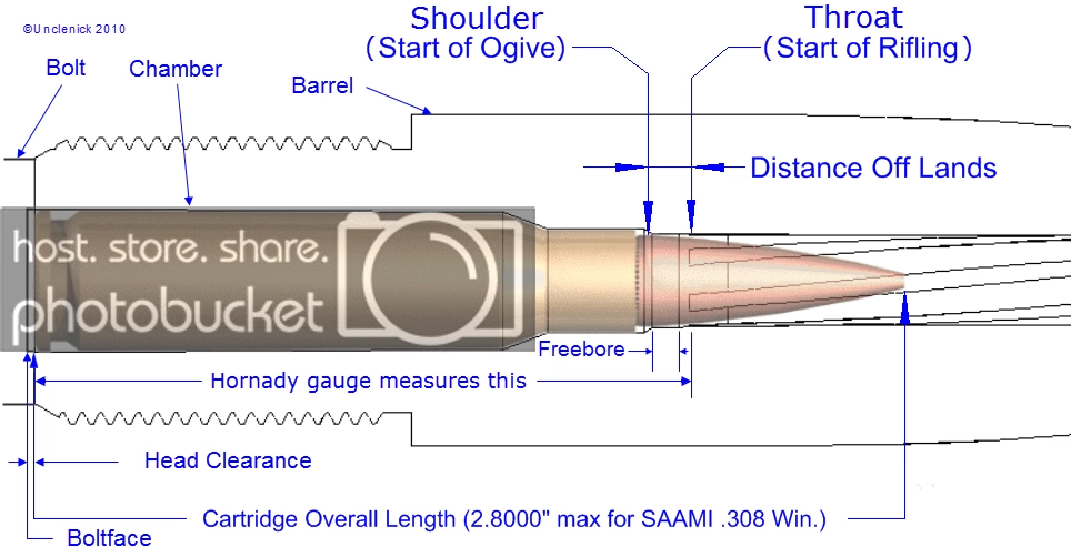

Alright guys, going to feel a little stupid on this one but at this point I really don't give a shit and would just like to know. Been reloading for a few years now, and often use my Hornady Bullet Comparator to give me 0.000-0.020" (often 0.010") jump depending on what shoots best for that particular bullet. I know how to use the tool and can get consistent case base to ogive reloads which allows me to play with seating depth.
Problem is, I'm still not sure I understand how the comparator is actually working. My understanding is the ogive is where the tangental/secant curve meets the bearing surface and is the point that the comparator measures. However, I don't see how the compartor is able to stop on a specific point which happens to also be the maximum diameter of the bullet (intersection of bearing surface and curve). Is the comparator actually cut to a opening a few thousandths of an inch smaller than the ogive? Which means you're actually measuring everything somewhat relative to the true ogive? Or am I misunderstanding what the ogive truly is and is often represented as?
Thanks for any feedback, it's appreciated. Any feedback using crayon drawings your kids made for me to figure it out is even better.

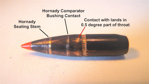

Easy to throw your calipers on and see for yourself. Spin them on the bullet and youll see the exact point it hits with your equipment and components.
The "true" ogive is the entire curvature of the bullets nose. The ogive we use for reloading is just where our datum (the comparator) interacts with the bullet down towards the bearing surface, its semi slang. You are correct that its a tad smaller.
This shows a datum (plane) on a case shoulder instead of a bullet but same principle
7118108

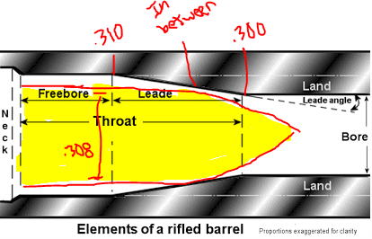

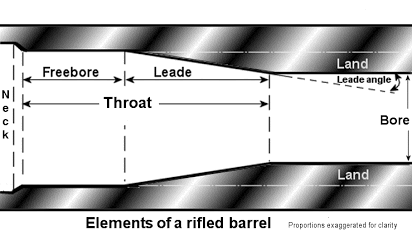

A bullet is .308"
Your hornady comparator is a .30 hole. But your hole also has a chamfer on the inside edge making it slightly wider for somewhere between .30 and .308 which is actually where your 308 bullet hits on the leade betwen the wide throat and the narrow bore. The chamfer gets it pretty close to the leade in your rifle/where the freebore transitions to the full profile lands.
7118103
7118098
7118100
7118104
A bullet is .308"
