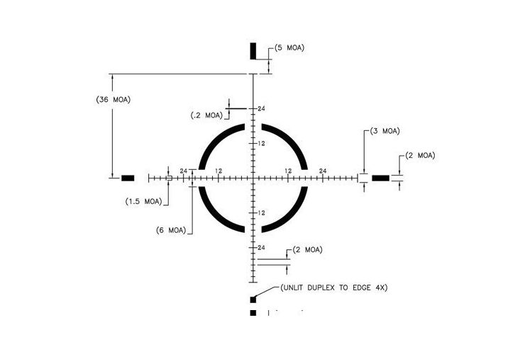

quik question..... My scope turrets are 1/4 MOA adjustments. I have the scope zero'd at 100 yards, at 200 yards, I am dialing 2moa(8 clicks) on the scope for a direct hit. I even did a hold over on the rest and the hold over is at the first hash mark right below the center of the cross hairs. Picture of reticle included.
The scope is a US Optics ST-10 with erek knob(1/4 moa) and it has a JNG MOA retical.
Giving that information, would you say I my bullet drop at 200 yards is 4 inches?

My advice would be to stop thinking in inches, clicks or worrying about bullet drop. And just dial your dope. Get out to the range and confirm what you are supposed to dial to get your bullet out of your rifle to varying ranges. And right it down.
MOA is NOT inches, it is a angular unit of measure.

if you can PM me the ammo your using, bullet manufacture / type and GRN weight, see if the box has a muzzle feet per second FPS on the side, & scope sight height (measure in inches from firing pin to the middle of your scope), then I'll get you a balsitics chart. Takes all of two seconds to run it.
