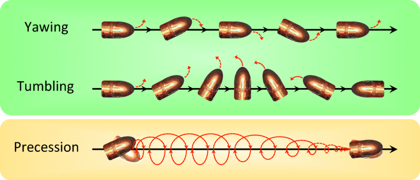

    gyroscopic stability, its just a lil physics
    A musket ball which is a sphere where the center of pressure is its center of gravity, cant tumble. Its perfectly stable. Its just not very aerodynamic.
    For better aerodynamics you need to make it pointy and to get more mass in a given caliber its got to get longer.
    If somethings long enough that its center of pressure isnt on its center of gravity a little drag or uneven distribution of mass etc will cause it to go tumbling and fall out one way. To counter the fall you can spin it fast enough so that as its falling it spins around so quickly that it falls into its own path and self rights
