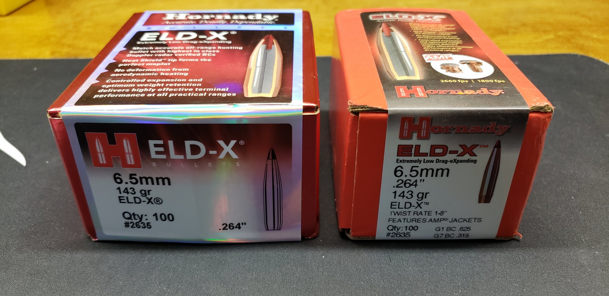

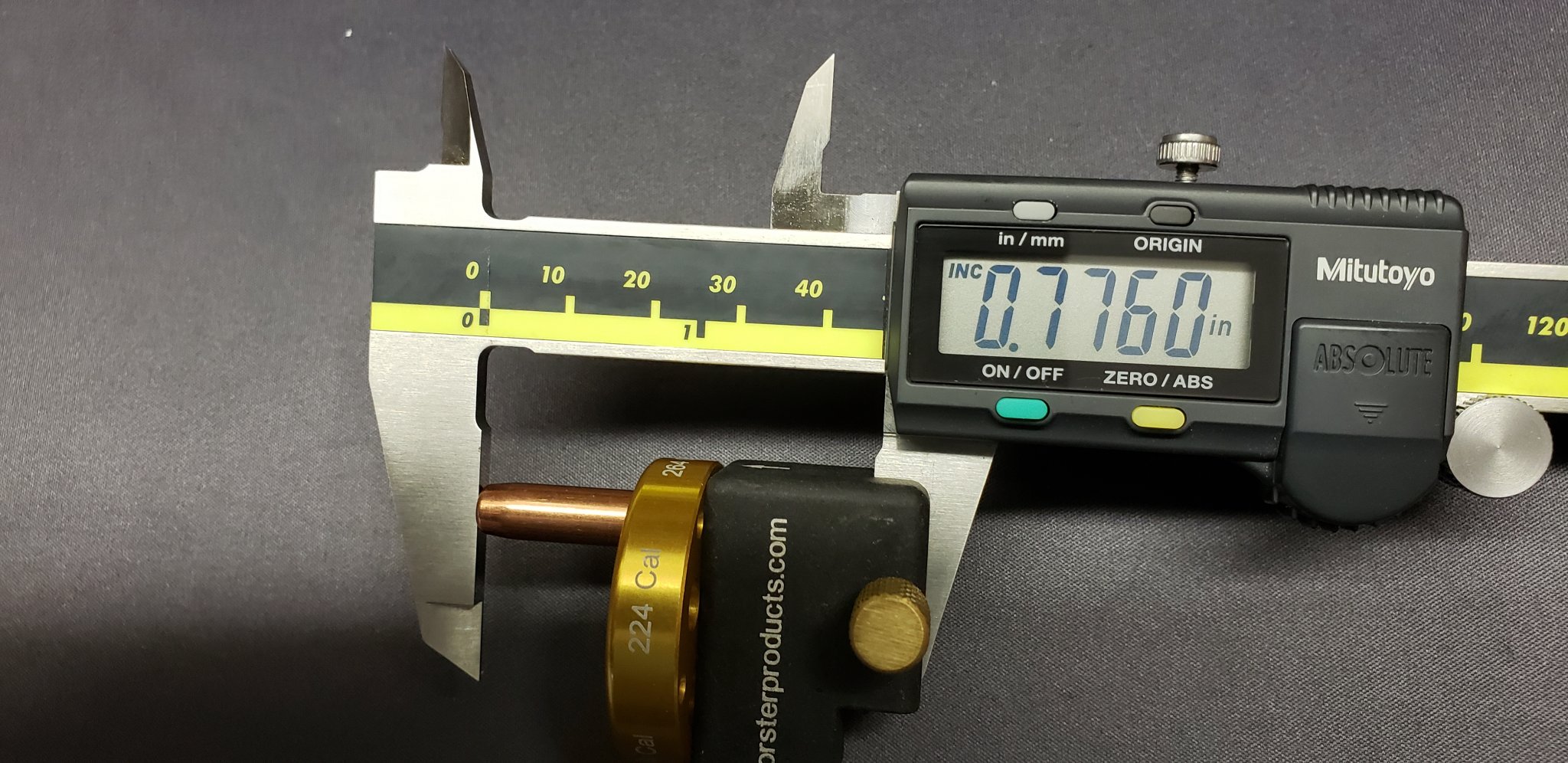

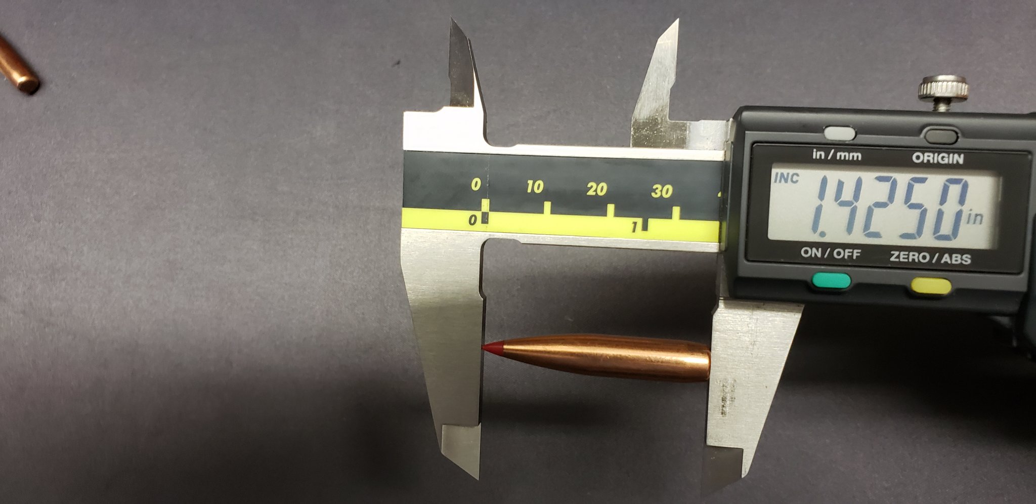

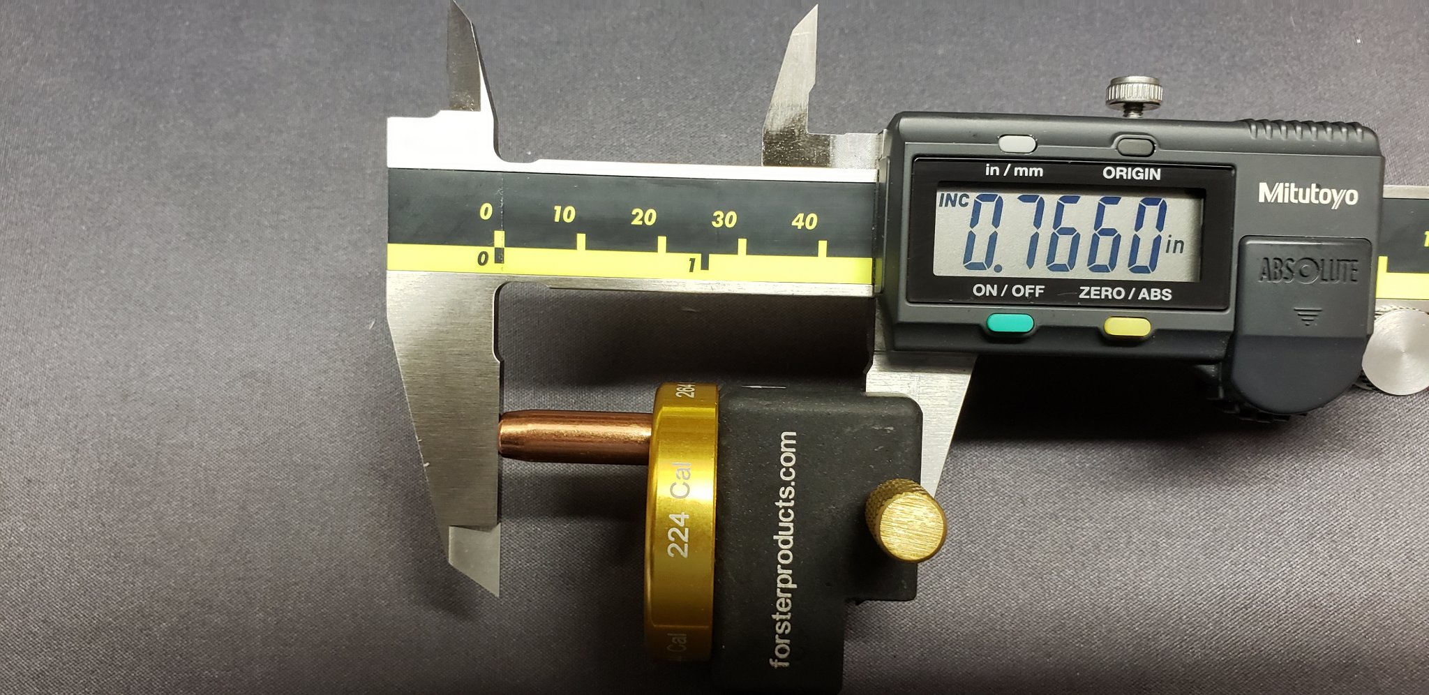

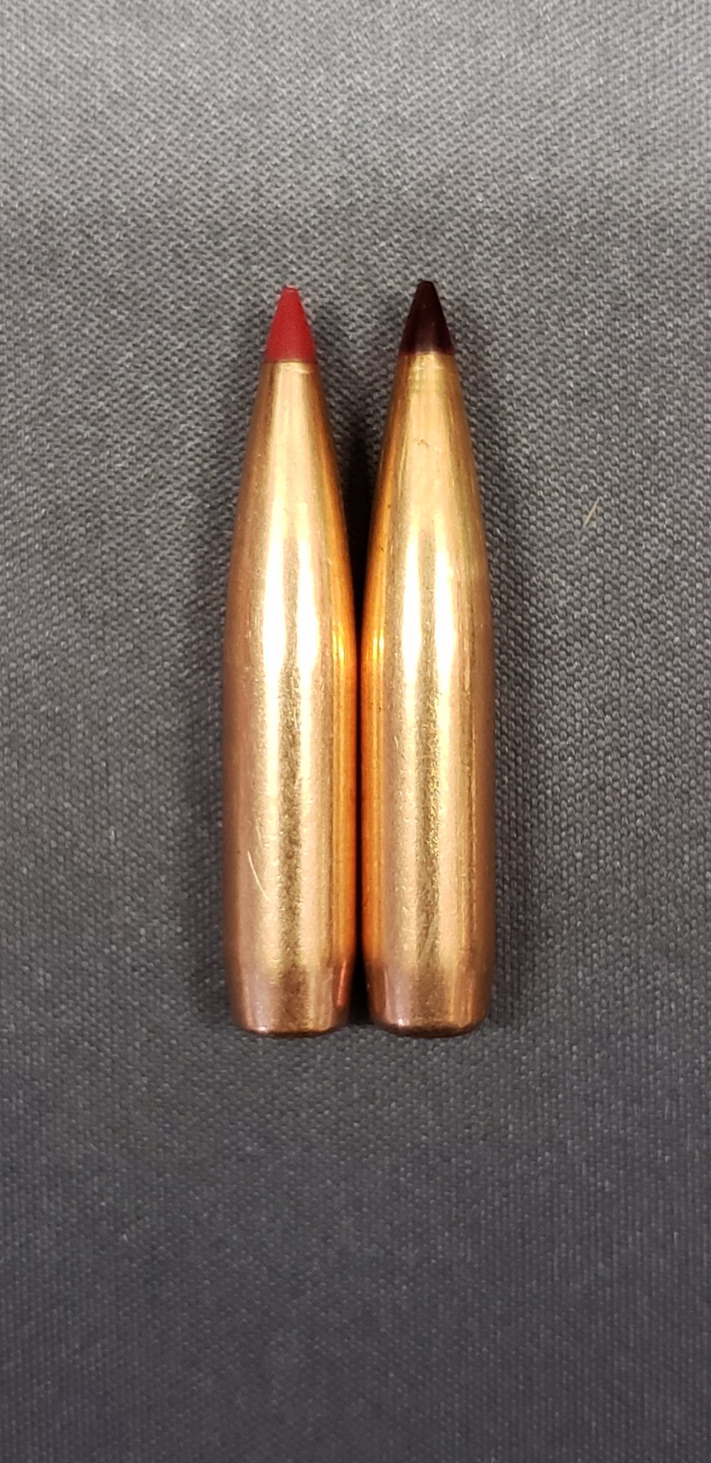

Hornady on the other hand.... I recently opened a box of 147 ELDm's from a different lot and ho-lee-schitt. Bullet BTO was 0.012 longer and OAL was 0.010 shorter. That will definitely throw off a BC and seating depth!

I'll say! Gotta watch out with Hornady. I sure do love em, but definitely buy in bulk when doing so. Here's two completely different lots of 143 ELD-X bullets. Different length, different ogive, different tip, different box. They both shoot great though ??‍♂️ (I accounted for the seating depth change).
