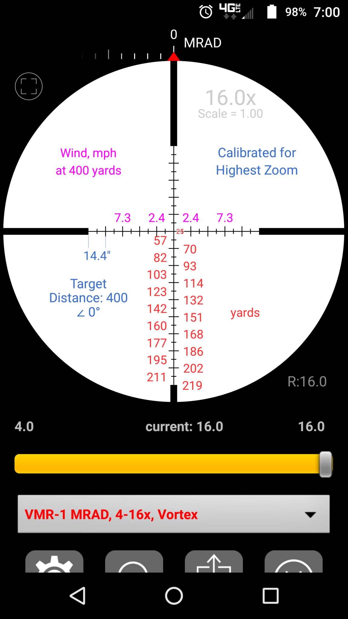

The Viper HS-t is a second focal plane scope are you shooting on 8x or 4x and holding over? if so then the drop is probably correct as the value for each hash mark changes as you power down.
Reactions: Alan101
Hang tall target, shoot it at 100 and 300 with the crosshairs. Measure your drop.
Take the retical out of the equation. Now it's much harder to screw up.
Here's my HS-T (on a .22lr so drops are wildly fast). Notice the magnification vs yardage. Yardage gets tighter as mag drops.
