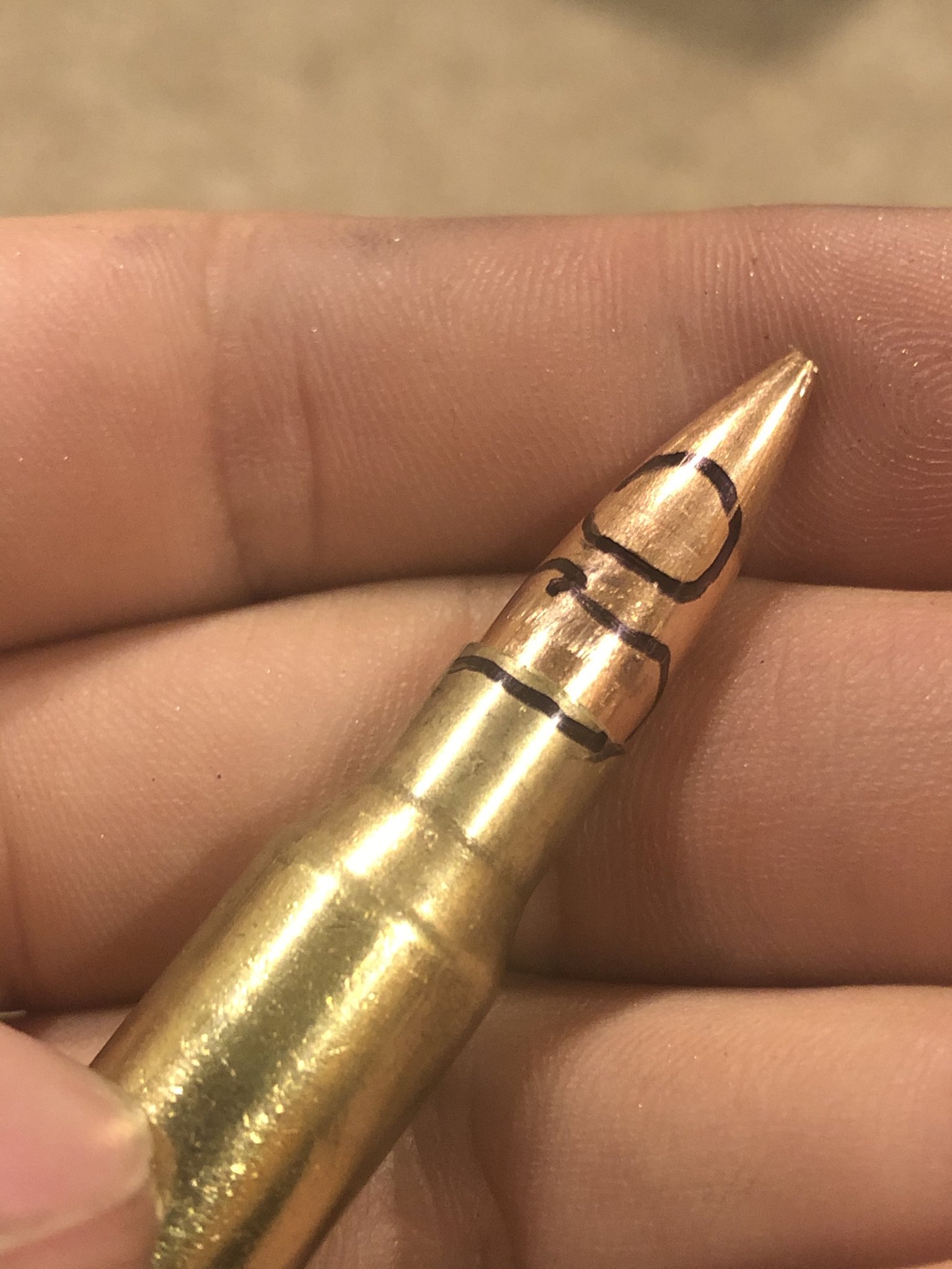

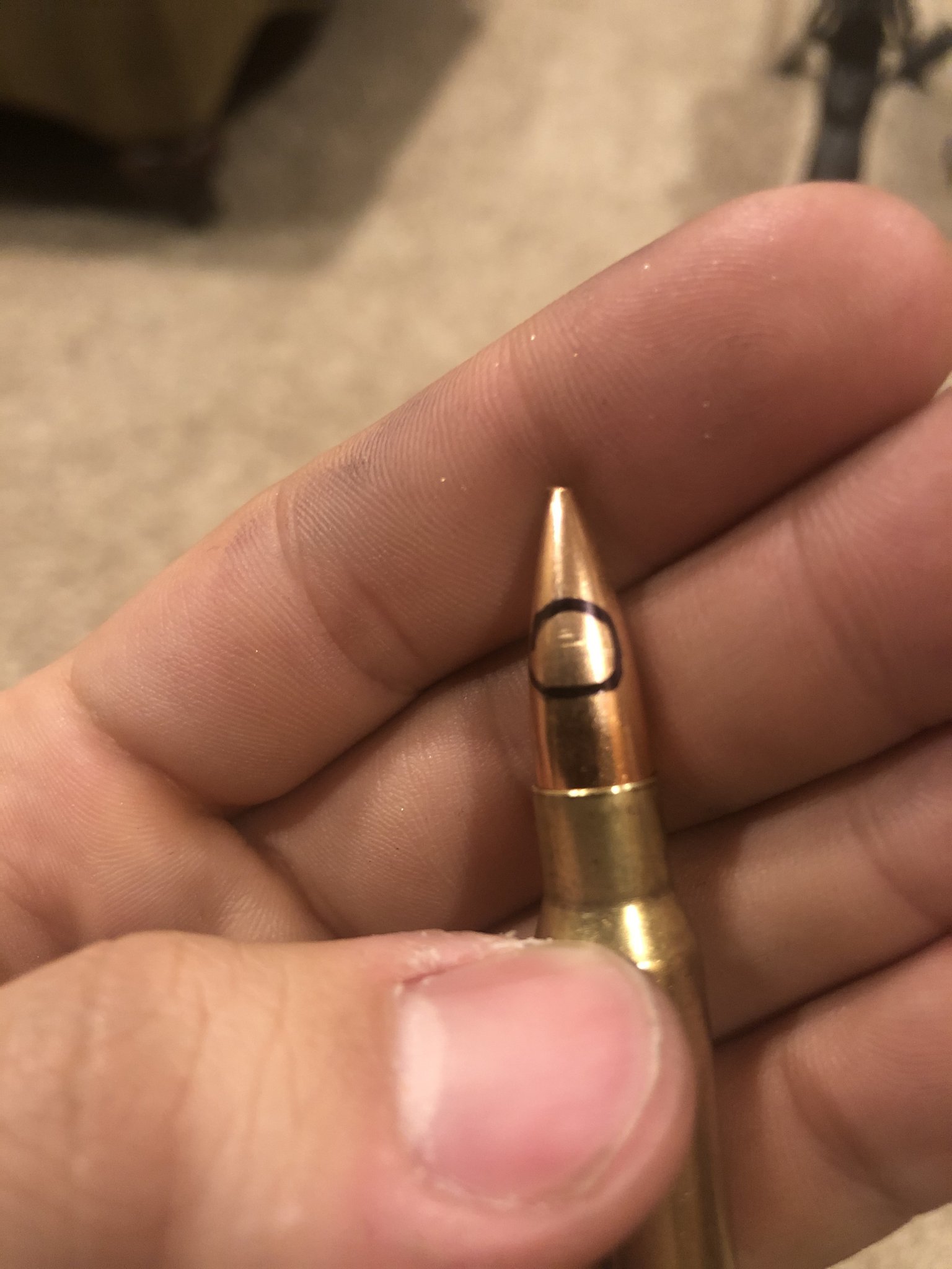

Hey all. I’m new to reloading so this may be a no brained but I noticed some scratch marks on some bullets that had been chambered in my rifle. On closer inspection, there’s a ring where I’m guessing the seating die pushed on the bullet, some bullets have subtle scratch marks on one side. Those bullets then have larger scratches further down after they’ve been chambered. Is the bullet being seated off center / tilted? Is this a problem with the seating die or does the bullet need to be held straight all the way into the die? Thanks for any help
(Had a hard time getting photos of the problem but it’s very noticeable in person)

The rings are from the seater plug. You can polish the inside of it with one of the bullets you're going to be using to help it fit better, or just ignore it. I've not really noticed my accuracy diminish because of it, but I don't normally run a very compressed load, so I don't get rings very bad. If you're running a compressed load, it will make the ring worse. As far as the scratches, I get those if I throw it in the chamber to make sure it chambers as well, also wouldn't worry a lot about it. I suppose you could polish out the chamber of the rifle to see if that stops or lessens he scratches, but unless it cuts through the jacket, I wouldn't lose sleep over it.

The marks are common complaint. If you are shooting similar bullets, then hone the seating stem to mate smoother with the bullet.
Mount a bullet in a vise or something that will hold it steady. Remove the seating stem from the die, and clean well. Apply Flitz or a valve seating paste to the inside surfaces of the stem and mount in a drill. At slower speed, push the stem onto the bullet and rotate slowly. You will notice the seating surface will become smoother and bright. Apply more Flitz and continue until the surface is similar to the conical shape of the bullet. It may take several bullets, depending on the quality of the metal the stem is made of. After finished and stem is smooth, completely clean the stem with brake cleaner to remove any residue of the Flitz. Pay particular attention to the top of the opening of the stem as the Flitz will collect there and will get quite hard. After fully cleaned, lubricate well with oil and reinstall in the die. This should solve your problem.
Some die manufacturers produce a VLD/ELD seating stem with higher slope to match the bullets. These are usually around $10-15 and are worth the investment. Redding, Whidden and Forester are ones I know offer this.
