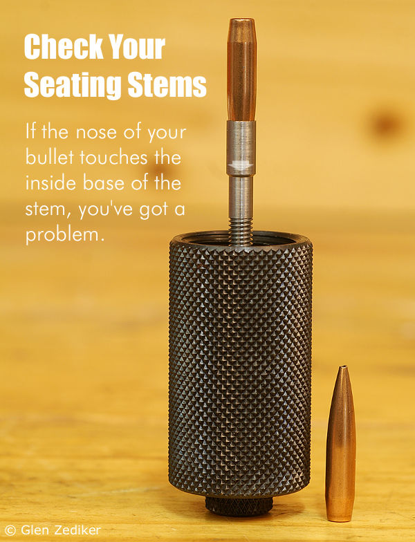

The tip bottoming out before the ogive is in contact can cause these issues as well.

You might see it, you might not. You might be seeing it and not realizing. You can unscrew the seater dies in half and check it without losing the setting so long as you don’t mess with the micrometer.

Just checked right now. How can I tell if it's bottoming out? I don't think it is. When resting in the seater, it can wobble back and forth pretty easily

Drill a little deeper into the seating neck to ensure the bullet tip is not touching. Had the same problem with the new .257 131 BJ ACE on a standard 25-06 seating die. I don't remember the exact drill bit other than it was about 3mm. I also chamfered the ID using a bullet and 600 grit paper to eliminate leaving a ring on the bullet. Doesn't take much to chamfer enough. Just a few times to take the edge off. I was too cheap to purchase a VLD stem.
I don't think it's touching, but that's good to know how to do it.
First of all 25 thou difference in ogive measurements on the bullets is crap. And with your explanation it sounds like the tip is hitting in your seating stem before the ogive is making contact.
I don't think it's hitting, although I may be wrong.
