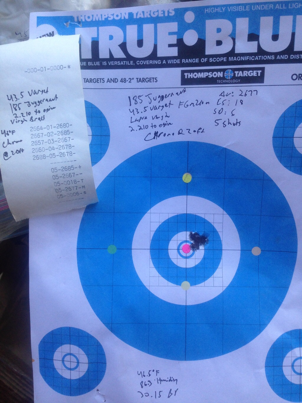

You’ll be fine running the 185 juggernauts. I shoot them out of a 20” 1:12 and a 28” 1:11.25. Both guns are .308. The good thing about the juggernauts is that they are very jump tolerant. My load for my 28 inch barrel is 43.8 Varget at 2.865” in Lapua brass.
My load with my 20” is 44 grains at 2.880”. Lapua brass. They shoot so good that I don’t think I really need to shoot anything else to get better accuracy. I’m taking my 20” .308 out to 1200 yards and they flew fine
I , too , shoot a Gen 1 5R, 308. My most consistent handholds have been with the 175 Nosler custom comps. That being said, I have experimented with the 185 Juggs. I've not found loads so far as good as the 175's, but I'm still working on it. But, looking at Mr. Aimsmall55's target, it definitely seems possible to shoot them well!!!!!! Good Luck on your ventures, & if you do have some luck, let us know!!!!!!
