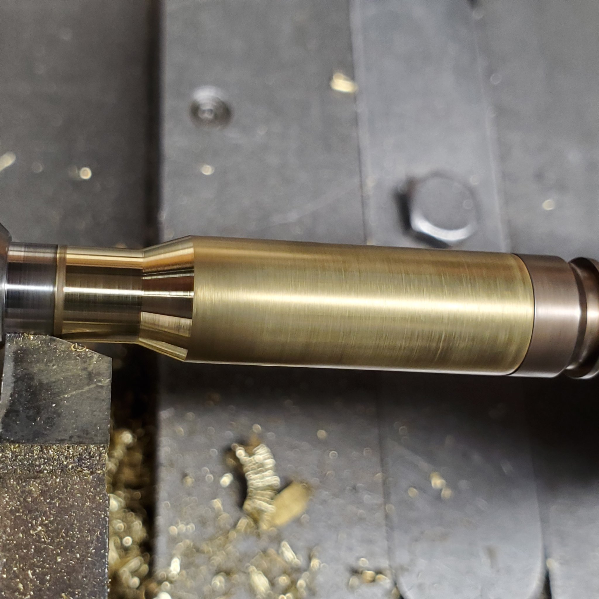

I neck turn and cut shoulder sometimes, 100% especially when case forming from another caliber. Grind the carbide cutting tool to the case shoulder angle, with a sharper radius at the neck shoulder intersection.
Then turn in lathe, after mandrel up. To get rid of donuts.
