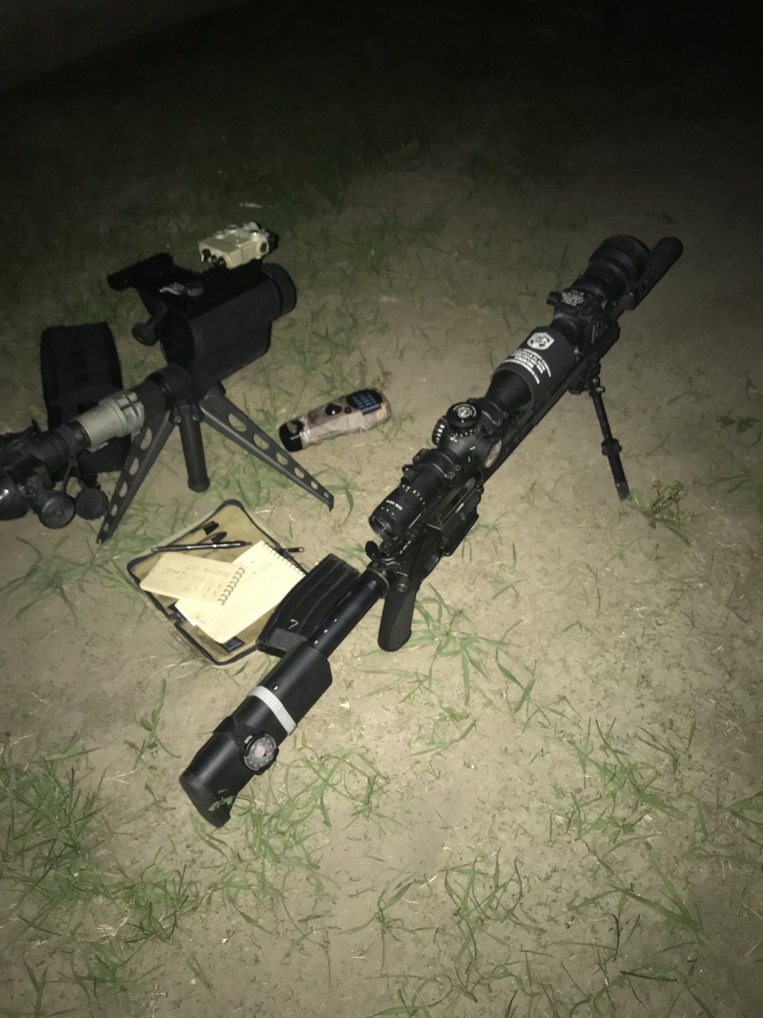

Is it possible to see bullet trace under night vision? The only time I believe I’ve seen it is with a PVS7 behind a MK4 spotting scope with a full power illuminator. It’s was a black path that matched exactly what the bullet was doing in the day time.

After talking with a friend, using the ir illuminator on my dbal mounted to the spotter is was gave me the ability to see the trace due to the added light spectrum. He explained that with just the 7’s behind the spotting scope or threw the PVS30 I would not have been able to. I did put the black dbal from the rifle on the spotter because it is a high power illuminator.
