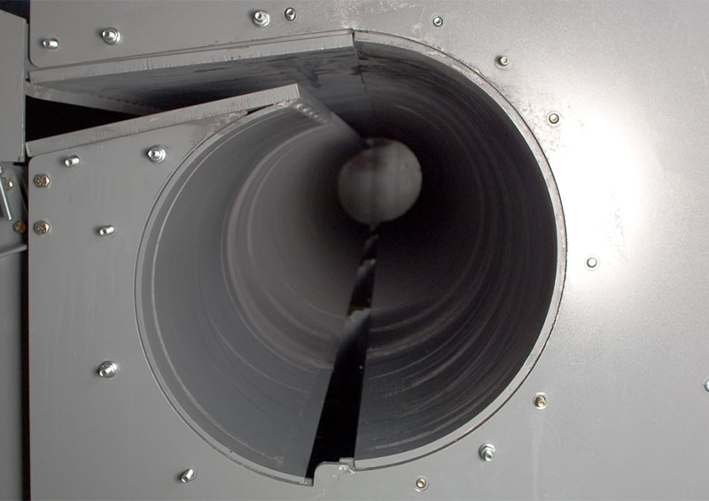

I was a gunners mate in the service and we replaced a dirt berm with a bullet trap. It was two plates at extreme degrees to funnel the projectiles into the gap at the end and it was exactly like the picture earlier in this thread. The impact onto the AR500 plates made the bullet either shatter or deform, when the round got to the round part it just spun around until it lost enough speed to drop into the gap and was collected in 5 gallons metal buckets. If you had a sheet of AR500 you could weld one up pretty quickly. A friend back in NC did just that and made it about three feet at each opening part of the trap. He didnt use AR tube, but used a piece of heavy schedule pipe he got from a Texas oil driller he knew. So it looked like a big pyramid on its side…he used it at his farm for exactly the same reason. But he had all the steel from his business…he builds shoot houses for the military and police departments out of special concrete that absorbs projectile and shrapnel.
How extreme of an angle and how close could you shoot your standard SA calibers? I've been thinking it'd be handy to gather some chrono data without driving to a 100 yard range.
We used to start out at 3 yards and back up from there..(with pistols. M16s only Got to 15 yds or out to 25)so right up on the entrance to the bullet trap(pistols). I think the plates were at 30°…even up that close the rounds would be shot down thru the paper target and strike the lower plate, ricochet up into the snail or sometimes up to the top plate and then into the snail.
