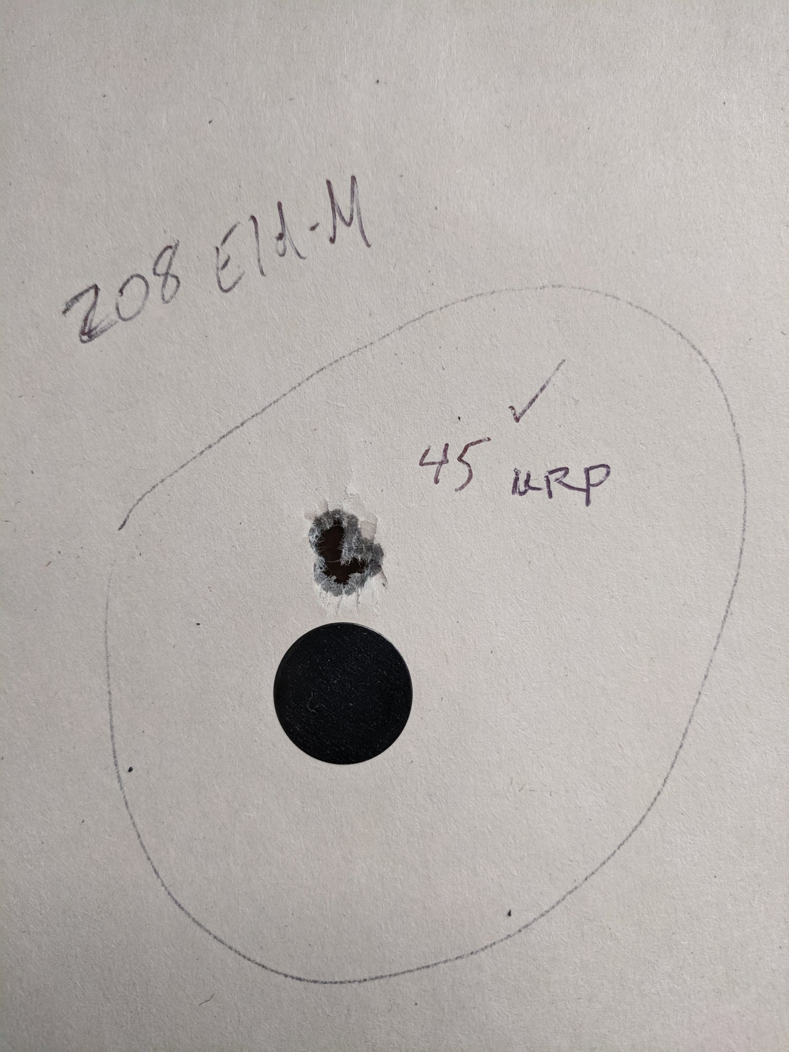

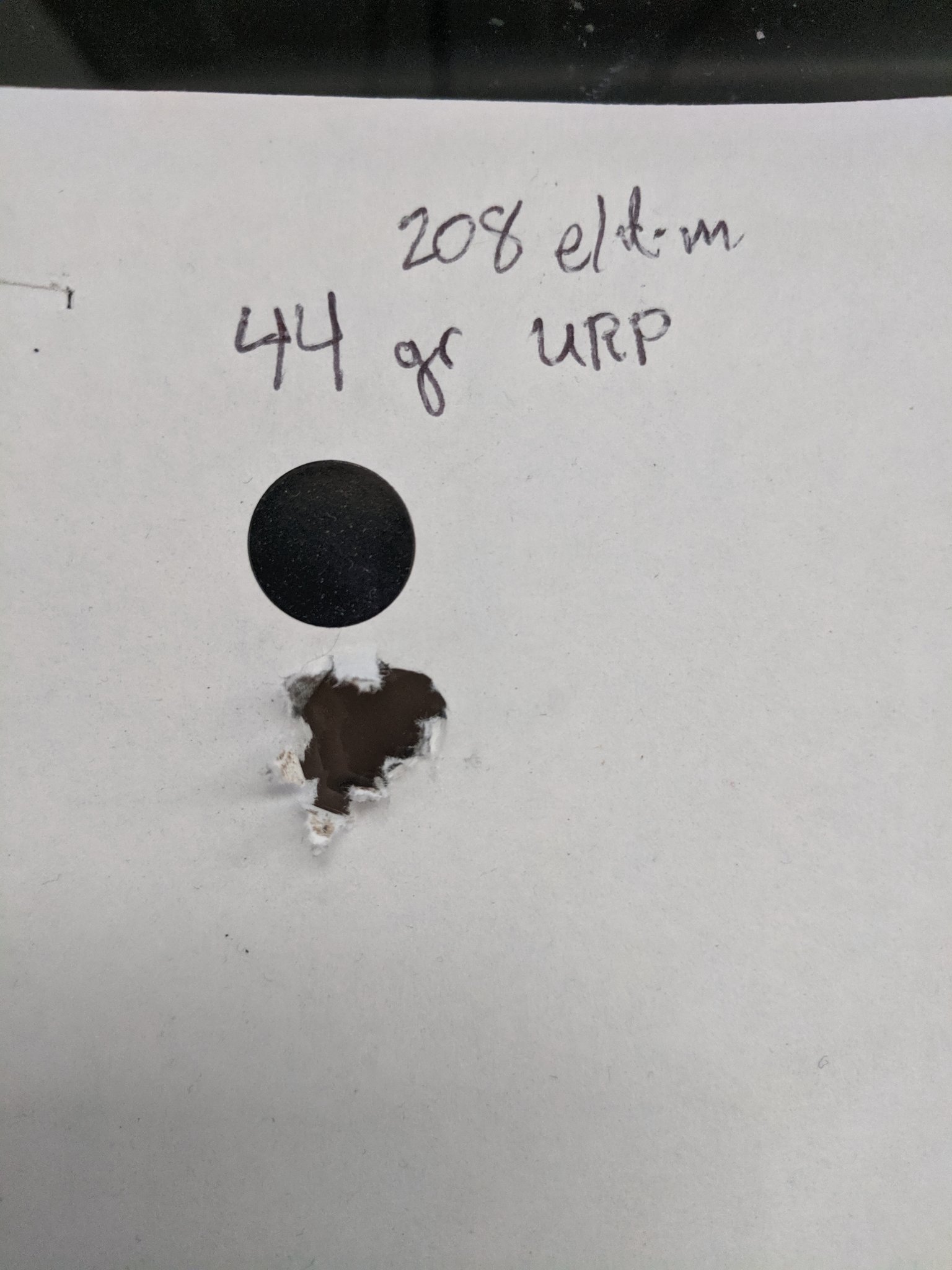

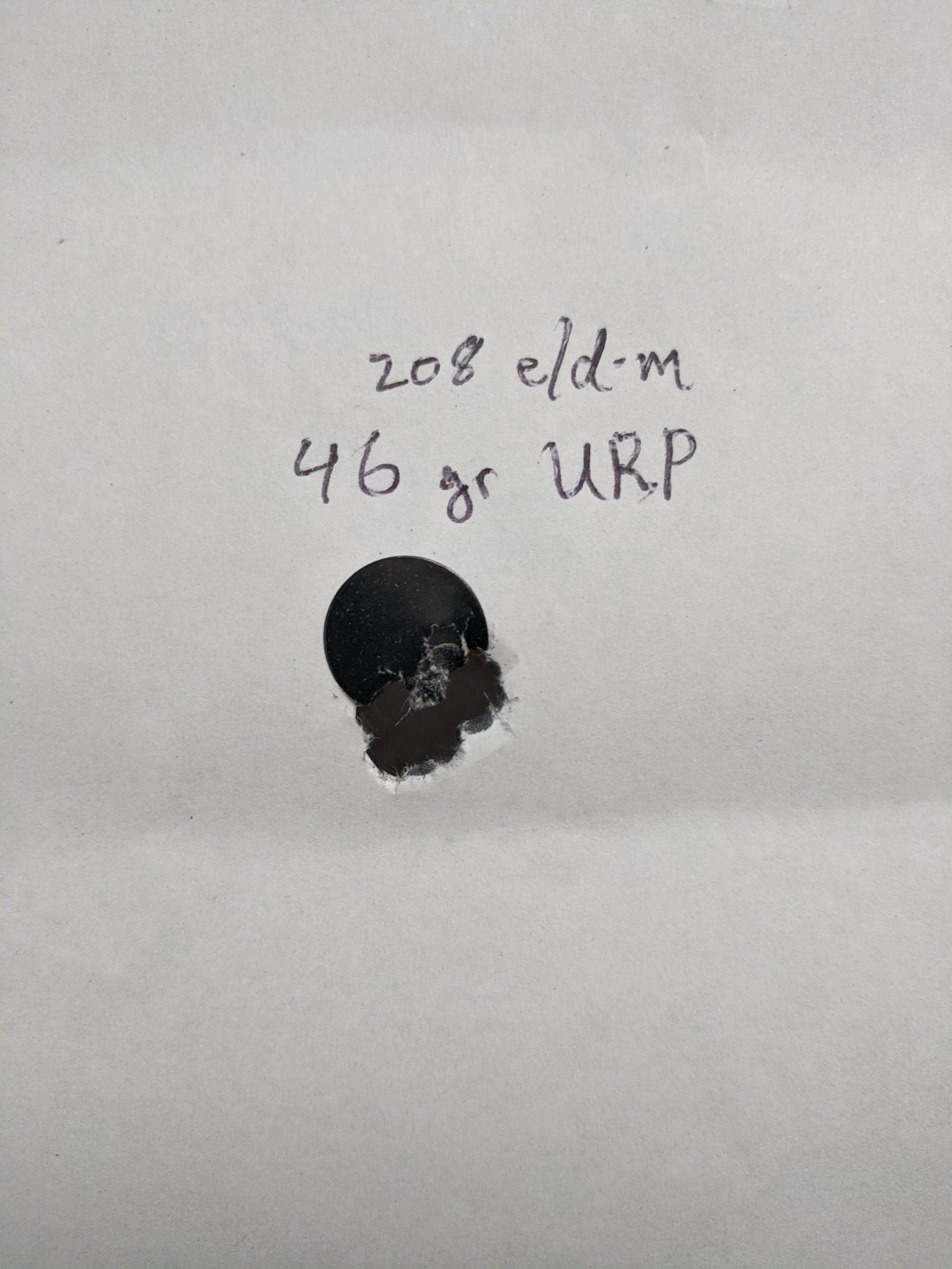

^And my RL17 load was 45 grains out of Fed GMM brass 3.043 coal, ~2650 with 208 eld-m. URP was better with temperature changes though.
