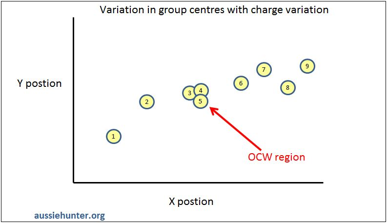

What other details can I provide? The charges today were H4350 in 40.2g, 40.5g, 40.8 and 41.1. Previously I tried a wide range. 35.6, 37.6, 39.6 and 40.5g. 40.5g gave me the tightest group, but just over an inch. So that’s what I based the charges today around. Although a new shooter, I have successfully cooked up a combo for my T3x .223 that puts single hole 5 shot groups together at 100m and .5” at 200m (if I do my part).
So you just went with the smallest group instead of identifying the middle of a node? Thats a good way to get nonrepeatable results.
Id suggest reading up on the Optimal Charge Weight test

Maybe @Steel head can chime in with the chart showing how to read an ocw. My google fu is failing me now looking for it.
So for now all I have is this. If you took each charge weight that you fired at the individual targets, identified the center of each individual group (while disregarding group size) and then laid those all over top of one another you would be looking for something similar to this
Charge weight 3 and 5 are one step below and charge weight 4 and both impact at the same location as charge weight 4. This means that charge weight 4 would be the middle of your "node".
You pretty much nailed it.
