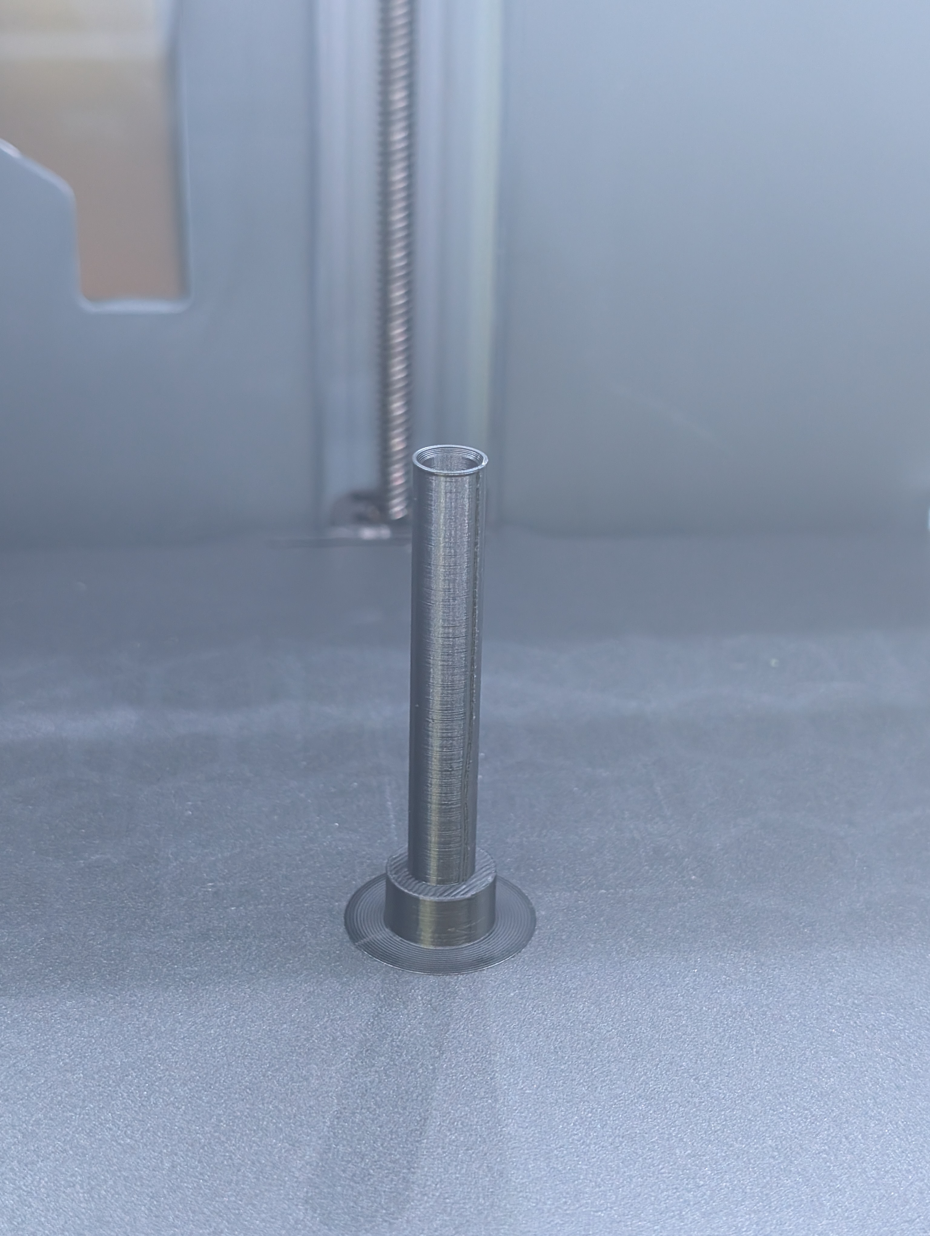

Can one of you fuckers make a 3d printed design for the bullet bushing insert? 😮‍💨
Otherwise I'm a just stick my broken DAA feeder. It would be sweet if Dillon made factory conversion kits for 6mm and 6.5mm. Oh and a universal hanger bracket for Mark 7 loaders or others.

For which? Dillon or DAA? Like the one I demonstrated above?

For the Dillon as in your solution to adapt the Dillon bullet feeder.

Send me a PM for the Dillon insert.
