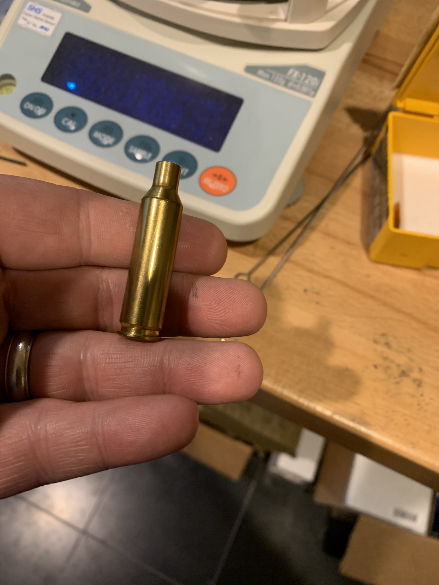

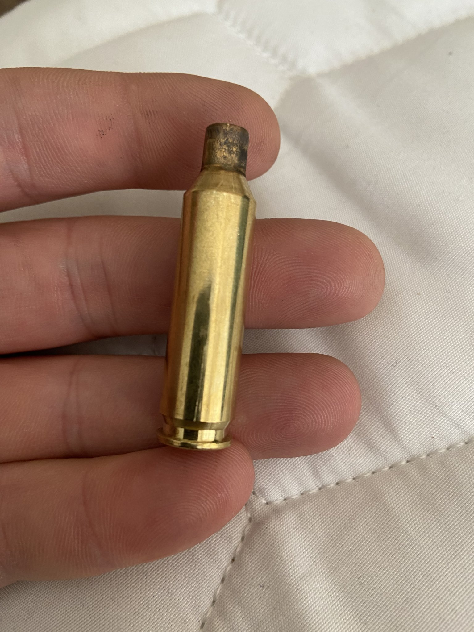

I had a rifle built the specs on it are a McMillan a5 stock impact 737 action and supposed to be a bartlein 6mm creedmoor barrel with 7.5 twist. 20” barrel. I was shooting hornady match 108gr eld factory ammo. The scope is a zco 4-20. Took it out brand new today and I was getting keyhole impacts any ideas? The distance was 50 yards with a free hanging paper target here’s some pics

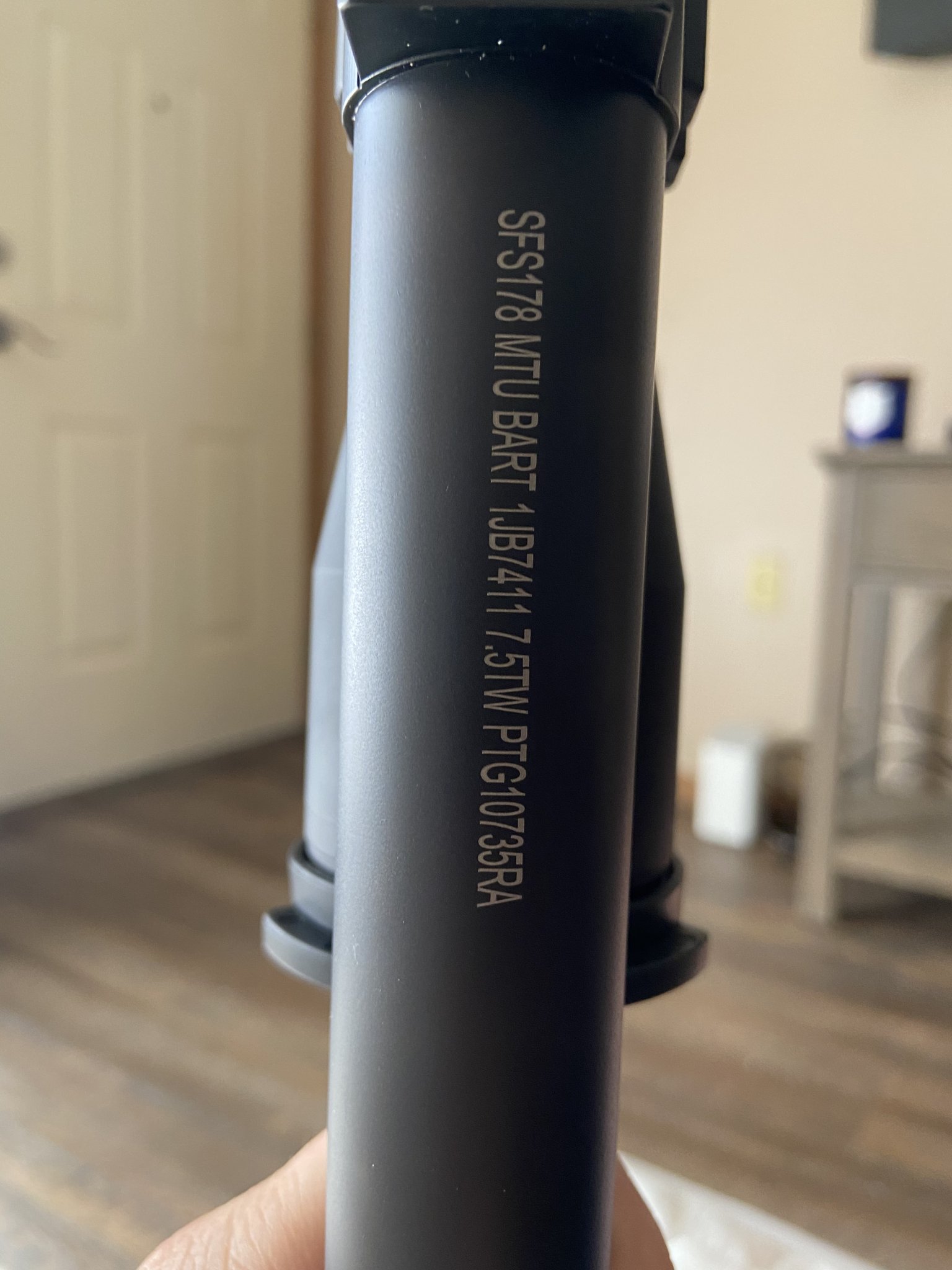

Check the markings AND bore size on your barrel. A 6mm bullet shouldn't drop into the bore.

I don’t have a way to measure the od today, however a fired case will slide all the way down the bullet of a unfired case for what that’s worth

After you check twist as suggested above, have someone bore scope it. Or just send it back to whoever chambered it & let them figure it out.
I’ve seen cases where the twist rate was wrong (Remington R800 300 BLK marked as 1:7 twist when it was 1:10 in reality)
Could also be a 0.257/.264 bore instead of 0.243

I shot 18 rounds at 50 yards since that was the closest the range allowed and only 4 even hit the paper and of the 4 3 keyholed
Holy Shit, 4 out of 18 round ? as close as 50.
.. if bullet not brushing against muzzle brake bore . it has to be a mismarked barrel on the bore size ? . bigger bore like a .257 bore, others have said.
I wouldn't waste any more of my time loading, and money on brass/bullets/powder till problem found .

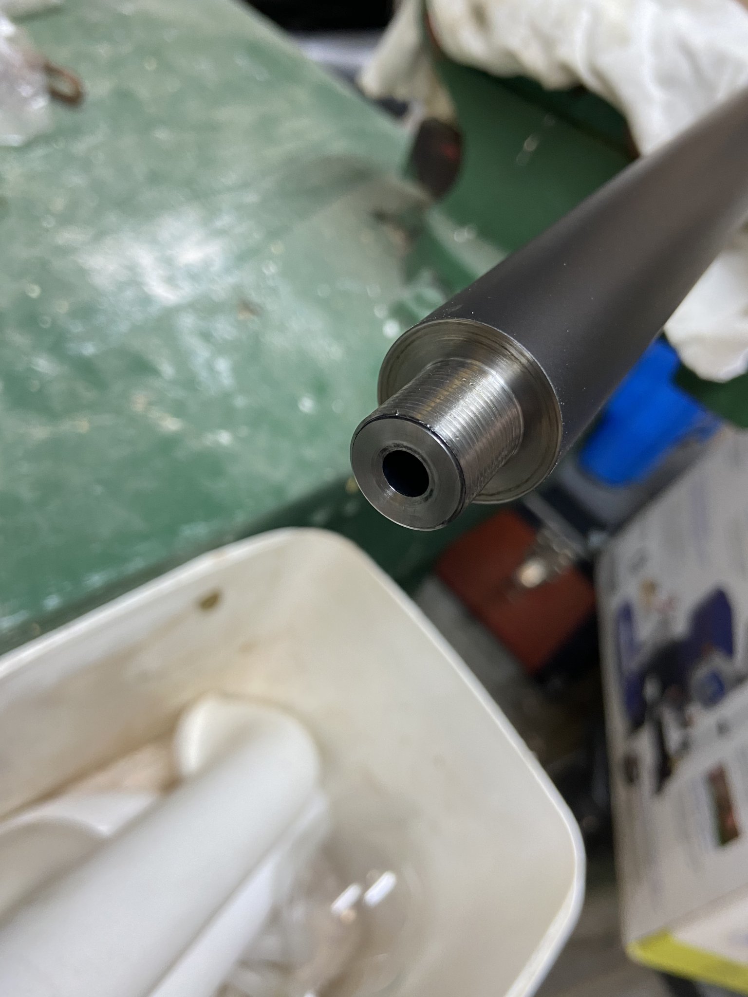

Someone already suggested the bore size, try this quick.
Ok got the brake off and it seems to be the right bore and twist and my bullet does as you show in yours the bullet stops half way in. I’ll try shooting it without the brake
Why don't you want to just send it back. I think at this point many have suggested to have the builder look at it.
I do believe the problem is not going to be solved simply because you took the break off. If you were having strikes on the break, then yeah I could see the break coming off to be a solution. However that's not the case.
As has been mentioned....call the smith.
If you shot it without the brake...and it shoots...either the brake isn't properly relieved or it's on too tight or too loose. Yes you can over tighten a brake and distort (constrict the bore) right at the muzzle end of the barrel. If that's the case that is a guaranteed accuracy killer. If it's loose it will vibrate and move around and cause harmonics and vibration issues and again effect accuracy.
The barrel was cerakoted all there is this on the bottom of the barrel
The s/n is missing a digit. Get me the complete s/n and I can look it up. I did a look in the s/n log books and no 6mm's made that start out with 1JB7411X.
Should be 1JBxxxxx (there is 5 digits after the letters).
Did you order the barrel or the gunsmith? Or who did you get it from. That might help me and might not to look it up.
Later, Frank
Bartlein Barrels
Later, Frank
Bartlein Barrels
Brad from bartlein was able to locate the serial number and it appears to be what my smith said it is. I’m going to take it back to the smith today and let him figure it out. Thank you for your help
