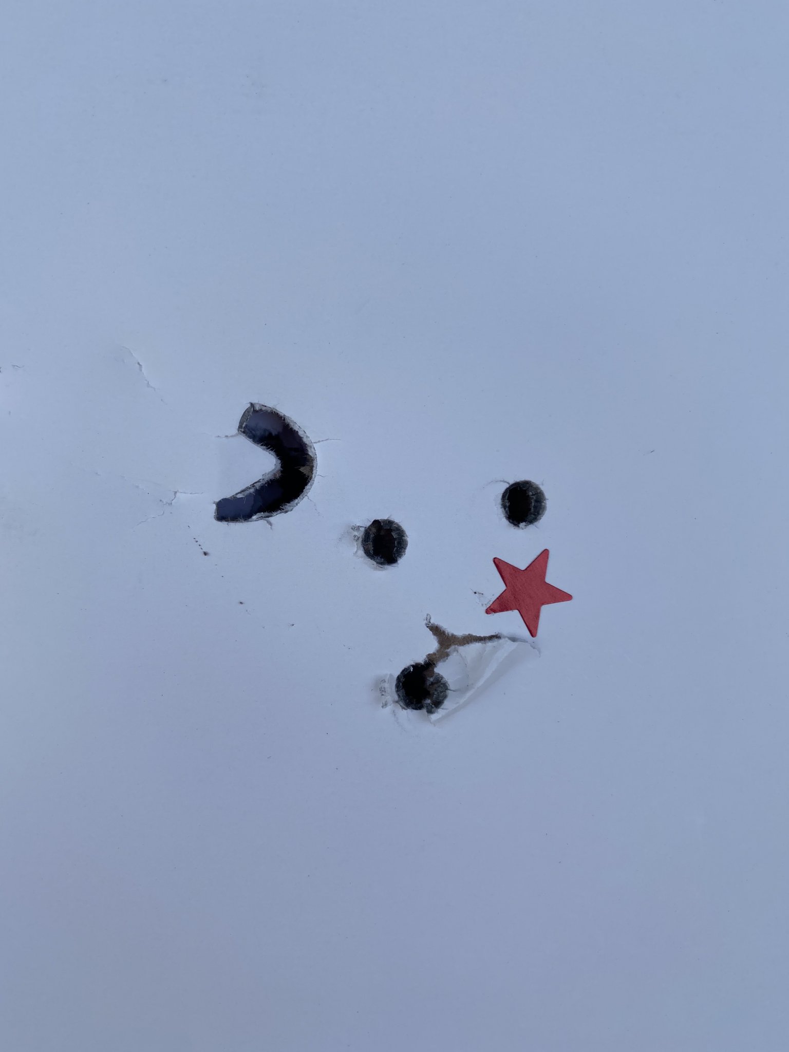

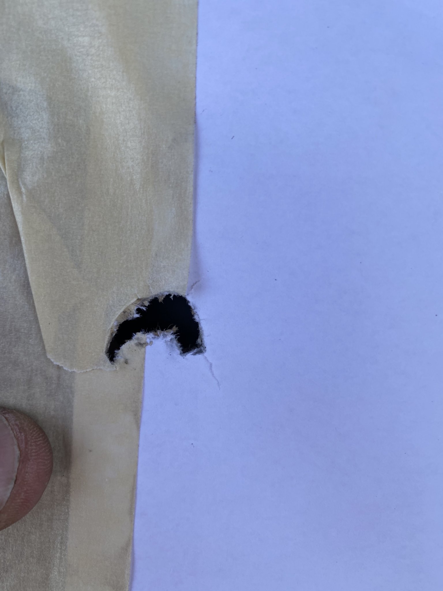

OK i have seen keyhole before...it has happened when I was shoot bullets to long for the rifling...however i have NEVER seen this!!! WHAT could cause it?
I was shooting a 147 Hornady Match out of a Proof CF 26 barrel with 57.5 grains of H1000... 6.5 PRC Bighorn TL3 Action
at first I thought maybe they were striking my muzzle break, but I shot 156 Berger EOL with 55.5 grains of H1000 and NO ISSUES...
I did have some pressure signs--heavy bolt lift and swipe marks.
I have never hear of stability problems due to pressure..
What am I missing...I have ruled out crown damage, Muzzle break interferance, stability twist rate....so what am I missing.
I had several seemingly "evaporate" at the range. 2 spotters both witnessed them. probably 4-5 out of 10 rds that day. Had not seen it before personally.
Seems with my 1:8 twist and 3000 fps it's not getting > 300,000 rpm, so I'm guessing it's the core melting theory.
Hornady Lot# 2191026

I haven’t said anything about this to anyone before this, but early in May I helped run a long range practice. Two guys were shooting factory 6.5 Creedmoor 147g ELDMs at approximately 2700 FPS. At 1000 yards, even after getting them dialed in really well at 800-900, only about 1 in 5 could be seen impacting or missing and making splash. Even after one guy, a solid shooter had things dialed in, only about 1 in 5 could be detected at all. After I suggested that there might be an issue with the 147s, he changed to 140g factory and nailed it at 1000.
I did not see them vaporizing, but there was definitely a noticeable issue. I do know that until Hornady can prove that they’ve solved this issue, I will not be using the 147s.
Reactions: Bkultra and jhunter
Possible they're coming in sideways and just the way that particular paper / cardboard is not tearing cleanly.
There are at least five different posts by different people, over a period of more than six months, that have posted the same type of elbow macaroni impact, so this is neither isolated nor a misread. This is the copper separating from the lead and being deformed in the process. It is not an isolated instance.
Just puttin it out there.
Is there a consistent velocity this is happening? It sounds like 2800 fps? The factory ammo shot really good out of my 23" barrel but only 2625 fps. So I am loading with H4350 to 41.2 gr and getting around 2705 which I am happy with. I haven't had a problem, but I've only shot up to 41.9 gr and about 2755 fps.
Good info lash, caution if using a can. You don't want jacket separation with that.
Supposedly it’s more rpm’s than velocity. Of course velocity and barre twist are both calculated in the formula. The faster the twist and higher the velocity the higher the rpm’s.
> 300K seems to be the problem.
I had problems with multiple ELDM’s a good bit below 300k
Extremely
Low
Drag
Macaroni
As did I. Like 270K rpm’s. I should’ve restated from my earlier post that the second theory is the lead core partially melting and separating from the jacket.
