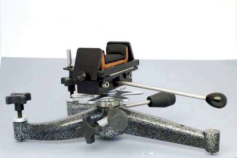

I just remembered there’s a guy who can add a joystick top to budget benchrest front rests.
Here is his co-axial joystick top affixed to a Bald Eagle bottom.
Reports I had read indicated that, while no SEB, the rest was quite good.
Reactions: kthomas
