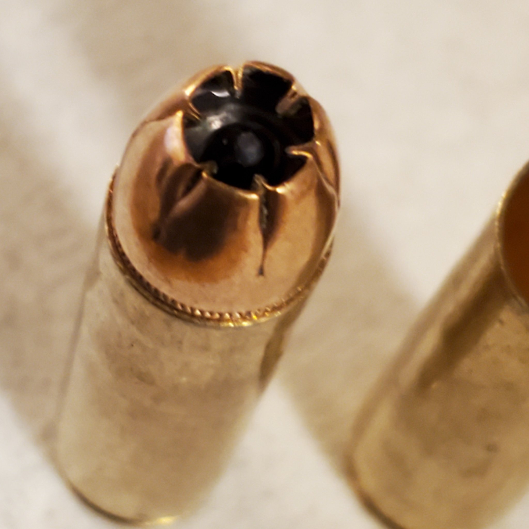

I've been having excellent loads with 458 socom..

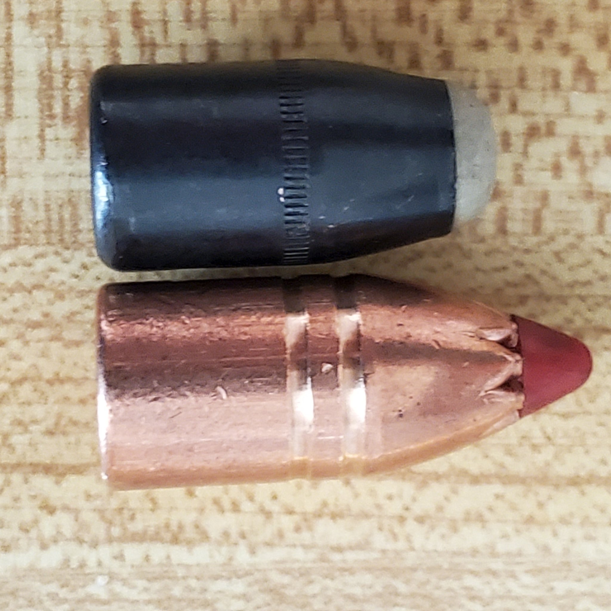

Recieved some new bullets ,some Nosler balistic silver tip 300 grain and some plated 350 grain FMJ from Everglades ammo..usually I shool check brass and good,clean no bad signs..I have shot the new ones silver and fmj and the brass has bad powder burns on the sides bout half way down brass,thought might be pressure so changed loads up /down ,I crimped a couple vs non crimped but with both still burnt.. No other loads have this issue.

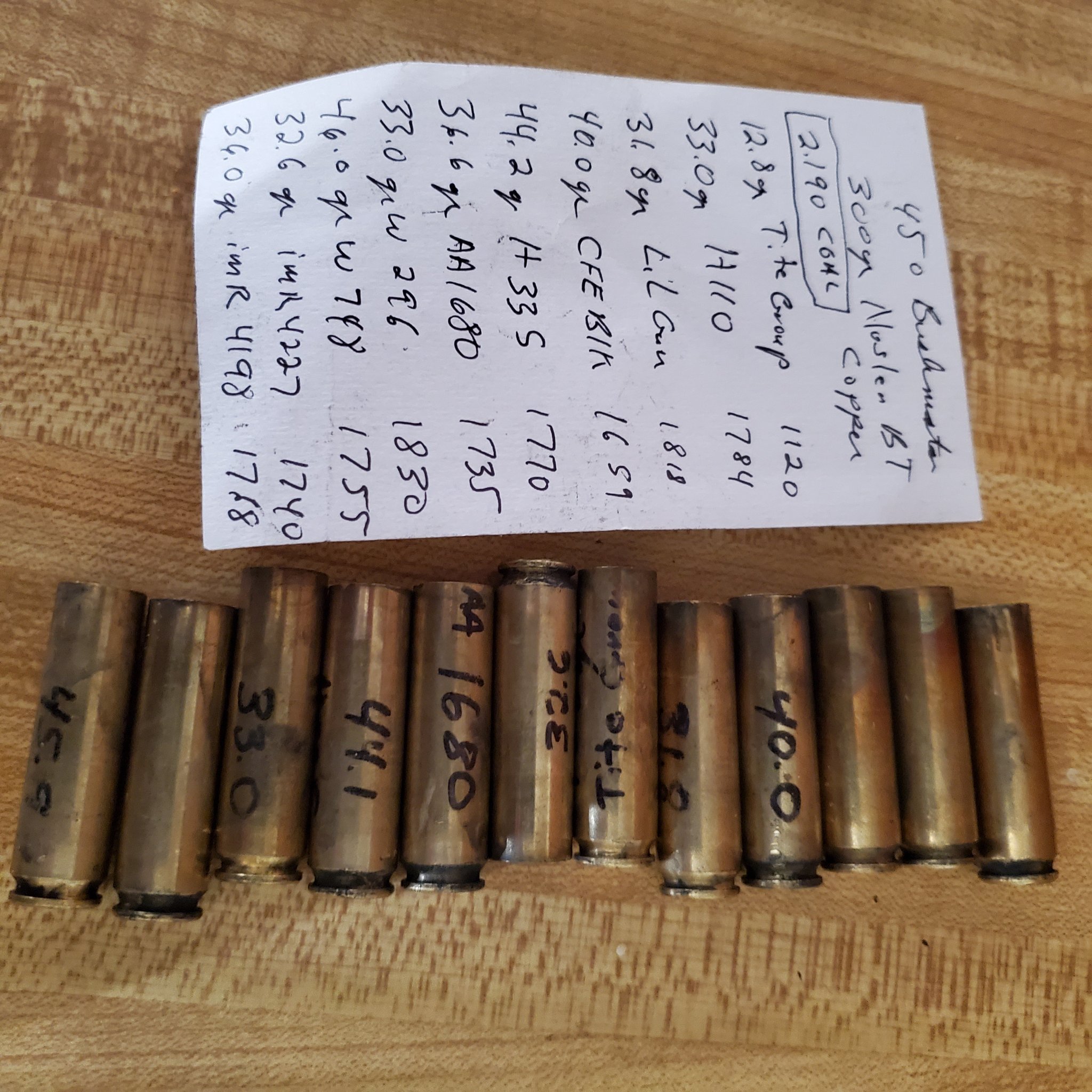

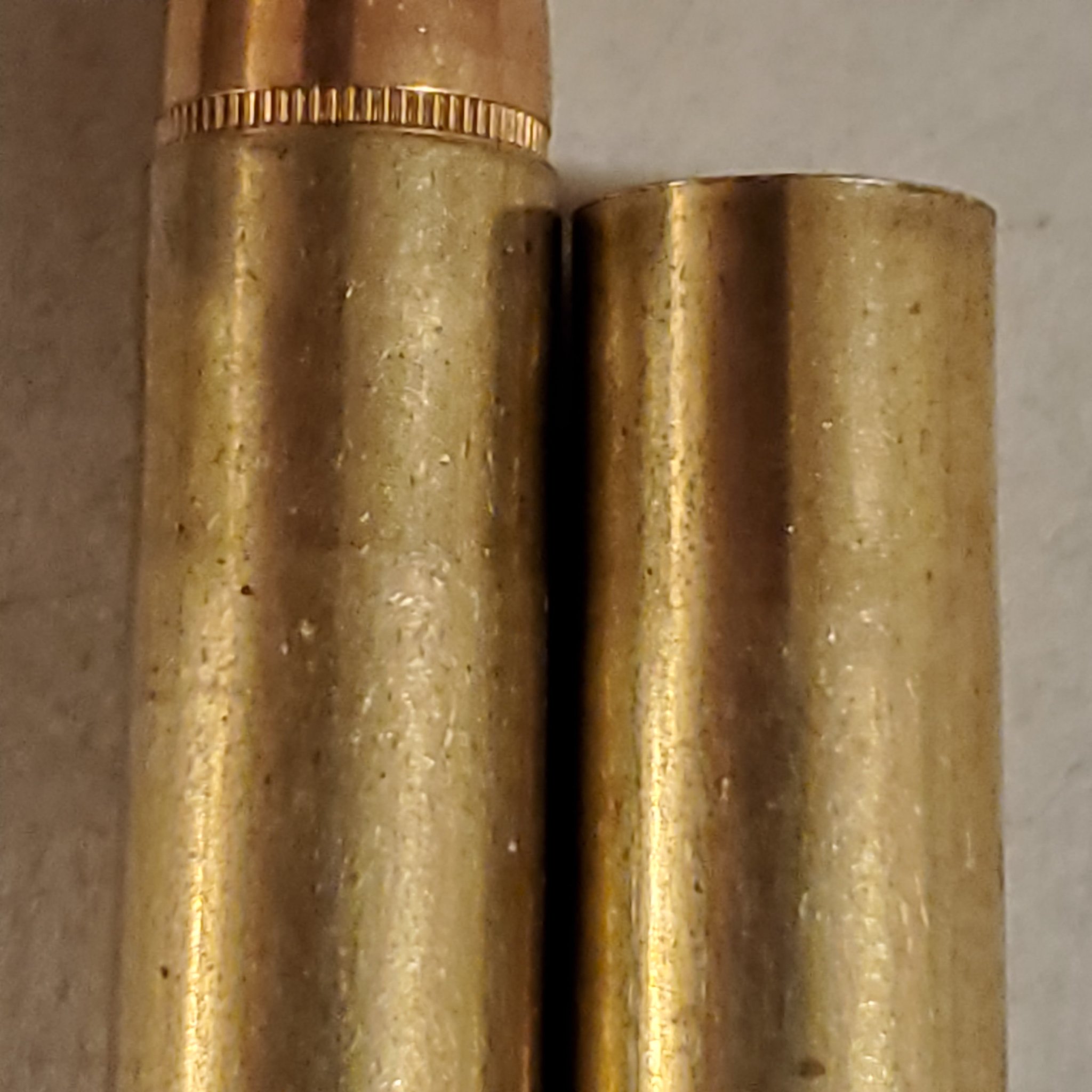

Has anyone else been blessed with this problem?? 17245476571212464490733673849343.jpg
Reactions: 338dude
Not sealing properly in the chamber(?). Possibly a light charge weight(?).
I have a light plinking load in .45 Colt that does that in a Uberti 1873 clone.
No biggy really. Hopefully they are accurate. So, clean ‘em, and reload them.

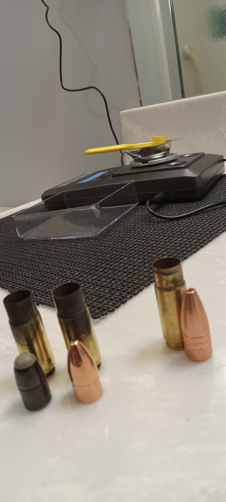

Pressure too light so the powder burns down the case neck and body before expanding to seal off the chamber.
Common in low pressure loads, and low pressure cartridges. Not dangerous just annoying.
Run pressures on the high side of the loading manuals recommend loads...it should improve.
Also some powders are cleaner than others, so changing powder may help, also.
I have Colts 45 SAA it likes Unique and a 255 gr bullet, the cases come out a bit dirty, not as bad as what you have shown, but still dirty. I shoot it that way, cause it's accurate.

Don't run them too lite. The gas can collapse the case by getting around it then pushing in the sides.
Good advice, appreciate that..Im going to go up 2 grains at a time and see if fixes itself ( that would be nice ) Only issues I do have is no load data with silver tip 300 grain or FMJ plated 350 grain..I just kind of went with loads fro other rounds ..
Do you load them to the cannelure? Dirty cases like that can also be caused by the bullets not seated deep enough; i.e. not enough grip on the bulket by the case neck.
If not down to the cannelure already, try seating the bullets deeper.

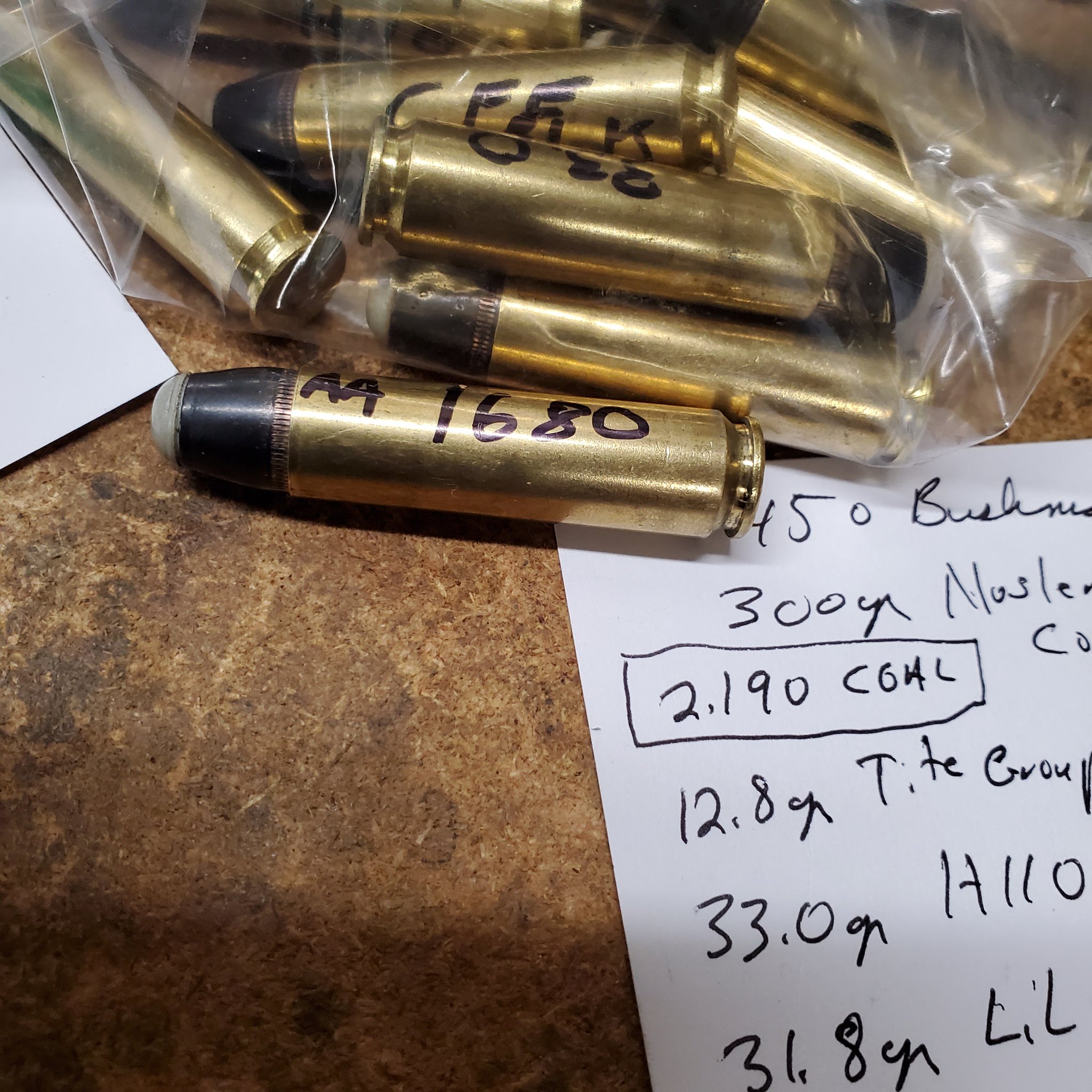

Cartridge overall length 2.050" should put you into the cannelure. A moderate crimp there helps, a bit with powder burn.
Do not seat deeper, a .050" increase in depth really increases pressure! From below to over pressure.
A max load of 37.0 grs of AA 1680.
A max load of 32.0grs of LilGun
A max load of 33.5 grs of Win 296 or H110.
Lil Gun then 296/ H110 will be cleaner burning, as far as % of burned powder being consumed.
I use Lil Gun in my 450 Bushmaster.

If you are already loading to the cannelure, you are loading deep enough.
The "burnt" case is caused by low pressure not expanding the case to properly seal the chamber by the time the bullet leaves the case mouth. You are not unsafe, it's just a PITA to clean.
To avoid this you have to increase the pressure. Either more powder, faster powder or heavier bullet. As mentioned by others, a light crimp into the cannelure will also increase the shot-start pressure.

Sorry forgot to mention powder ,Im using ,H110 and I was at 31.0 grains as of right now. A little nervous of how much to go up without load data on this bullet...I'll try the crimp first before going up any grain ..
Awesome info ,thank you very much.
Heading to take all this advice and put it to use.
Again I appreciate all the help with this from you and everyone here
Reactions: 45-90

A max load for H110 is 33.5 ? If so Im way low at 31and really was low running them at 29.8

So hoping max is at,33.5 it would be safe being I’m at 31.2 now to bump it up a grain of H110..
As of now nothing showing any pressure signs. Wish as alot of people Im sure they had more H110 info lol

Work up slowly check for pressure signs.
Found a little 458 SOCOM data with the Nosler RN BT
2.040" cart overall length
CFEBLK start 38.0 max 41.0
H4198 start 35.6 max 38.2
IMR4198 start 34.8 max 37.5
IMR 4227 start 28.2 max 33.3
H110 was not listed.
Might try a sub load of TiteGroup,
12.0 to start, to 14.0 max
Do not go below 11.5 bullet may stick in barrel.
It only fills the case 36% but has been design factor that allows clean burn, and good ignition regardless of powder position in the case.
But it may not cycle the action completely.
Reactions: justincase

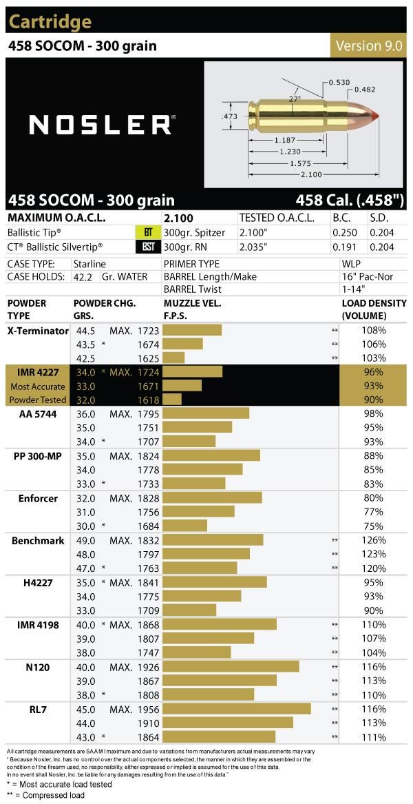

Here is Nosler Data for 300 gr silver tip BT
Notice the difference between the 2, 300 grs bullets they offer... different cartridge overall lengths...the 2.035" COAL is for your bullet.
They do not have H110 listed either.

I shoot 458 SOCOM a good bit. It could be a light load, but 31gr of H110 doesnt seem too light from my experience. I like Lil Gun, 1680, and H110 in mine. My favorite is Reloder 7, but its like fairy dust today, so I use it sparingly
What barrel are you running? For a long time the 458 SOCOM chamber varied from every manufacturer

Running a Tromix 1/14 barrel..I here alot of people that regularly actually shoot 458 go with the RL7 and love it
Im going to keep the 31 grain H110,load and mess with it a lil,appreciate all the imput and help with this load ,it does the same with plated FMJ 350 grain bullets too so I dono whats the issue but only those 2 give me issues

Already been covered, but I can confirm you could stand to have a spicier primer if possible (Federal magnum is a solid option), more powder, or a faster burning powder.
What happens a lot with these big bore straight wall or nearly straight wall cartridges is that the primer and initial burn of the powder blows the bullet out of the case and into the bore, but because the bore area is so large the volume increase of the bullet going down the bore causes a pressure drop big enough to delay peak pressure enough that the case doesn't obturate. In extreme examples this allows for gas to get around the case and actually dent it inwards. It can also allow the bullet to chug and stop or nearly stop then rapidly spike pressure in a big (dangerous) way.
Bolt guns and levers, without suppressors, tend to shoot much cleaner.
Subs and supers in 510 whisper, about 200 cases fairy clean.
Same with 45-90 subs and supers fairly clean...could be reloaded without cleaning.
And a couple of cases just fired in a semi auto 18" AR 10 338 Ruger Compact Magnum, test loads...most were at max pressure of 62,000 psi. To 65,000 psi.
No suppressor....come out pretty clean, and normal appearance.

Since I have a bunch of these Nosler 300 gr Silvertip in .458" I decided to resize them to .452" and load them in the 450 Bushmaster. There is only 1 gr difference in case capacity, but seating depth makes a difference.
I seated just short of the canellure in order to crimp them with Lee FC Die, in the Bushmaster, because it headspaces off the case mouth.
They will be tested with 10 different powders 12.8 to 46 grs...fast to slow...

So here us the Data from the 450 Bushmaster, shooting the .458" Nosler Silver Tip resized from .458" to .452" and fired in the 450 Bushmaster instead of the 458 SOCOM.
All loads functioned and locked back the bolt.
Here is the appearance of those fired cases, a little dirty, but mostly the usual AR appearance.
This load data can be used in the 458 SOCOM if ya work up.
For the 458 SOCOM cartridge overall length is 2.040" at the cannalure, and the same data applies.
Compare 450 Bushmaster 300 gr Nosler Silvertip 2.190" COAL.
Usuable capacity 43.507 grs H2O.
458 SOCOM 300 gr Nosler Silvertip
2.040"
Useable cspacity 43.790 grs H20.
The 450 Bushmaster and the 458 SOCOM are almost identical in capacity, but configured different.
So this 450 Bushmaster load data, can be used as a guide for the 458 SOCOM user with any of these powders, if the above loading COAL is adhered to.
All loads are at maximum according to QL.
Lil Gun load was a max at 1970 fps and had a bit of primer flating, compared to the others...but not a big deal.
My go to powder for most loads is Lil Gun and have purchased several kegs for the Bushmaster.

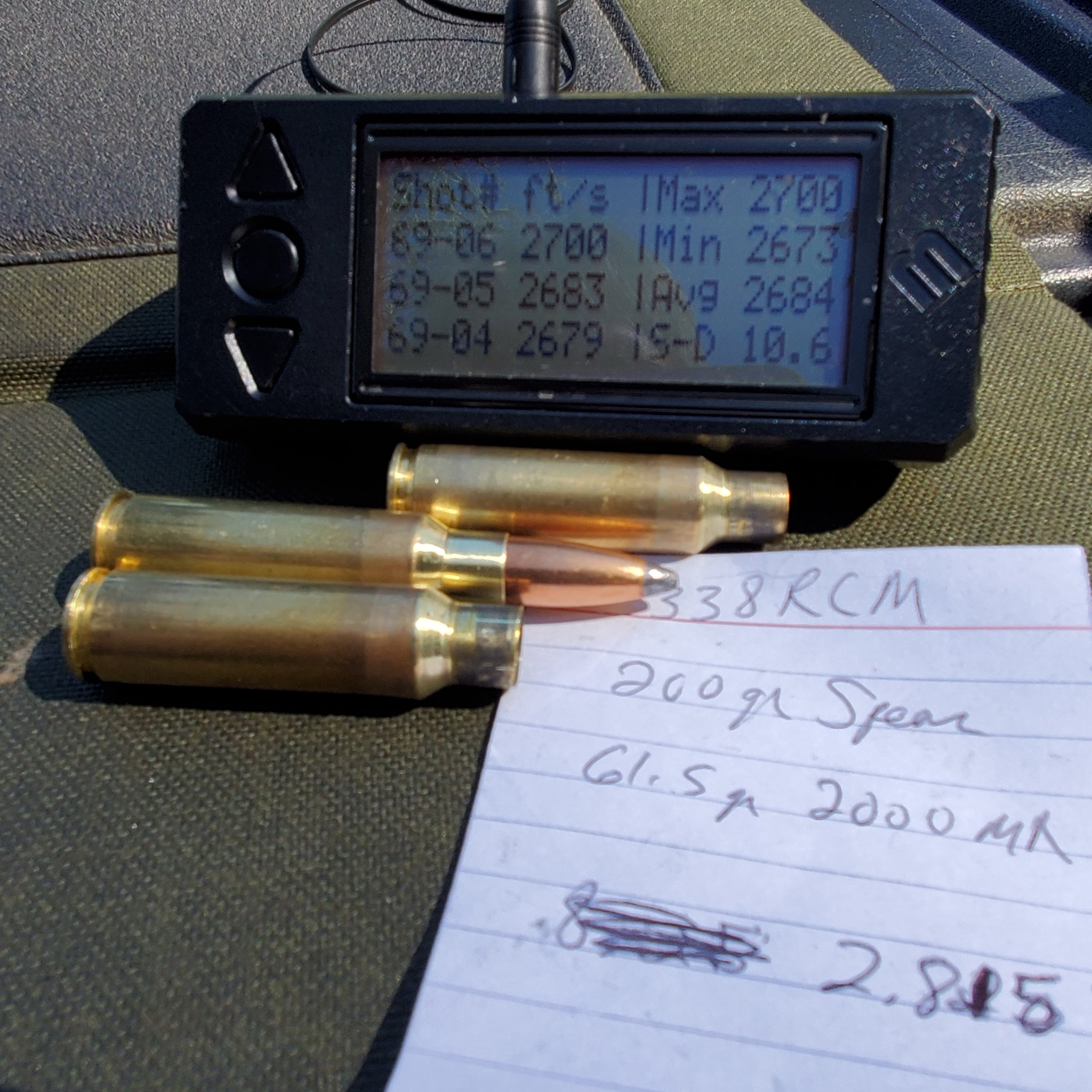

I went out to try some loads,Shot the 350 TSX Barnes loads did 85 yards Yes odd # but you never have a perfectly marked shot ,So good to sometimes just throw it out at different yards..
Here are some at 50 and 85 yards.
All I can say is was impressed...

Thanks for all the advice ..
I did load em at the max level at just about anyhow and tried a slight kiss of a crimp
( ruined a few rounds trying Crimping ) on the Silvertip and no more burnt cases ..
Appreciate it everyone..

Sounds like the trial will be to load up a few more grains and go from there and if no resolution hell they are accurate...
Really accurate ,I'm at 31.o grains now, so hopping, hopping this is the trick with the plate FMJ's because I don't know any max load for it but nothing showing any pressure signs..
The silver tips work really well though and can't beat the accuracy I'm getting on them
I think Im going to go with some of the other recommendations on powder for these bullets like the powders shown on this that you sent..

Hey figured you might be the one to ask , Going with the different powders to try ...ordering LiL Gun and RL7
Would those be good in the 458 Socom ?
I used LilGun with sucess with the 450 B and the 300 gr resized Nosler ST.
Nosler has load data for RL7 as above for their 300 gr ST, so either powder should be good...if they meet your accuracy needs.
