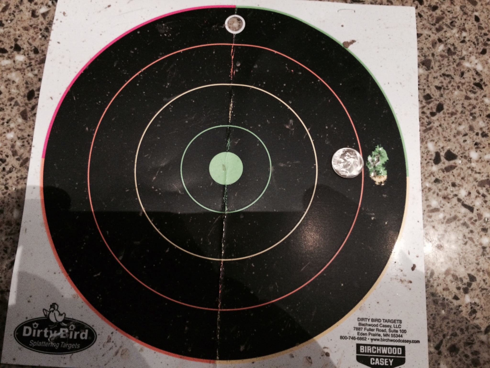

Here’s how it shot when fairly new, Five shots at 515 yds. I couldn’t do it every time, but the gun was capable.
I’m hoping the Rock will shoot my same load so I don’t have to tear down 100 plus rounds.

515 Yards seems sus....:unsure:
Suspicious all you like, it was witnessed by three other shooters.
Also, I’m not looking for validation, I’ve won a couple national level matches.
The rifle was a true freek for a non BR gun and would shoot mid 1s at 100yds with that same batch of loads.
I simply showed it’s best group to describe how fast the barrel went to shit.
I also said I can’t do it every time.
