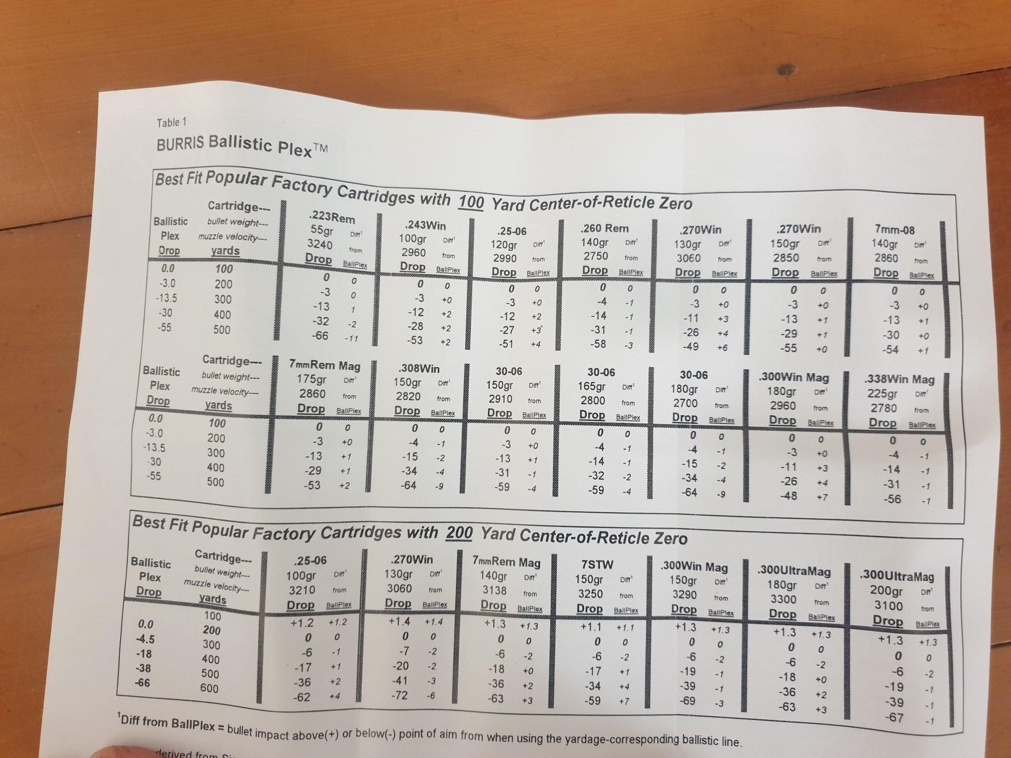

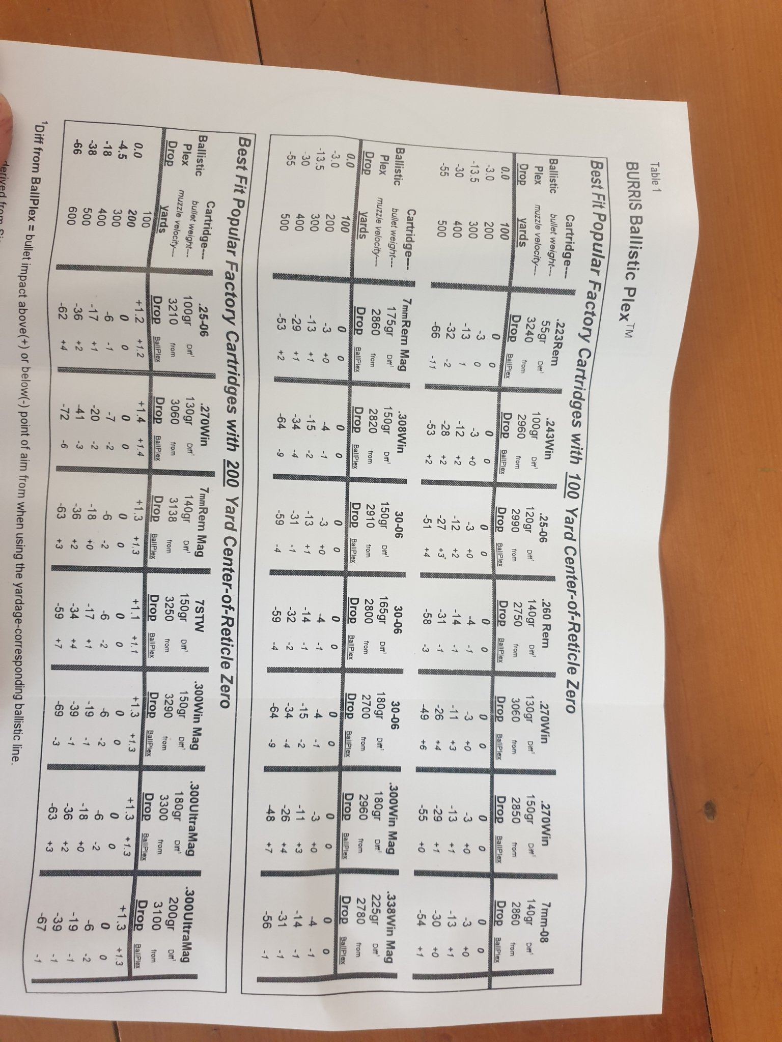

OTOH nothing that Burris is offering with your scope including the software to fine tune the bdc drop value is new.
This is more what I was referring too with my "straight otta 2006" comment.
Burris has always provided information about how to "tune" the reticle to your particular load.
Heck, Burris has even always been aware that there are flaws with BDC, and that they can give hunters a false sense of confidence.
