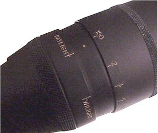

Recently bought a rifle carrying a Burris Signature USA 3-12x 45 (?) that has an adjustable iris like a manual camera. In a camera the iris (f stop) is used in conjunction with the shutter speed to adjust the proper exposure and control the depth of field (which items will be in focus). In an old Burris booklet I found reference to the iris as being a way for the shooter to control the light entering the scope and thus "obtain the best image". As the scope has an AO, depth of field is no issue and insofar as I can tell (shooting at a white target, over fresh snow in bright sun) I could see no difference regardless where the iris was set from wide open to fully stopped down. It is the first scope I have seen that has any gizmo to control (especially reduce) the light entering the scope. The emphasis has always been on getting in more light, not less. Of course, no scope maker has embraced this idea and Burris has dumped it as well. It is a fine scope that side by side with a 4.5-14 Conquest performs as well.
Just a gimmick or a lost secret of superior performance ?
