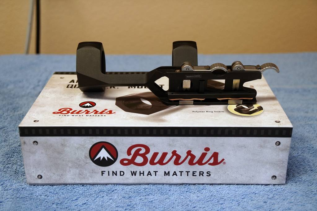

Has anyone tried these? https://www.burrisoptics.com/ar-signature-qd-p.e.p.r.-mount
I was shocked to see that Burris claims "The new streamlined design with QD mount ensures ¼ MOA re-mount capability and allows for use of back up iron sights while maintaining proper eye-relief. "
1/4 MOA re-mount repeatability seems like it would be up there with the best QD mounts, if it were true.
I was between the Burris PEPR and an ADM QD mount. I was able to pick up the PEPR mount for about half (a good amount off retail) of the cost of an ADM mount, so I thought it was worth giving it a try.
What do you think?

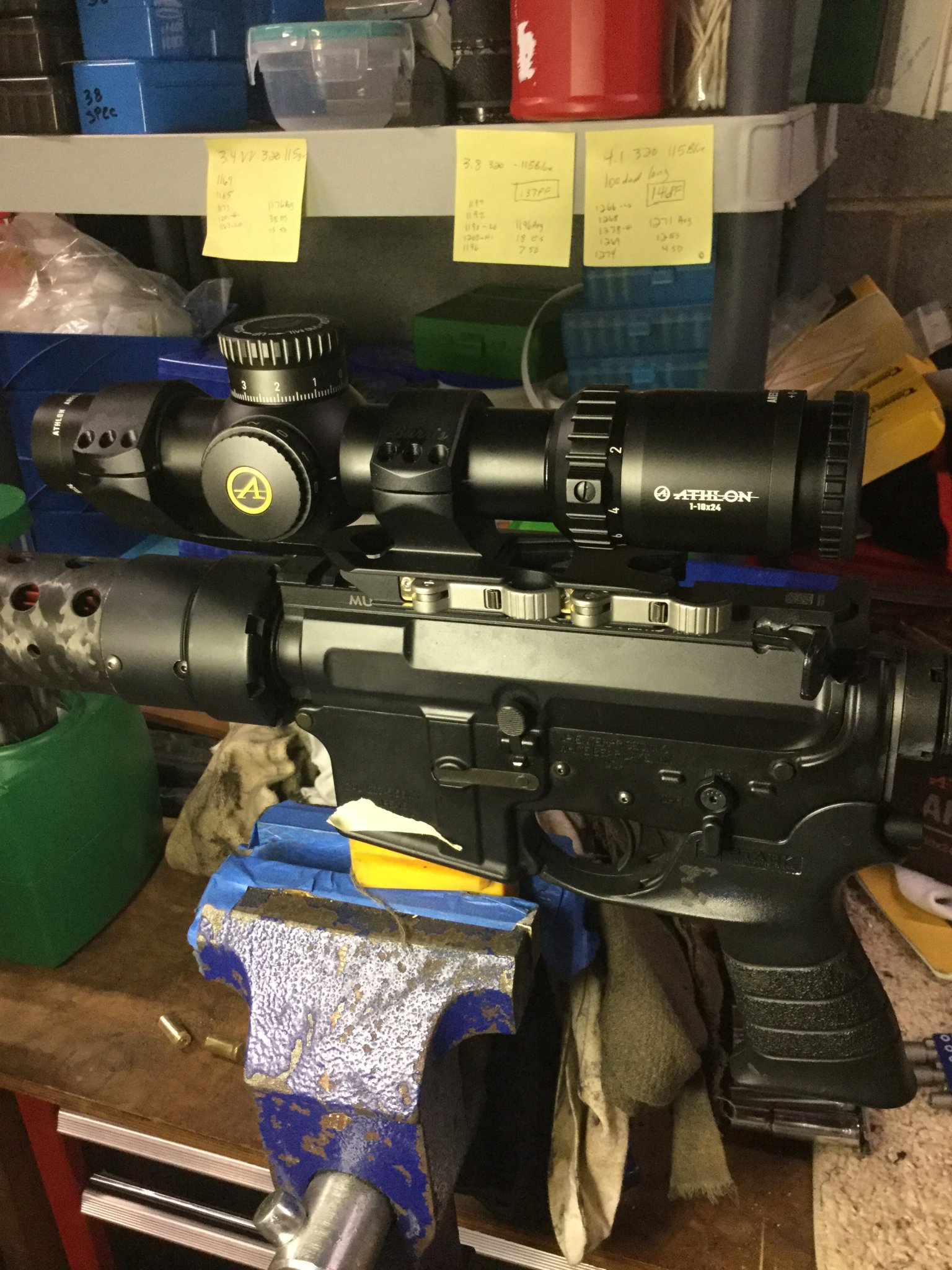

I just
got this mounted, and have not zero’d it or done rtz testing. I did put the pic on so you could get a first hand view of how they look. Sometimes things look differently in pictures. Love this little JP, have had it for a while. Serial number is under 120.

I have an AD Recon on a 6.5 Creedmoor gasser and the PEPR QD on a 6.5 Grendel gasser. I cant speak to possibilities of spring load, or what could potentially could happen etc. All I can say is they perform the same. They both clamp down snug on the rail. They hold the scope where I want it, I havent had any movement or lost zero.
The local gun shop here sells quite a few of them, I know a lot of our local 2 gun/3 gun guys are running them. Maybe I'll toss it on my 3 gun rifle and see how it does. If it survives getting tossed around in dump boxes and barrels it'll survive anything... 😉
I'm not a 2/3 gun guy, but wouldn't you want something lighter? The signature PEPR is 2 oz heavier than the Midwest Industries and ADM QD mounts, which are not lightweight mounts.
I understand the PEPR is less expensive, but that comes at the price of weight, less sophisticated QD mechanisms and a SE Asia COO. I just want others to understand the trade-offs and while functional, it's not just as good as the more expensive QD options.
Reactions: Birddog6424
Thanks for all of the info about your experiences. When I get everything mounted and tested, I'll do a 5 shot group, removing and remounting between shots, and a normal 5 shot group for comparison, I'll post the results. It will probably be a few weeks.
