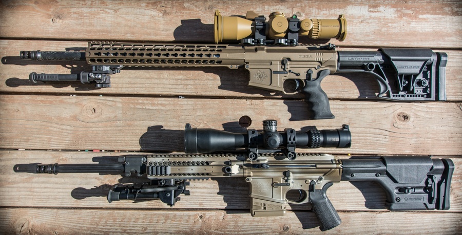

That's going to be pretty close. Generally an AR platform scope mount needs to be a little higher than what "high" rings provide. Extra high or AR high is more likely to be what you need. Or simply going with a one piece AR mount so you can use the cantilever to get the scope further forward.
This isn't a great angle, but you can see there isn't a ton of clearance here using an XTR II and probably the same JP handguard you have. That's with an American Defense mount.

Hey pug, you do not "need" a cantilever mount for a large frame AR. The top shows a S&B Ultra Short 5-20 in an ERA-TAC mount and you can see it is actually set back from the upper and not fully forward. The bottom image shows a Burris XTR II 4-20x50 in an ARC M10 QD-L mount that is one or two notches back from being fully forward on the upper and I could have moved it back further and set the scope forward more in the mount if I wanted. I am pretty certain that M10 QD-L was the 35mm high version.
Reactions: Birddog6424
Thanks Bill! That's exactly the kind of thing I'm looking for. Seems like 34-35mm is the way to go and 32mm is probably too short.
