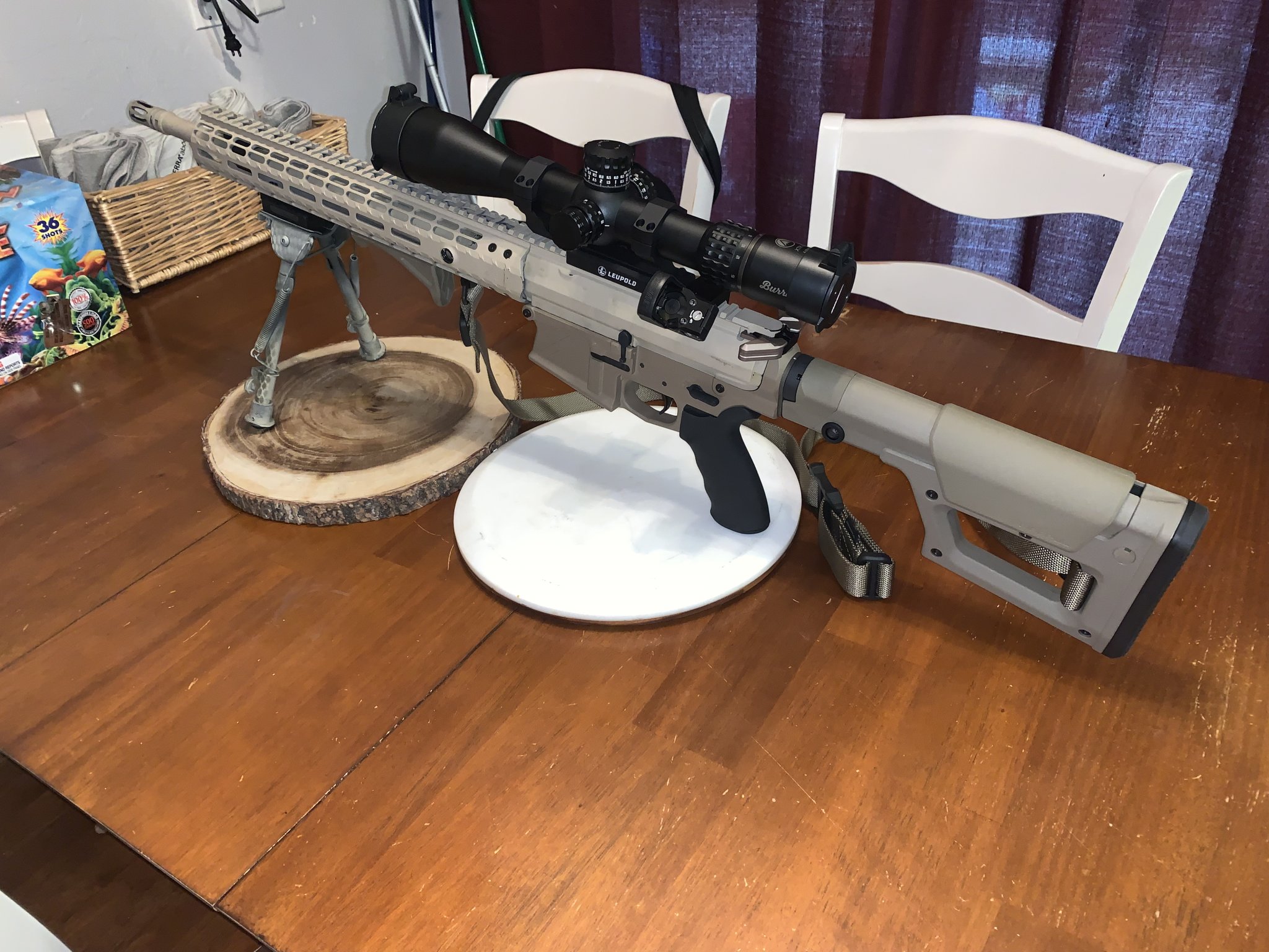

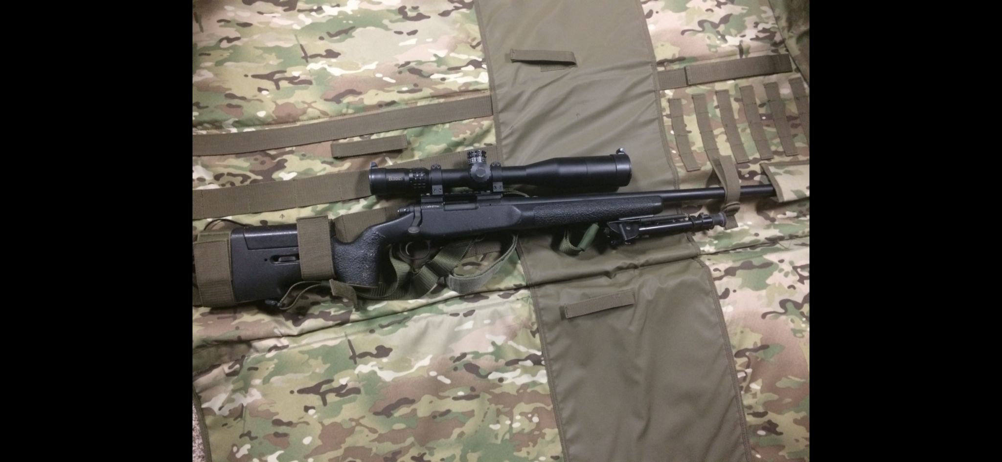

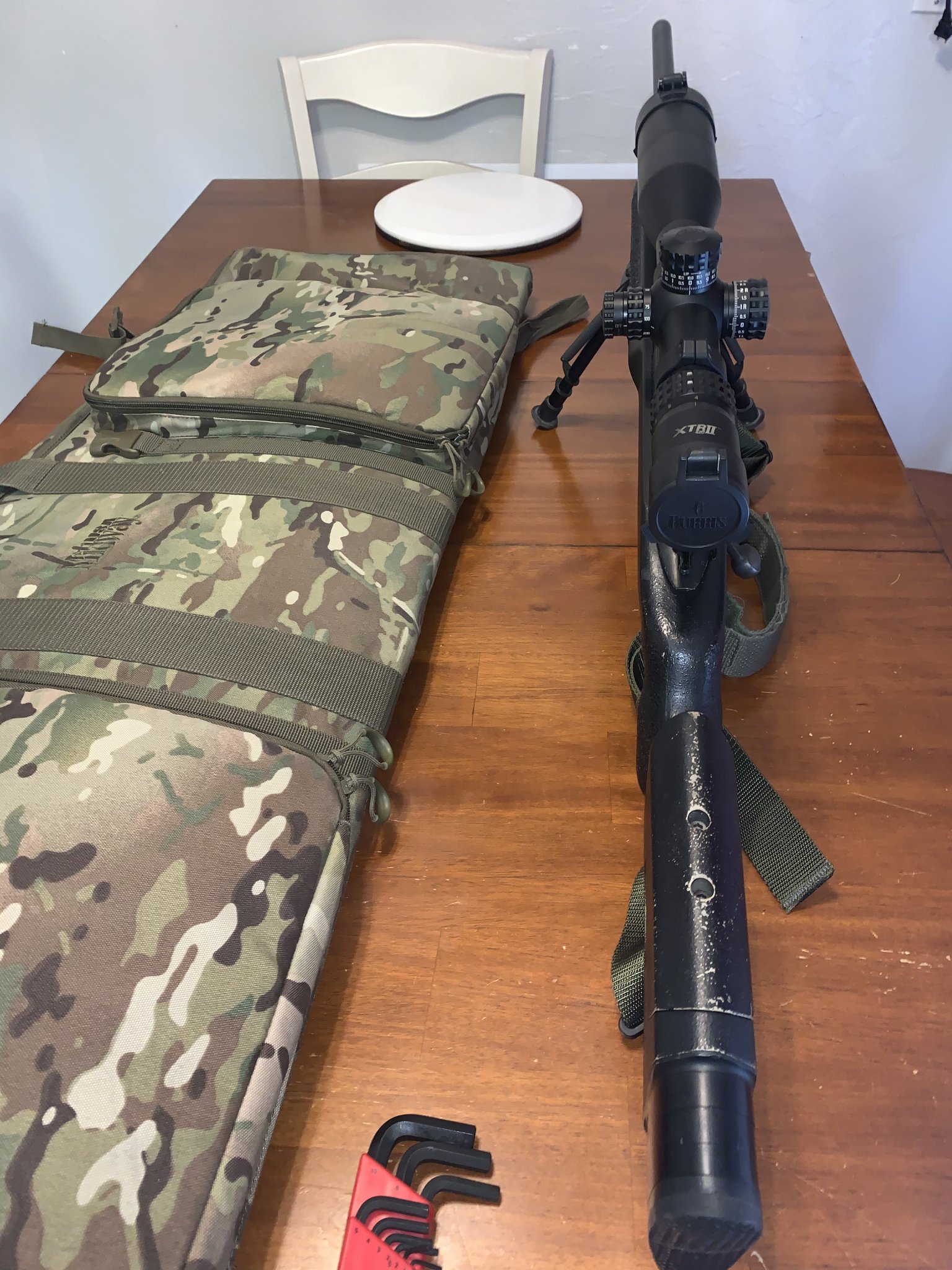

No XTRiii experience, but my first XTRii 4-20 survived a week long LE precision rifle course, a few deployments (LE usage, not military), and several hunting expeditions. Bang-for-buck, I’m very happy. It’s only ever had to have the zero adjusted when I was dialing in new ammunition.

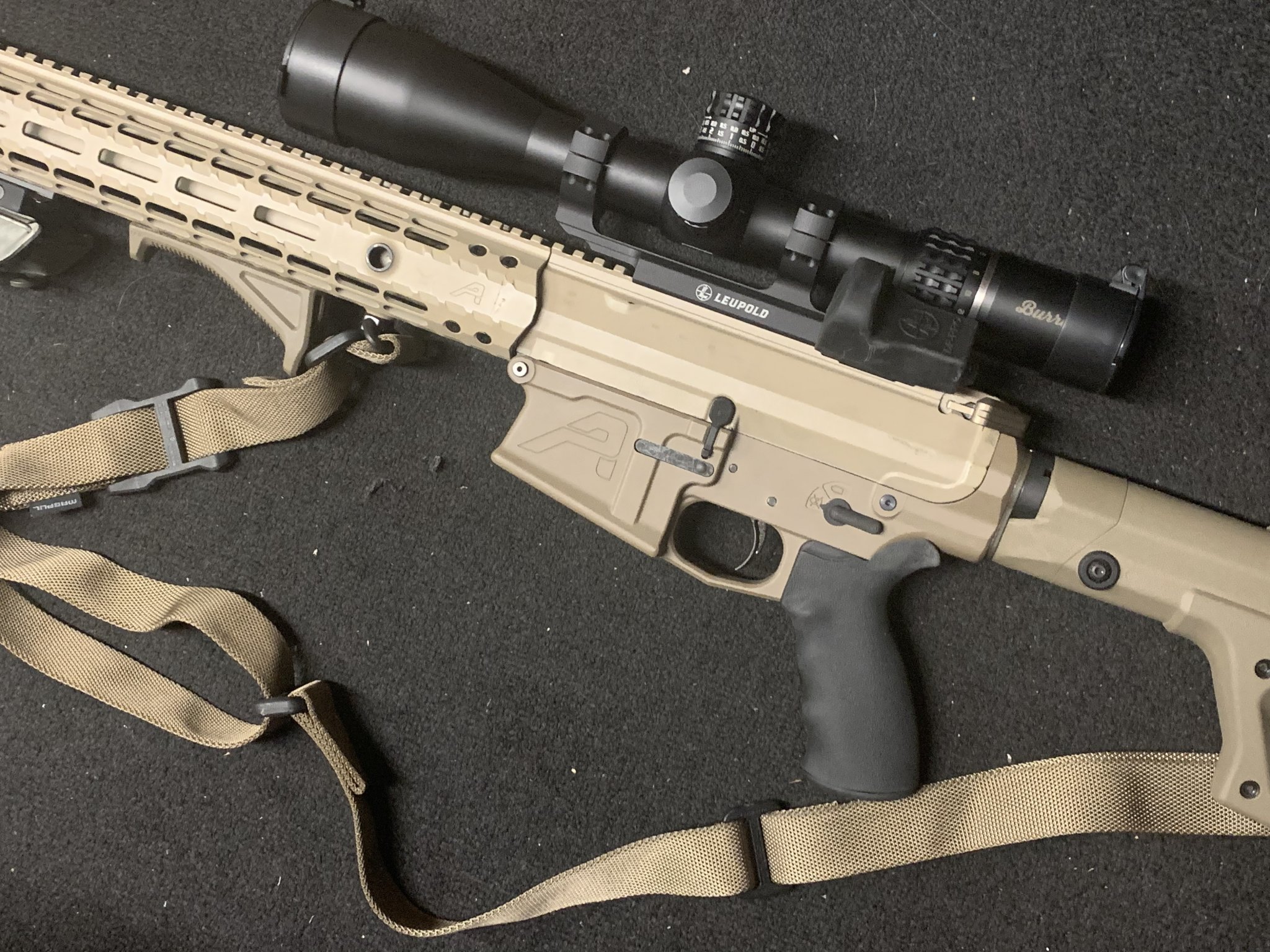

I like my first one so much I put the same thing (except with the silver ring) on my Aero M5 (.308). If I find another need for an optic, it’ll be another XTRii (unless I happen upon an incredible deal on something else.
First one on a Remington 700 PSS:
The newer style on the Aero M5:
