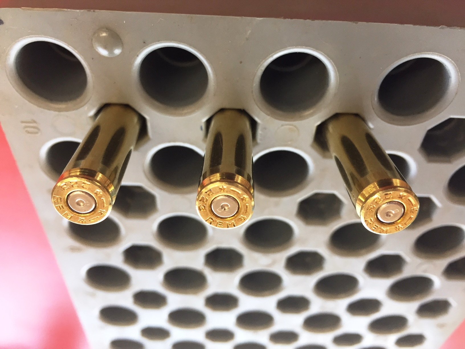

    Cratering just gets worse. I've never bushed a pin for anyone who was sorry they did. Below are some fired rounds after I bushed. using same load. Can't find the before photos but cratering was bad. Cratering can eventually wear the firing pin hole to cause it to erode and cause hard bolt lift. -Jerry

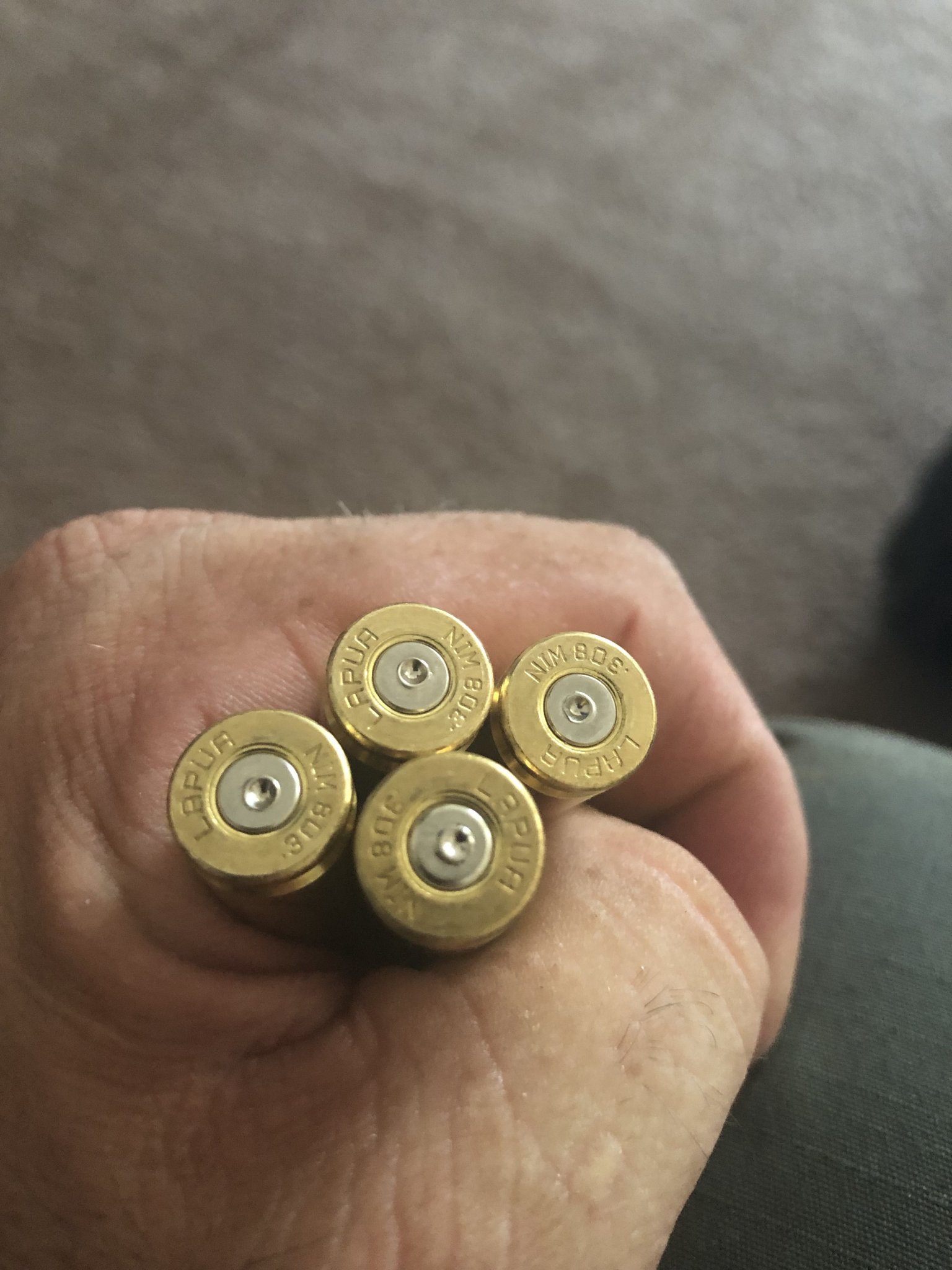

    +1 for Gre-Tan. Had to have my CA 6.5CM done when I switched to Lapua brass. took him a few months to get it done, but zero cratering now.

    I rebarreled my R700 with 223AI and the new load it loved started penetrating primers. I sent to Gre-Tan (Greg Tannel) and got it back in a couple weeks. The work he performed was flawless and the brass comes out looking perfect. Very happy I did this.
