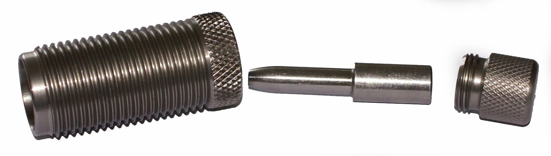

This mandrel
http://www.xxicsi.com/arbors-and-mandrels.html
Can go inside this die body
http://www.xxicsi.com/expander-die-body.html
Like so. Then as you raise the brass up into the die on the press the case mouth is forced over the arbor which should keep it perfectly straight up and down and concentric on the inside diameter.

This mandrel
