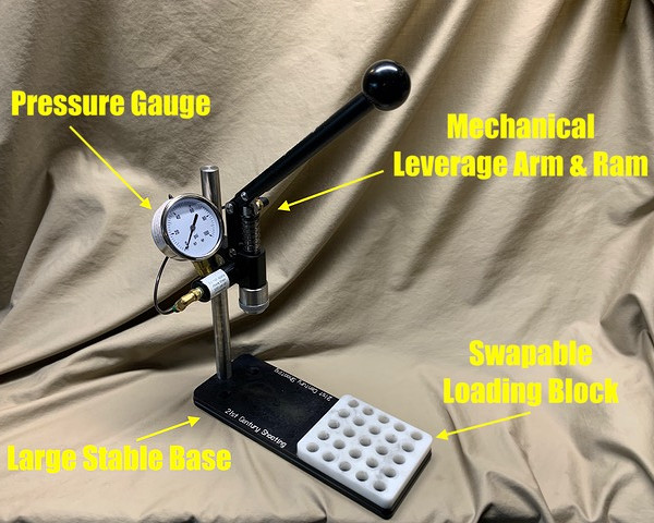

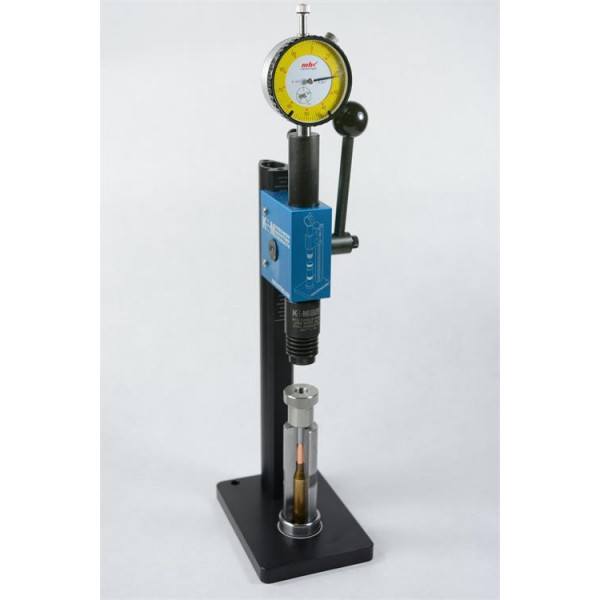

What are you using to measure the seating force?
I use the K&M arbor press for seating. You can get what they call a "force pack" which is essentially a constant force spring that goes on the press, along with a micrometer for measuring deflection. The "standard force pack" (which is what I have) has a spring that deflects .001" per pound of force applied to it. The micrometer measures the spring deflection, which measures the force applied.
I'll put up a video of it in action a little later.
