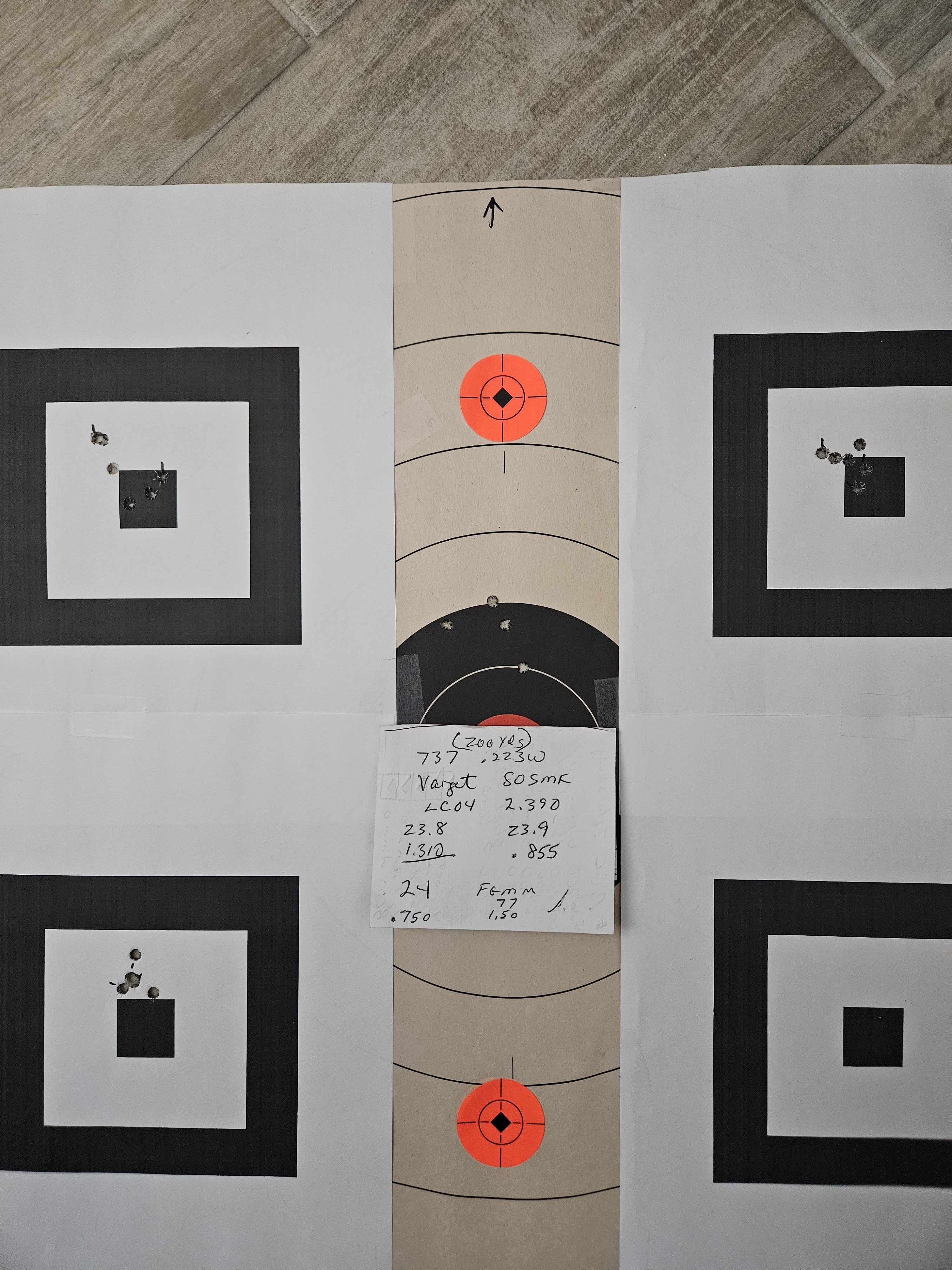

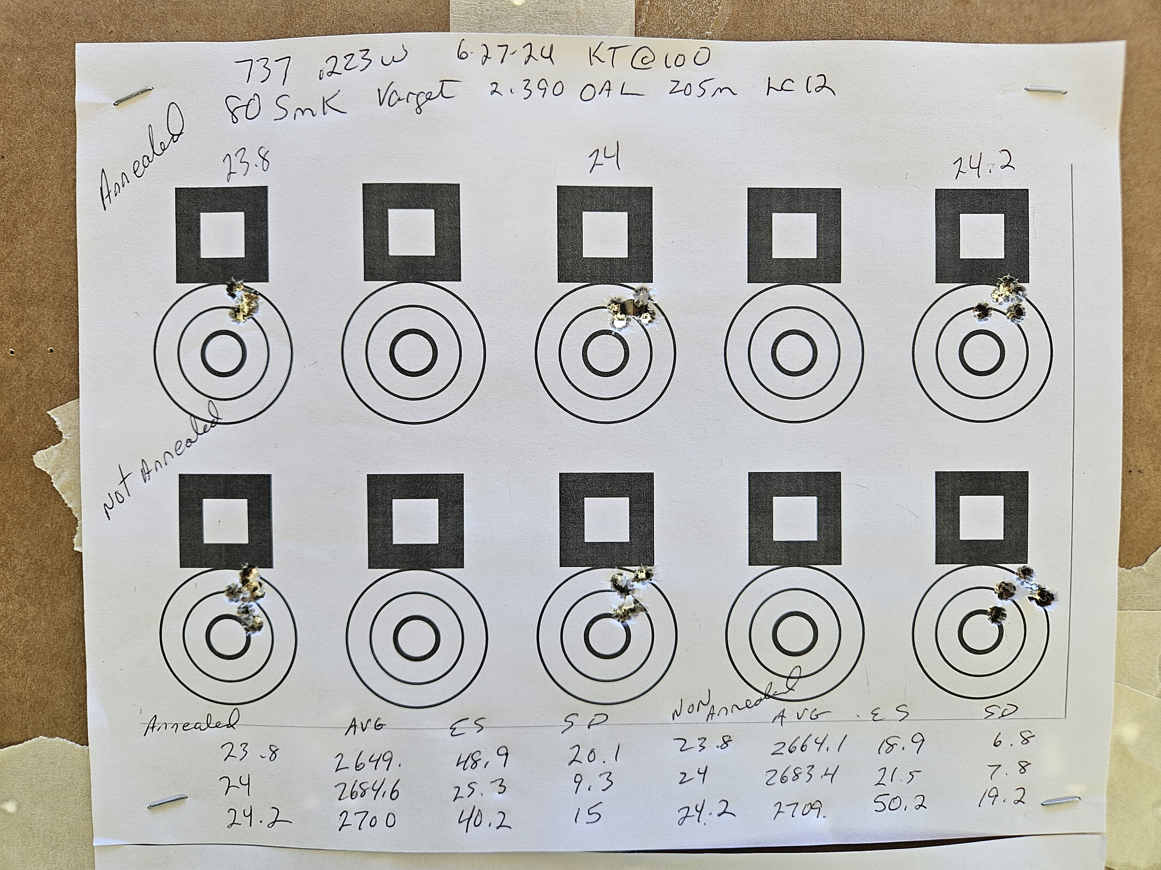

I just shot at 300 the other day, 100% on a 4" plate with the 10 impacts under 2" or less as observed. A couple pics with what I'm doing now. The tic marks indicate my 1st 3 rounds on each group.
24" HawkHill, Area 419 HFM adapter, Nomad 30 with Ebrake. Debating putting the ATS tuner back on to piddle. Blue Mountain Precision build, the gun with my redneck mirage shield.

Your 23.8 & 24.0 loads w/ annealed brass @ 0.003” interference look good. I also prefer 3k interference for AR.
