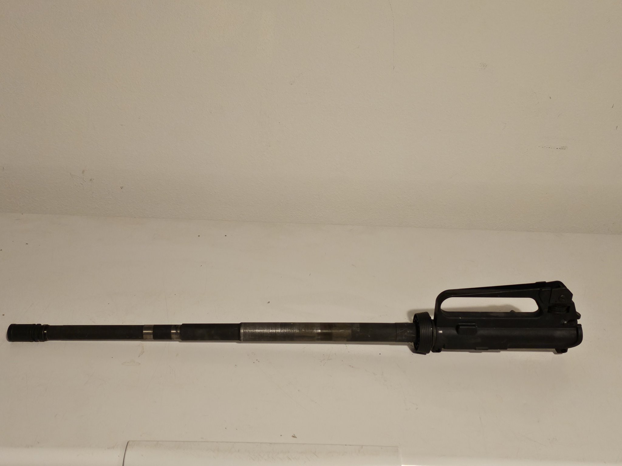

Digging through a box, I came across a pre-Remington (early 2000s) Bushmaster AR-15A2 heavy barrel upper, missing the front sight, gas tube and hand guards. It did still have the BCG and CH.
I also came across a stripped flat-top upper receiver.
Thinking of re-purposing the barrel to see what it'll do.

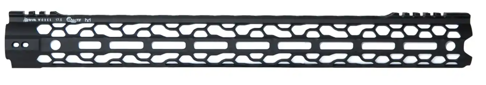

What would you run for a handguard? I'm thinking a low(er) profile with adjustable gas block, at least 15 inches.
Waste of time/money?

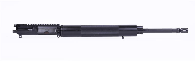

If it were mine I would piece together an upper using what you have in the photo and take it out to the range.
There has to be reasons it was parted out.
Just see if the barrel will shoot.
I bought this in the early 2000s from a USMC range in Norfolk, VA. When my eyes were still good, I used this to qualify USN Expert.
I don't remember when or why I took the front sight & handguards off, or where they are.
I think I switched out the complete upper with a 16" lightweight.
This 20" heavy barrel is a beast.
I'm not sure why you would need an AGB. If you can go non-adjustable, they make 1.9" long set screw low-pro blocks for~$25, which will cover the unfinished forward part of the journal. If you don't have any criteria other than length for the handguard, I'd buy used, clearance, or wait for a sale like Black Friday.

If you can find that FSB, handguard cap, A2 handguards, and install a rifle length gas tube properly to put it back into original configuration, I would consider that. Probably isn’t worth the effort now, but might be down the road.

I don't care for the design, but something like this 17.5" Odin handguard.
