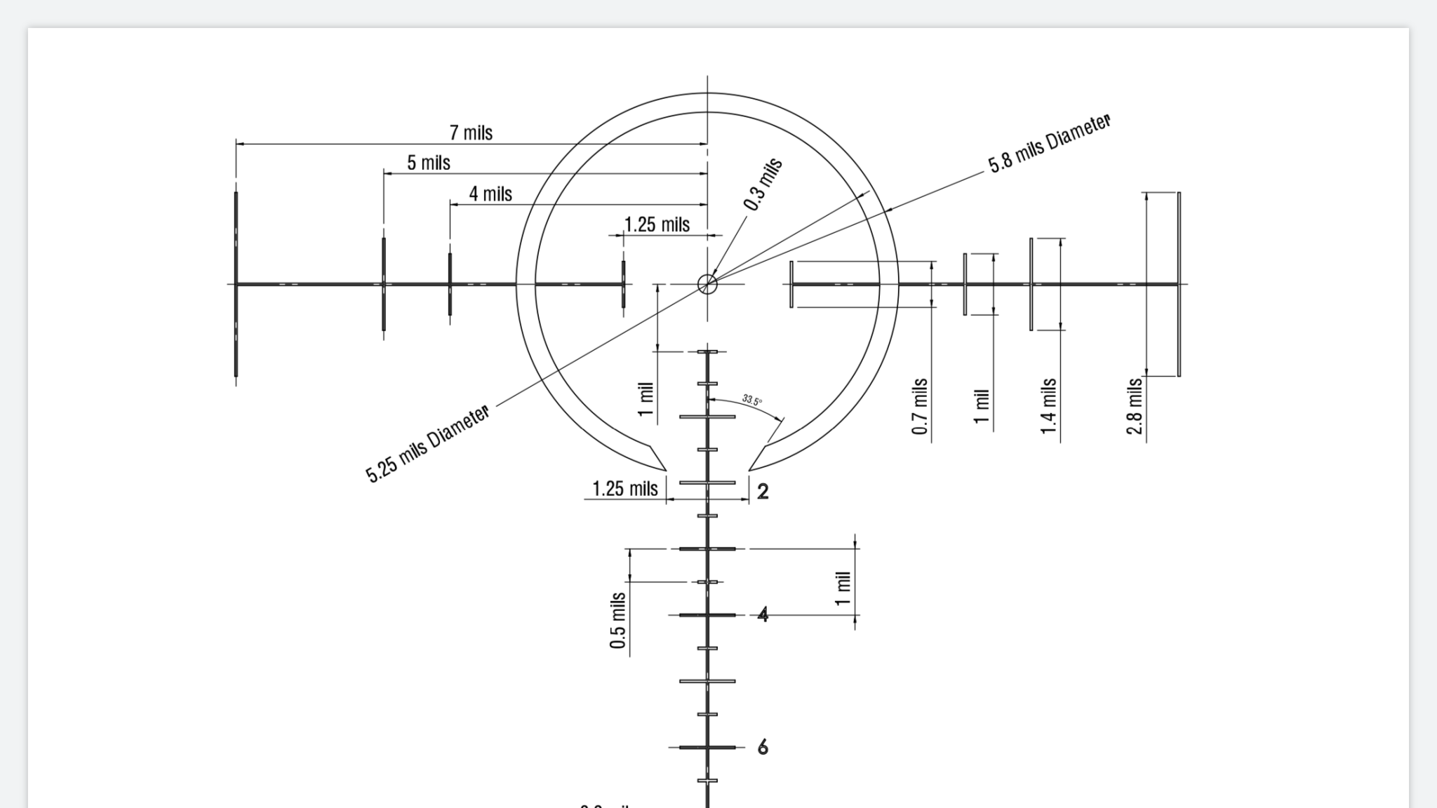

Bumping old thread... that reticle seems to be marked incorrectly?
It's 1 mil to first hash, then 1 mil between long hash... should make the 2 3 mils from center or am I reading it wrong?
There's definitely something wrong with that drawing, but it also doesn't match what's on the product page for the 1-8 SMRS.
Vertical numbers are definitely wrong on it. I had pointed that out to Bushnell, never got a response. The horizontal numbers should be correct though.

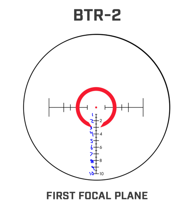

Just traded (last week) for this scope, curious as to what others think:
A) side by side with Trijicon AccuPower (1-8), and Burris XTR II 1.5-8 it appears TO ME that - Bushnell is NOT 8.5x as at 8x I am closer with other too;
It is more like 1.35-1.4x instead of true 1
Others?
B) what caliber/ammo/platform is this calibrated for as far as a drop/compensation scale, below is why its hard to believe it is MIL...
Because I do not believe its MIL as far as elevation scale and if it is - it ain’t matching impacts of my other scopes, notably Bushnell 6500 Elite (so, identical brand).
Perhaps I am not versed well (no military or sniper training) but if two FFP scopes are shot from a same rifle with a same ammo, both zero at 1 hash mark(to avoid center confusion) and same magnification(which should not ma a difference, but still) - should they impact fairly identical at 6 setting?
Should i get a hold of Bushnell as far as it being a lemon or others have similar experience or am I just a knob :)?

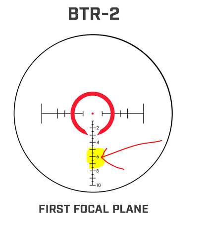

What the hell are you talking about? 6 setting?
Wait, you mean this?
If so then that reticle is a mil based reticle and 6 mils is 6 mils always no matter what the scope is because its a unit of measurement.
(especially on a FFP scope, 6 mils is still 6 mils on a second focal plane scope, it just changing the magnification means the subtensions no longer represent what they are labeled, not that the mathematical rules of geometry and physics have been bent.)
NOW whether the other scope you are comparing it to's marking of 6 corresponds with mils then its the same but that 6 could be indicative of a BDC (Ballistic Drop Compensation) which means 600 yards which will only correspond via pure coincidence.
So... to answer:
... it depends.
Yes, 6MIL elevation setting/scale.
I guess I will take out few other rifles with FFP (will have to change calibers(as 308 or 556 is not my primary over abundant lineup), but for the sake of “science” :) ) and do impact comparisons with 3-4 scopes including this one...
Do not get me wrong, I own 4 6500 Elite(s) and a pair of cheaper ones- so not a Bushnell hater...
A rifle/bullets trajectory is independent of the optic on top of it. If you want to do this then swap different optics onto the same rifle, adjust to get zeroed at 100 with each one and then take each combo out to distance and see. Just comparing a 223 to a 308 will obviously result in a different trajectories.
I might not be versed as well, but damn, show me ONE DOA scope which will have an equally spaced/ruled elevation scale???
I do know a difference between DOA and MIL
Image result for skeptical kid gif
I also know a difference between different loads (within same caliber for that matter) and bullet weight relations to a bullet impact.
Again, I have a suspicion that a scale is the above mentioned Bushnell is NOT true MIL, but I shall prove that in s weekend or two.
Question was- did anyone else noticed similar abnormalities or not.
I might not be versed as well, but damn, show me ONE DOABDC scope which will have an equally spaced/ruled elevation scale???
I do know a difference between DOABDC and MIL
Correction, BDC not DOA...
A BDC scope will not have a reticle with evenly spaced subtensions because thats the exact opposite of what a bdc reticle is supposed to be for...
Just like an apple isnt an orange, BDC isnt a mil reticle.
You clearly dont know the difference between BDC and Mil by asking any of these questions.
What makes you say that?
JC,
I was shooting two mil reticle scopes (not common in hunting BDC or DOA which would NOT have an evenly spaced scale).
At any rate, I believe have several 8mil reticle type scopes -I am planning to see/test if impacts are similar for all (0 at 100, will have paper at 100 still but will shoot 6Mil (if no 8Mil pair available, i know I have at least half a dozen with 4Mil scale/range) dot/hash at bullseye...
as I said, I believe this one 1-8.5 is off (low) but will experiment to see if its so.
