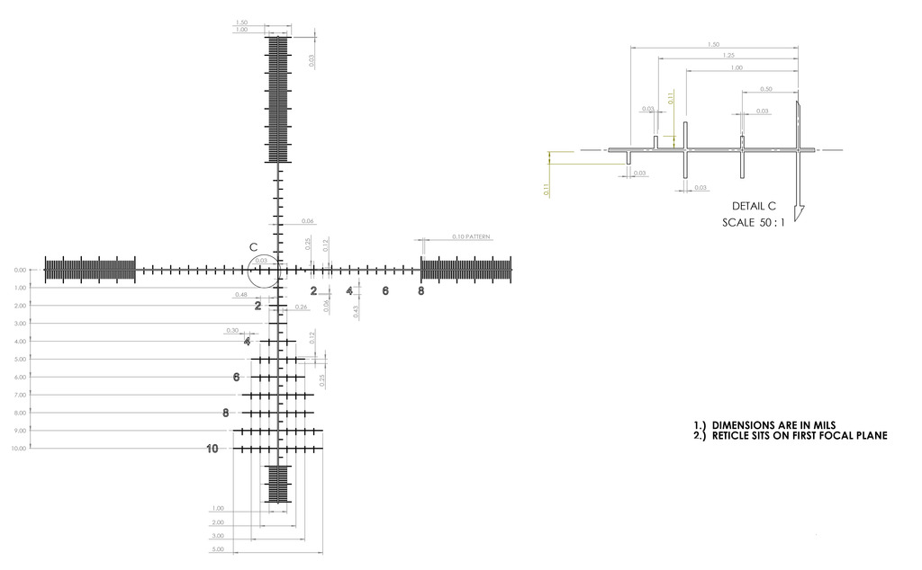

What is the thickness of the g3 reticle in the Bushnell XRS II? I can’t seem to find the reticle subtensions anywhere for this particular scope. I can find the reticle sub tensions for the LRSHI and DMR II scopes but many manufactures thin down the reticles on the higher power scopes which I am not a fan off. I find that .05 mil is about right for me. If the XRS II illuminated model is there, I may give it a try.

If I remember right, the non-illuminated is .05 at the center, and the illuminated is .1 at the center. As far as I know, there's no difference in the G3 used in the DMR2, DMR2 Pro, and XRS2, and the G3i in the DMR2 and XRS2 is also the same.
