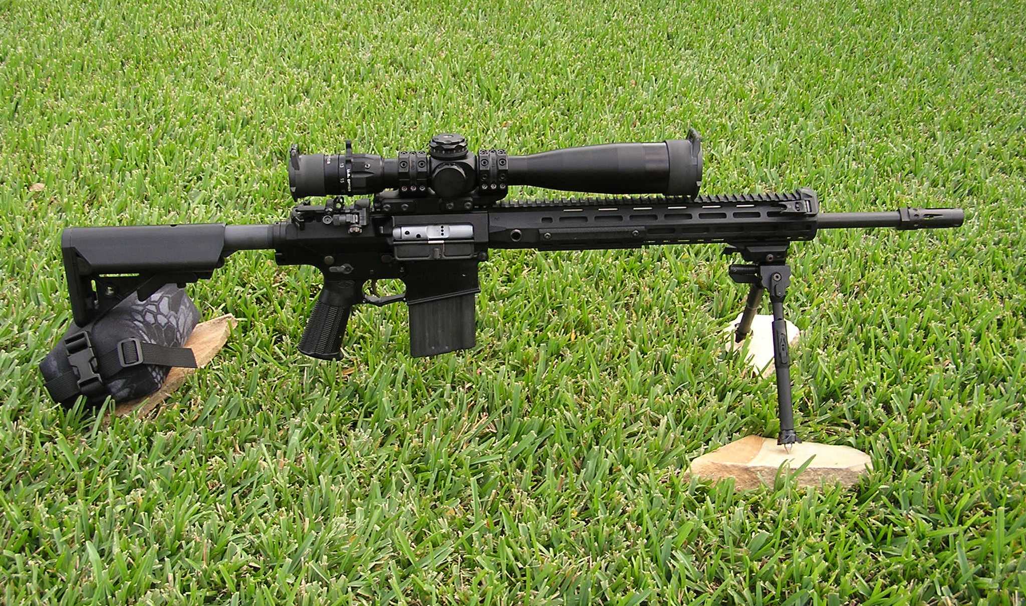

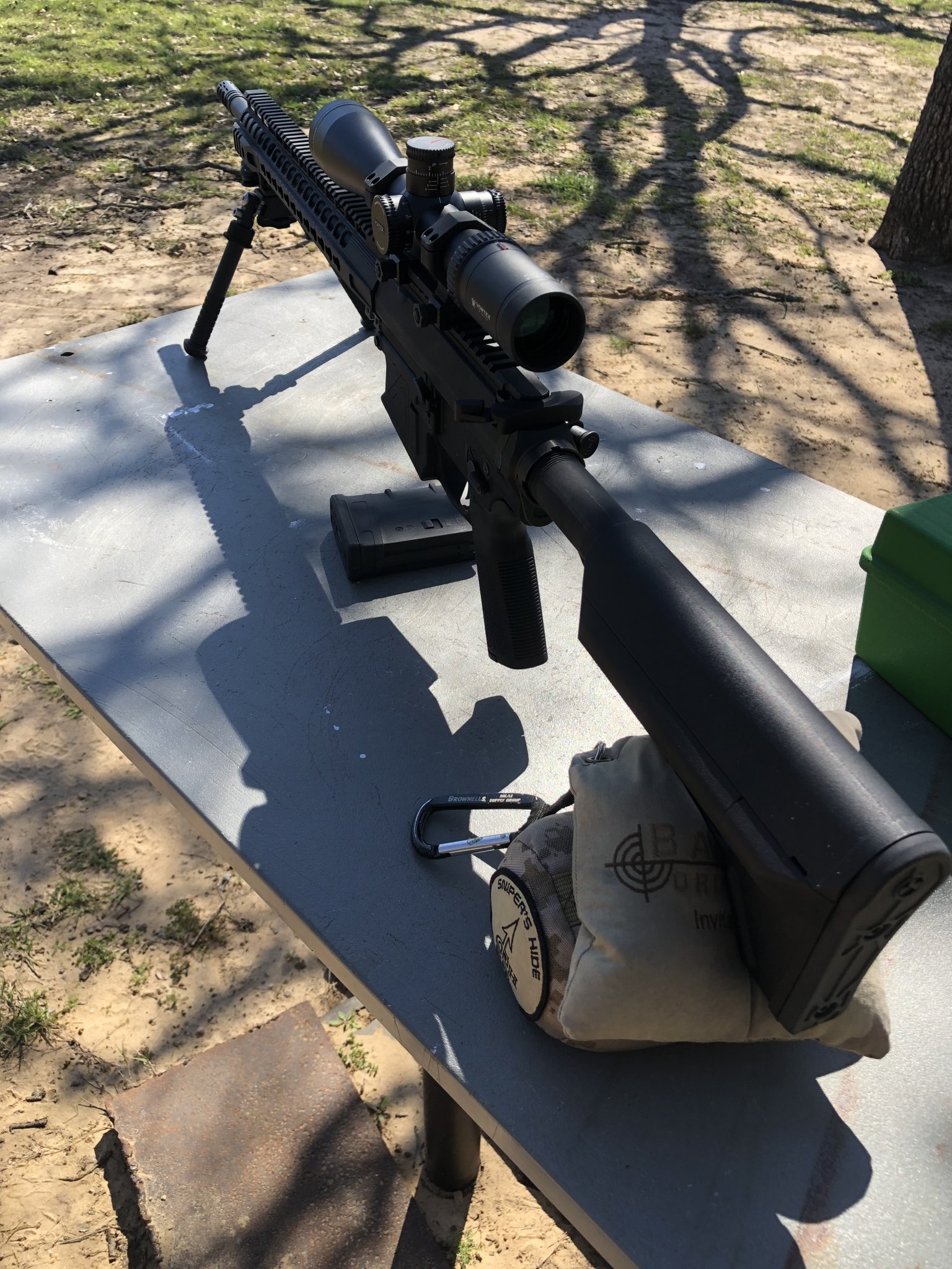

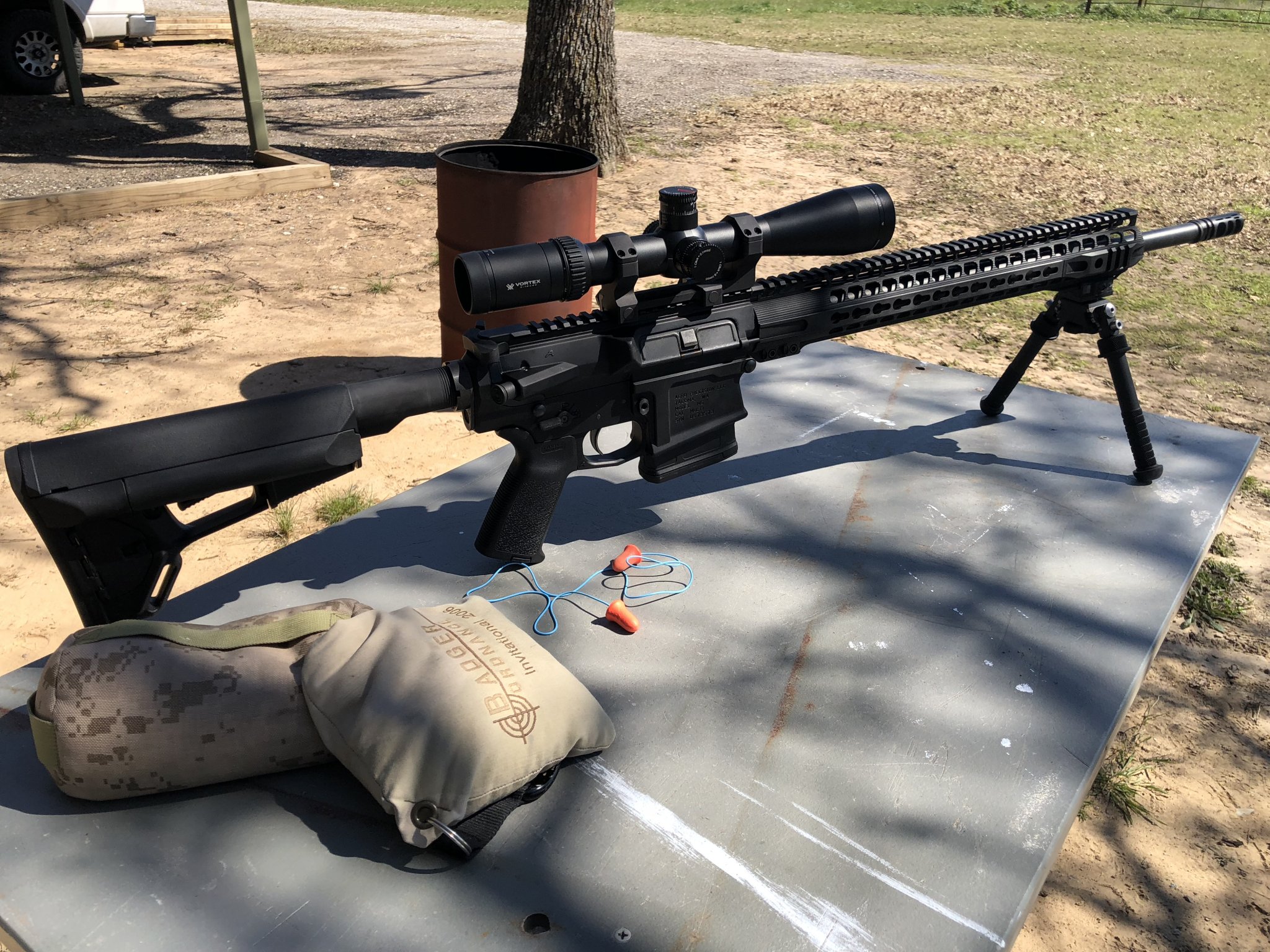

I just finished this one a couple weeks ago. 20” Ballistic Advantage modern series barrel. It’s built on Aero M5 receivers. I used an Armalite 6 position 308 Carbine extention that’s 3/4 longer than a standard carbine extension. I’m also running an H3, 5.4 ounce carbine buffer. Rifle runs and functions 100% but also has a Superlative Arms adjustable gas block.
Oh and the stock is a Magpul ACS.

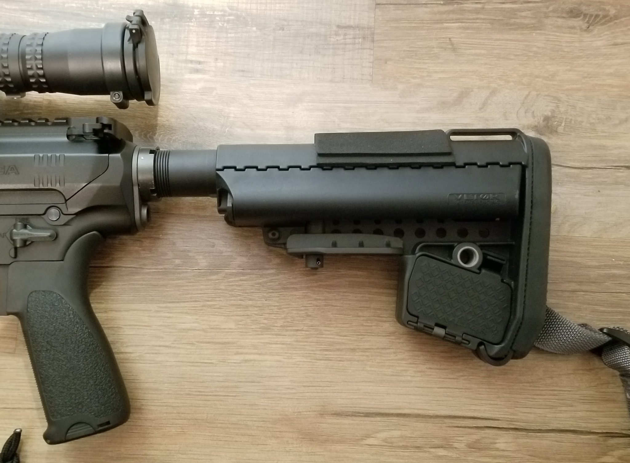

This is what i use on my 308. Vltor emod with some adhesive foam to build up the cheek a little. Not a ton of room for bag riding but it's better than some. I use a vltor a5 tube with a h3 carbine buffer.

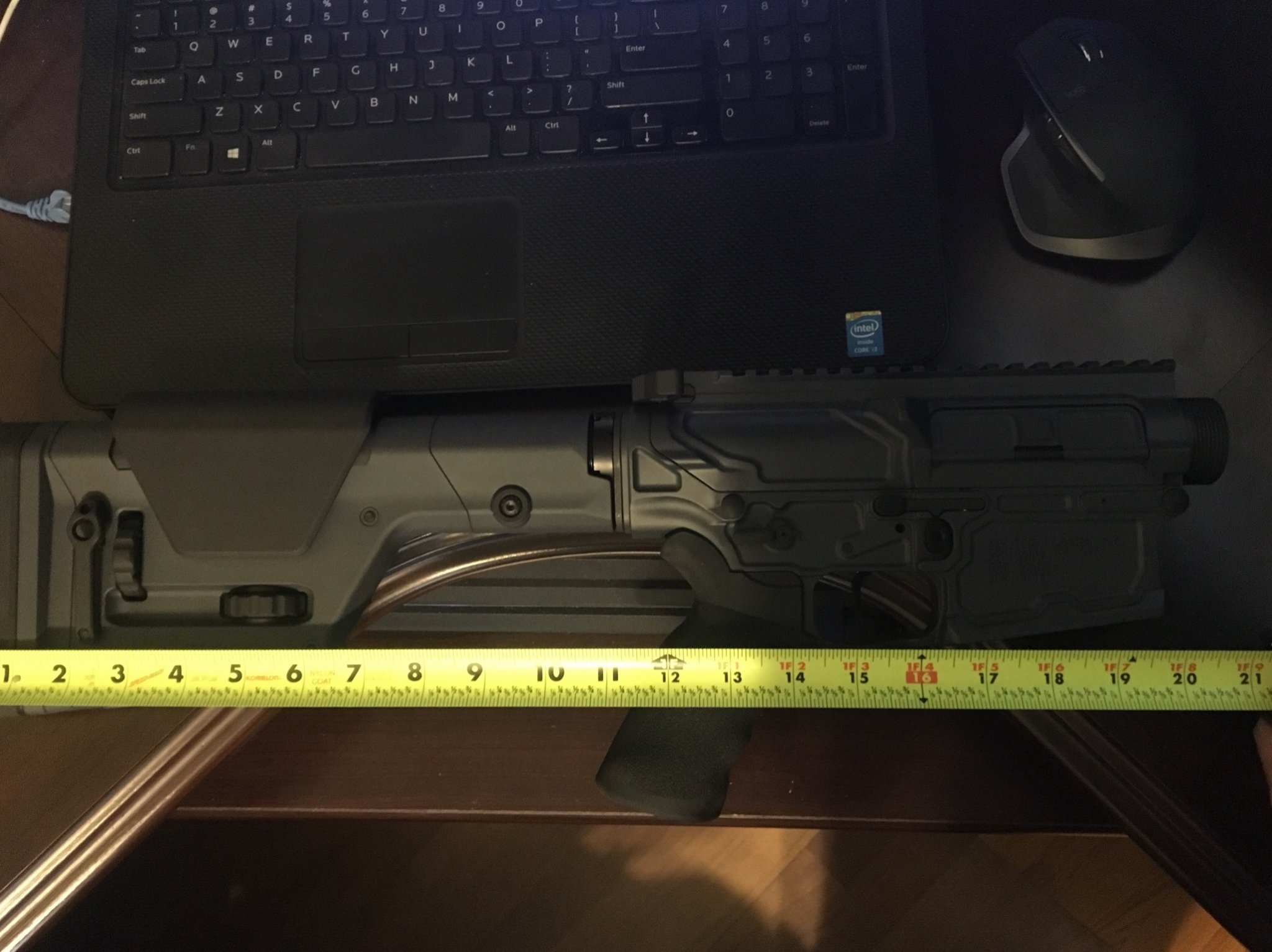

I measured the buffer tube on the SR-25 and the AR-15 and they are essentially the same as measure from the rear of the lower. I spoke with LMT and they also answered some questions. I'm not sure which stock I will go with yet though. Thanks for your help.
