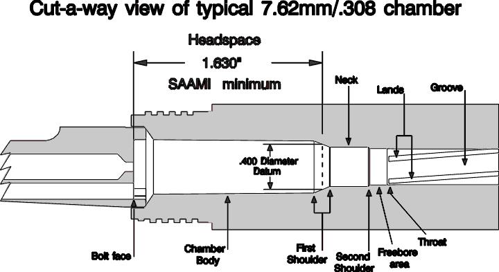

Thanks, I was confused between the terms. Cartridge overall length is what fits in the magazine. Case overall length is what fits in the chamber.
Just to be clear . . .
Case overall length is the length of the brass casing from its base to the mouth. Whatever the maximum length it can be is determined by the length of the chambers neck area, which can vary from barrel to barrel and caliber to caliber.
COAL: Cartridge Over All Length is the length of a loaded cartridge from its base to the tip of the bullet. That length can vary by choice and is limited to either the length of one's magazine or the length of the freebore in one's barrel chamber. The latter is typically longer than the former.

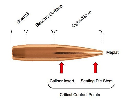

CBTO: Cartridge Base To Ogive is the length from cartridge base to the ogive of the bullet and measured with a comparator that proximates the diameter of the lands in the bore.
BTO: Base To Ogive, is the reference of the measurement from the base of the bullet to that part of the ogive measured with one's comparator as above (the whole area above the bullet's bearing surface to the meplat is the ogive).
Here's a couple pica that might help FYI:
