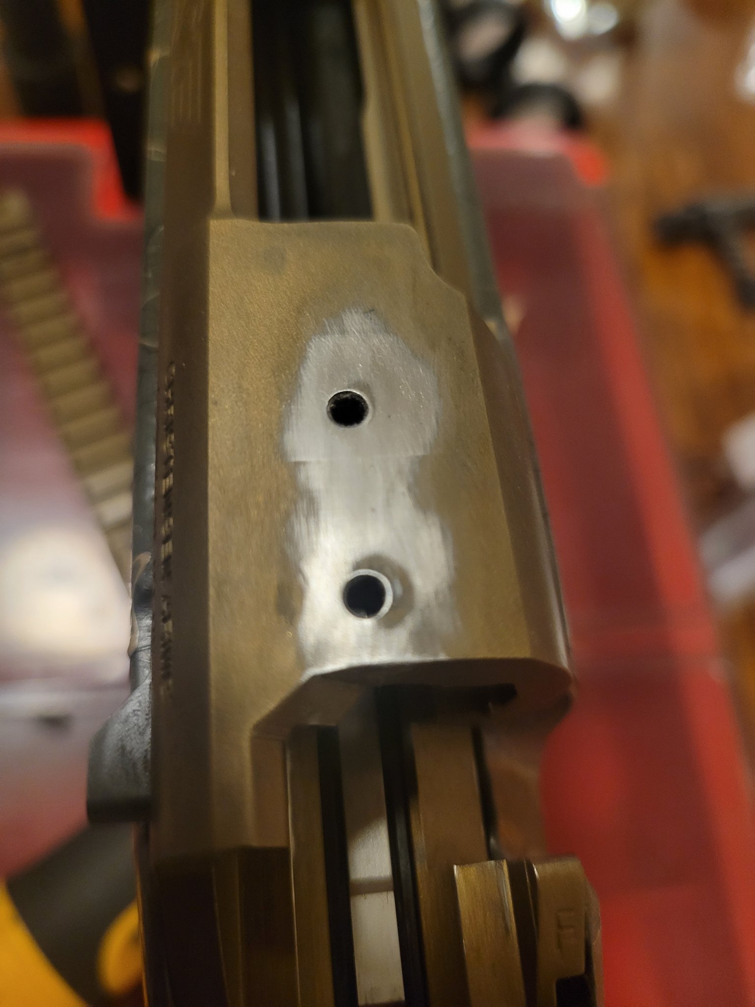

If you have a scope rail on the receiver, remove it and closely look at the bottom of the rail and top of the receiver to see if there are any spots that might indicate the two surfaces might be moving against each other. Let us know what you see.
I did before I put the latest scope on...the rear 2 holes in the receiver had burr marks, I sanded them down lightly until it was smooth...

Bed the rail as stated. Coat the action with clear shoe polish, or if your baller, mclube 1700L, bed the rail to the rifle and see if that fixes it.
If that don't work send it back again. It's either barrel or bedding.
