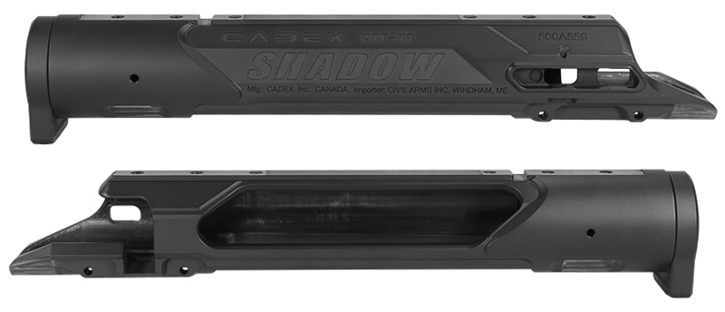

Does anyone know of a manufacturer of an aftermarket CADEX CDX-40 Single Shot action?
CADEX say that they are aware of manufacturers, but for understandable reasons, will not disclose :)
I'm visiting the SHOT show and will look around, but perhaps someone has a shortcut.
338 Lapua Magnum bolt face.
Thanks in advance.

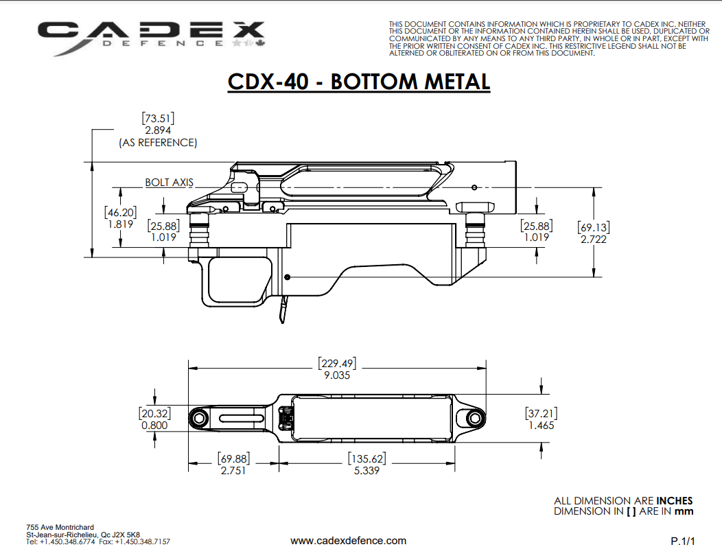

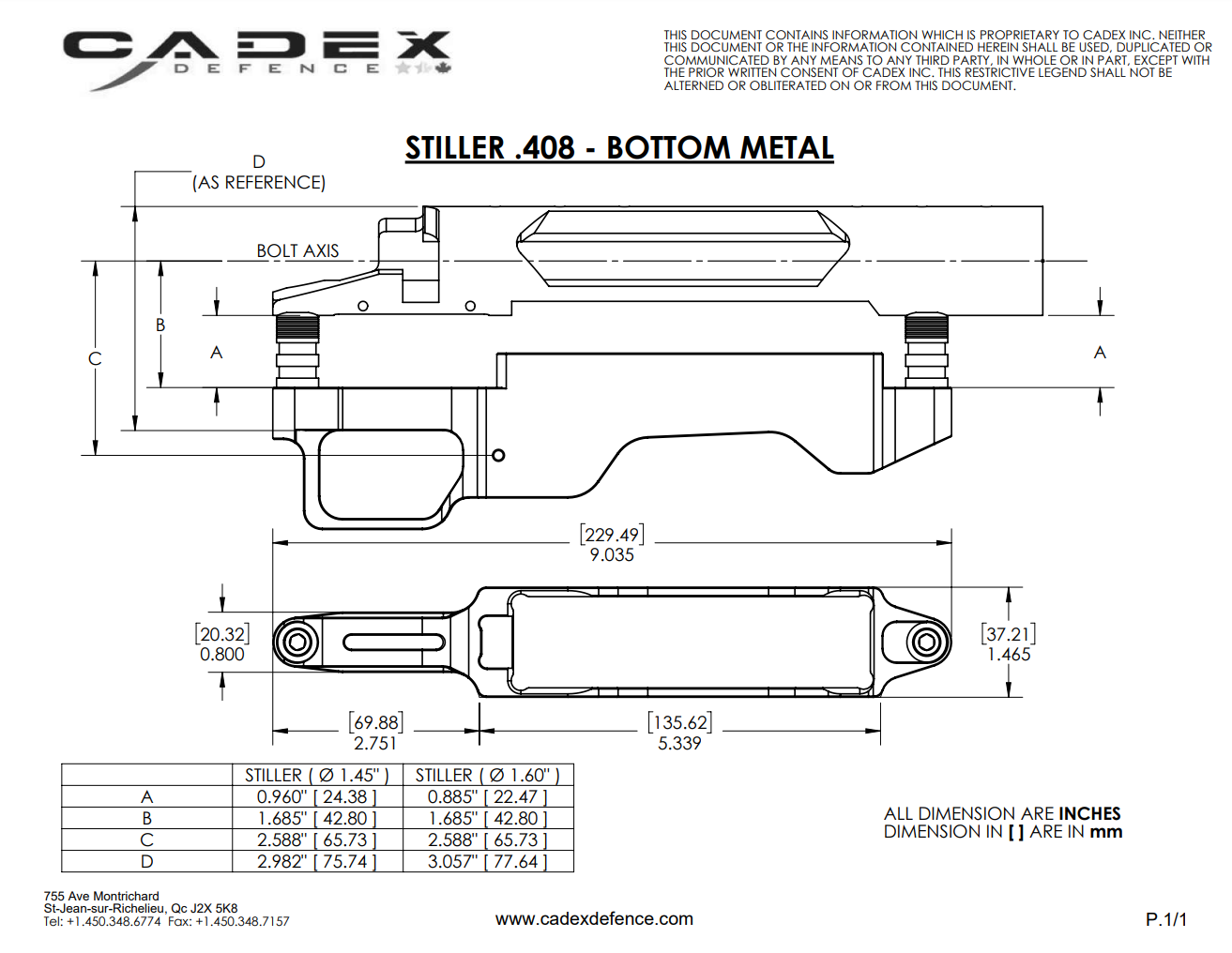

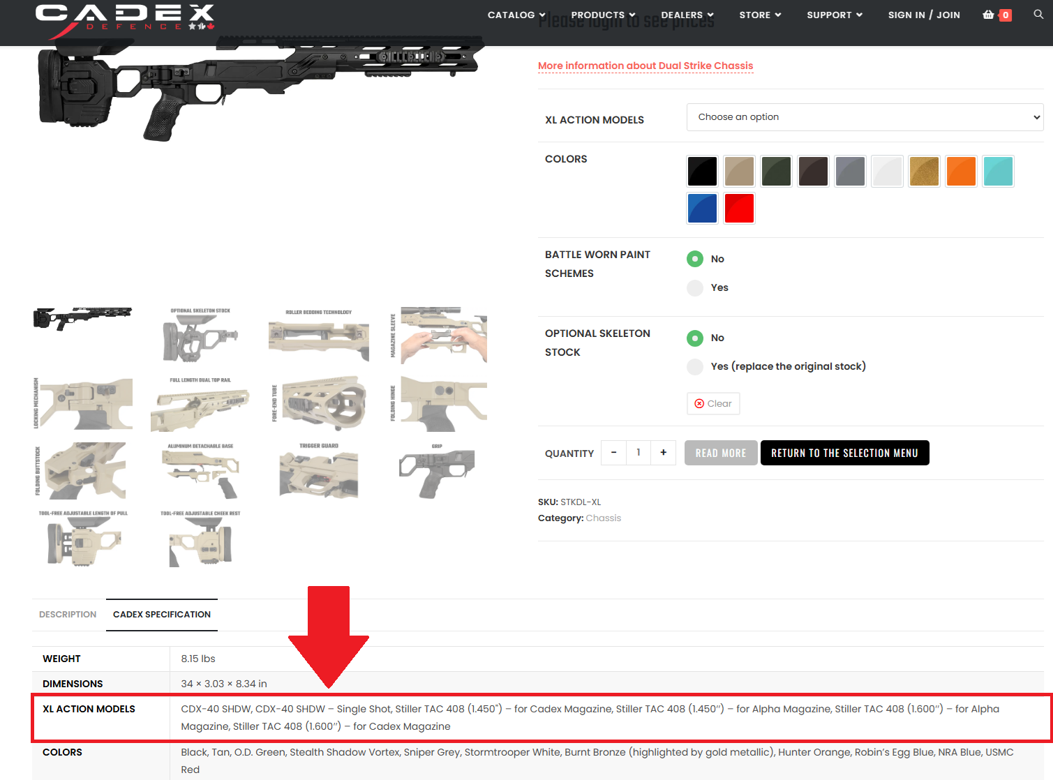

Needs the Dual Strike XL Action chassis for the Stiller (since you already ordered the Pierce 10x). If you don't have the chassis yet, change the order or cancel it and get the appropriate Dual Strike from the drop down list. Action screw hole spacing looks to be the same as their CDX-40, there are Z height differences though.
https://www.cadexdefence.com/product/dual-strike-chassis-xl-action/
https://www.cadexdefence.com/produc...tals/cdx-40-bottom-metal/?hilite=bottom+metal
Thanks for this.
I had been too focused on the Single Shot.
Thanks to you, I can ask Jim at Peirce if he can make me a TAC 408 (10X or 20X) with a 338 LapMag bolt. :)
