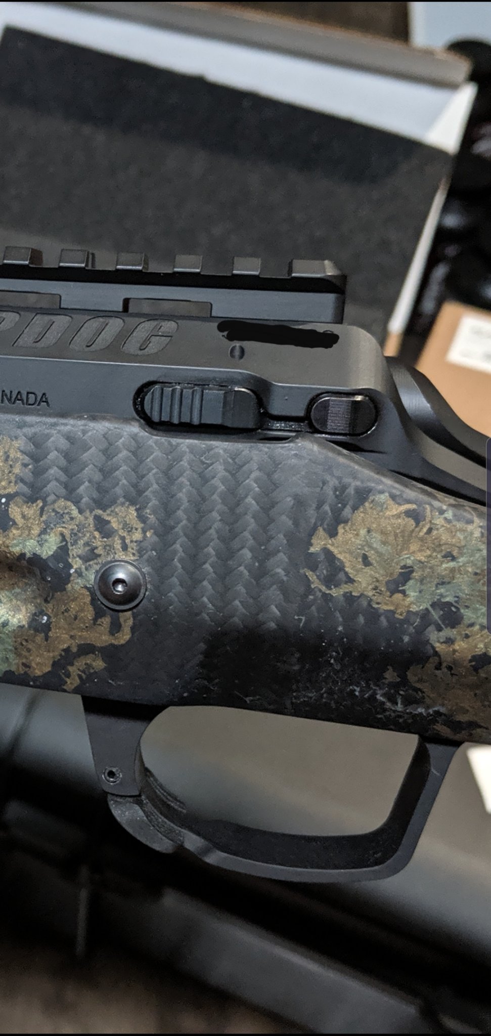

Yes. On 3 different manners stocks so far. The 4th is on it's way. I'm calling it a night but can get more specific for folks beyond what I posted below. For both LA and SA Cadex Shepheard and Sheepdog actions.

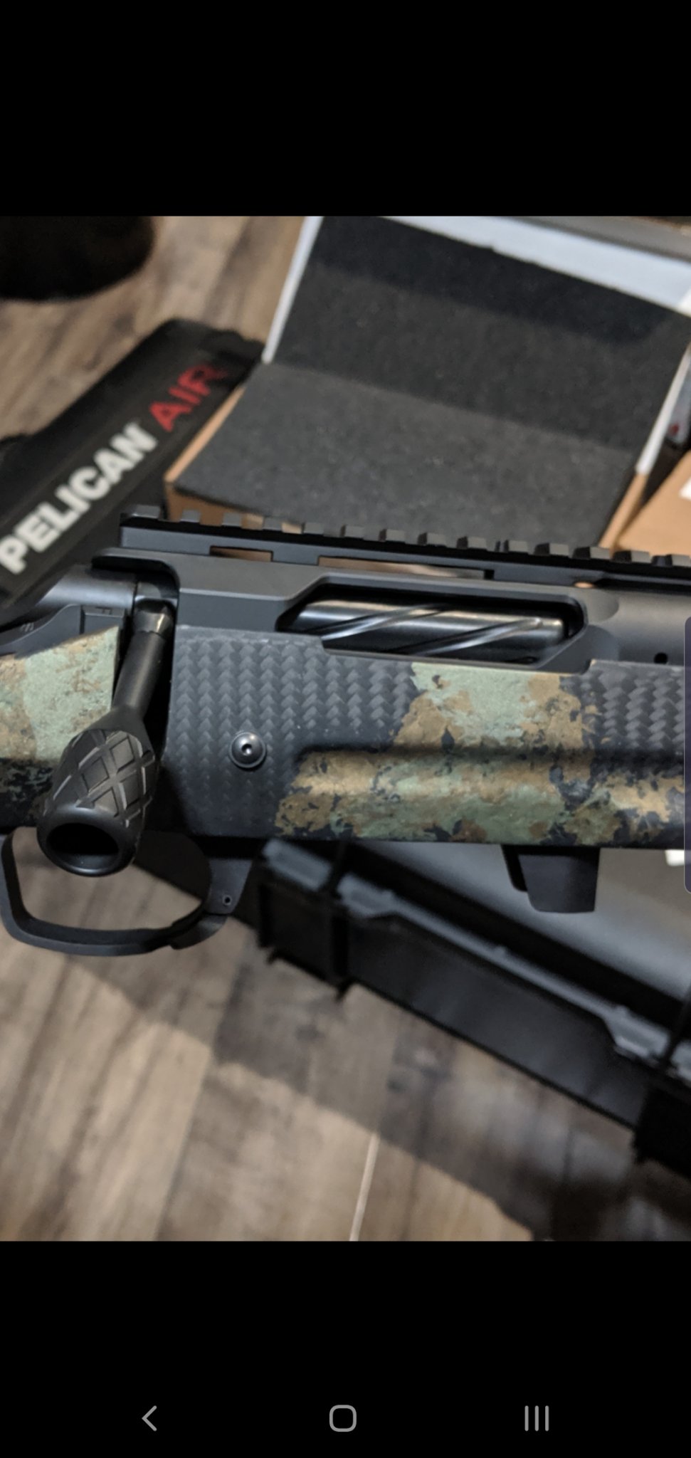

This was a Sheepdog with Impact inlet with Mini chassis.. the bolt release was fine. Worked great. Ejection port needed to be opened up big time. The area under the bolt handle was very exposed just like the the LA one below. The TL3 SA is the same results as what's below.

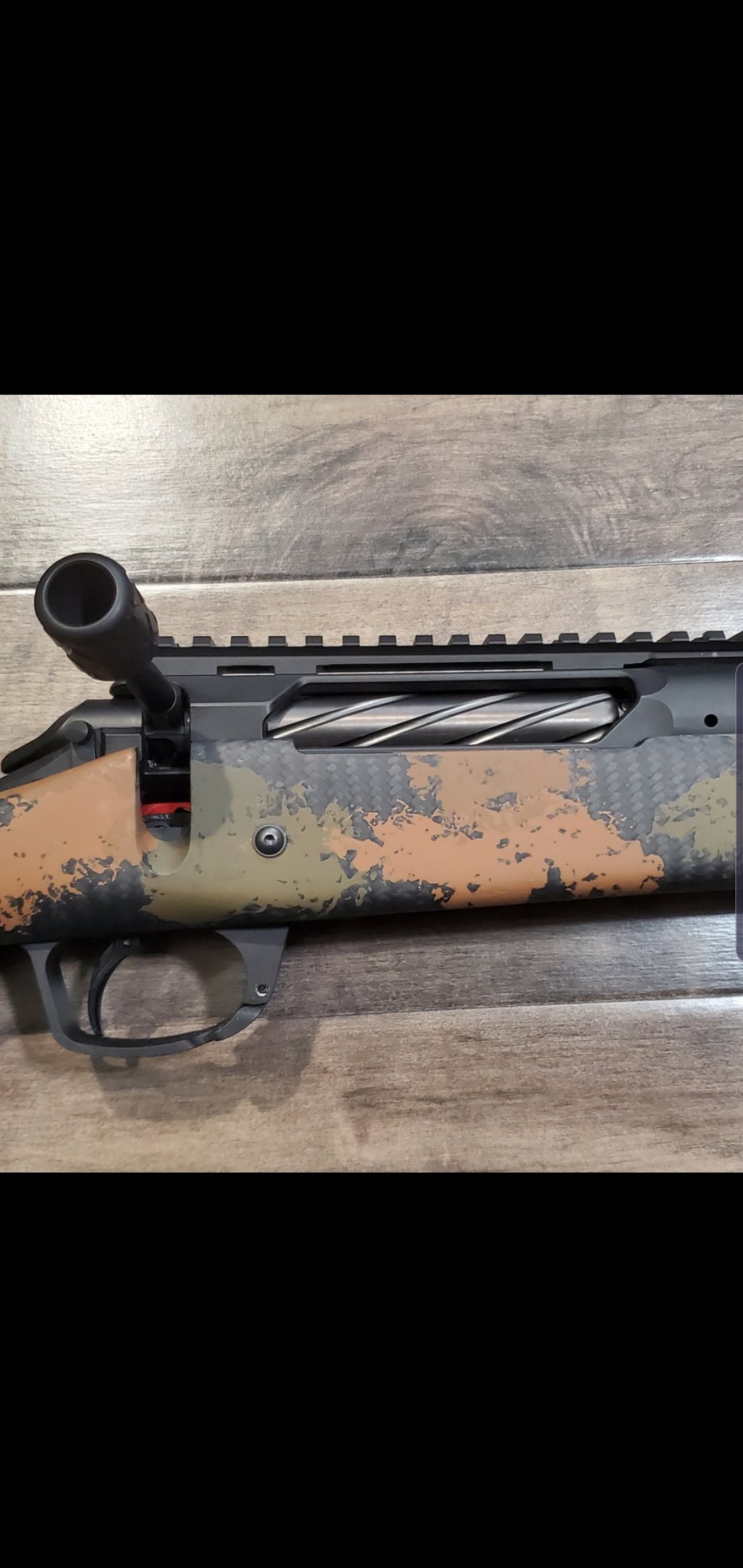

Here is a LA Shepherd in a TL3 inlet CIP mini chassis. The bolt release just ever so slightly was tight. But still worked. Ejection port didnt fully line up. The bolt handle cutout is much too low.

For the LA I just said screw it and bought the strike nuke with CIP chassis because I didnt want to hack it up opening the port. I was too impatient to send it back to Manners as I needed to use the rifle.. On the SA I now have my 3rd manners showing up and that is inlet for a Defiance. I'm having Tom modify the one I have outstanding at manners currently, before they ship it, and that was originally for a TL3 SA.
The KRG worked great. Plenty of room for the bolt release and also ejection port. But these chassis systems are cut much lower on the action and meant to be universal.
All of the Rem 700 clone Manners stocks I had worked. Just slight variance inbetween them and I dont have a mill to make it look nice the way I wanted. So thankfully Altus has had some in stock for me to buy over the last few months to try out.
I've just been eyeballing what ones have a shallower bolt handle cutout and ones that have larger ejection port openings and bolt release cuts. Eventually I'll get it close enough to just call it good.

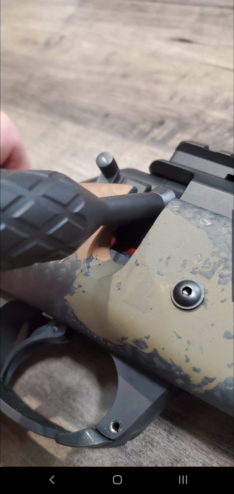

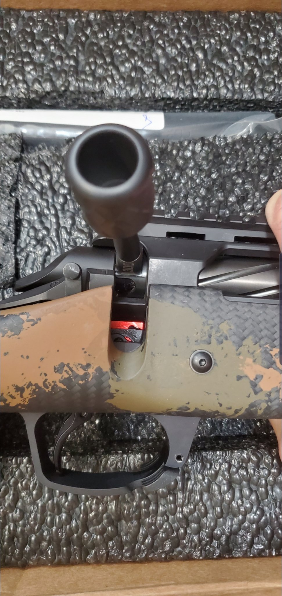

Other manners showed up. This one is a defiance inlet mini chassis. The safety clears on this one without having to take any material out of the trigger pocket on the mini chassis. The ejection port looks the best so far. Going to leave it. The bolt release slight hits on the corner but doesn't bind and still functions. I may take the edge off the stock where it touches but still functions fine. Still some excess gap under the bolt handle but not as bad as the impact or TL3. Just going to run it.

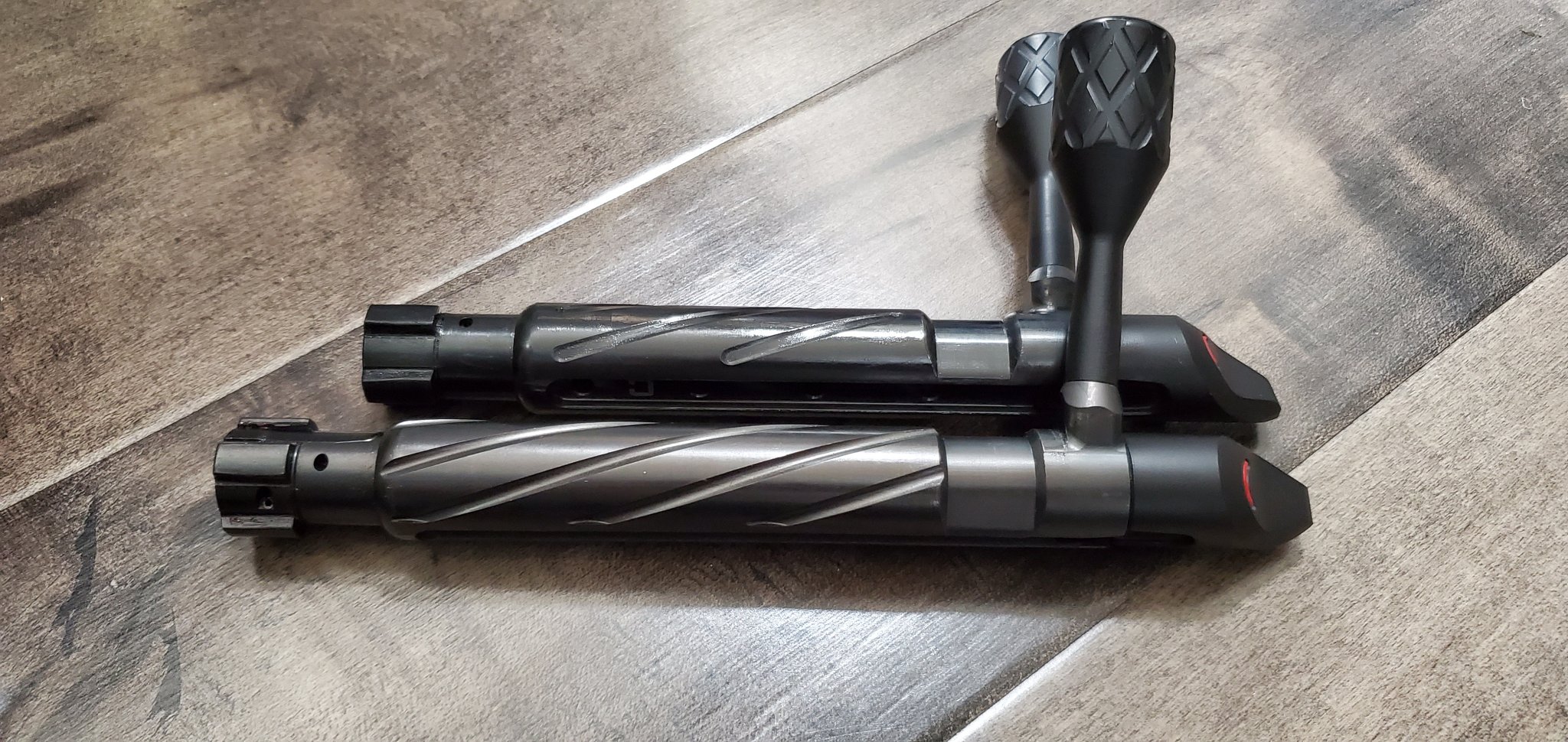

Do the Cadex actions have oversized bolts?
I hate it when companies do that, they are not solving anything and only end up inducing problems.

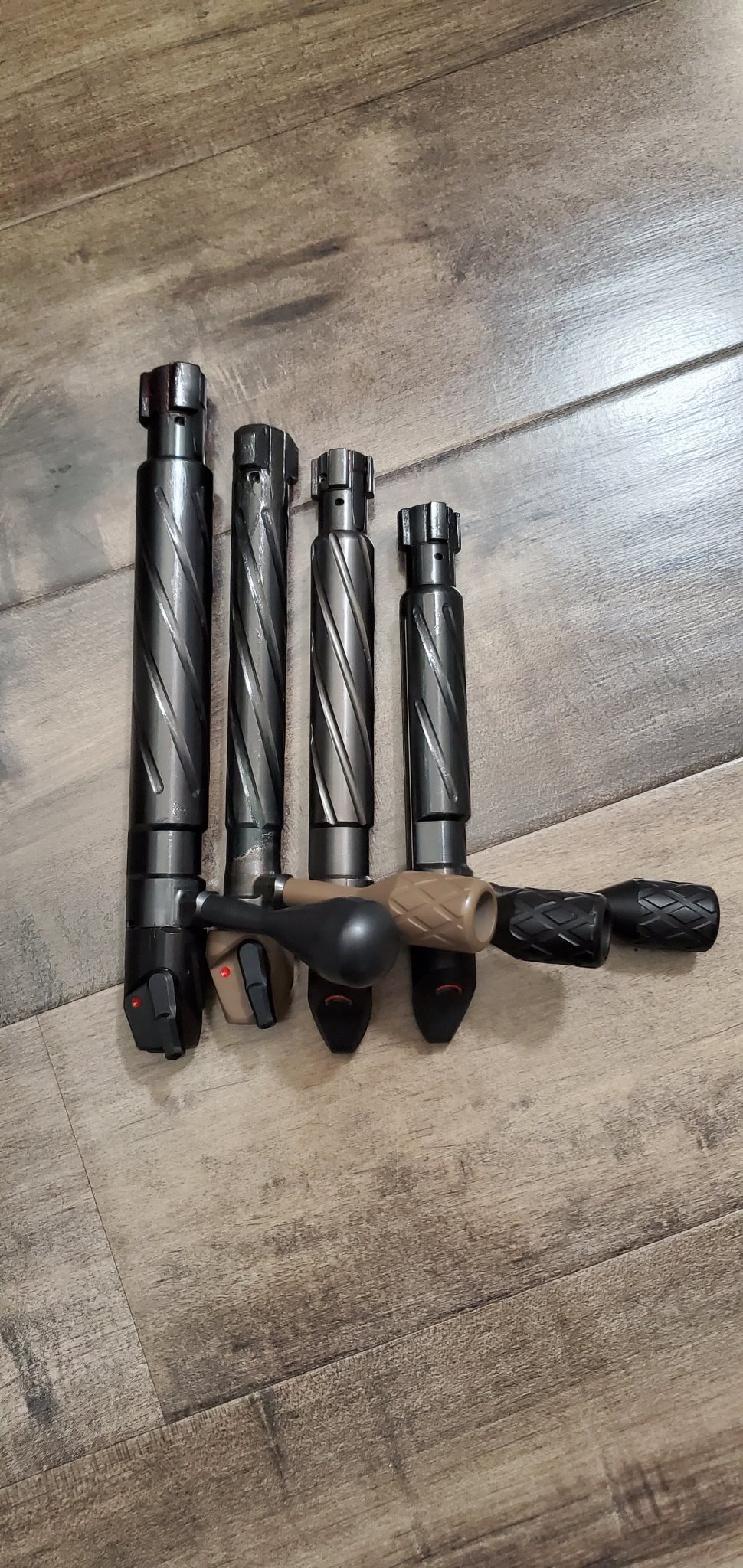

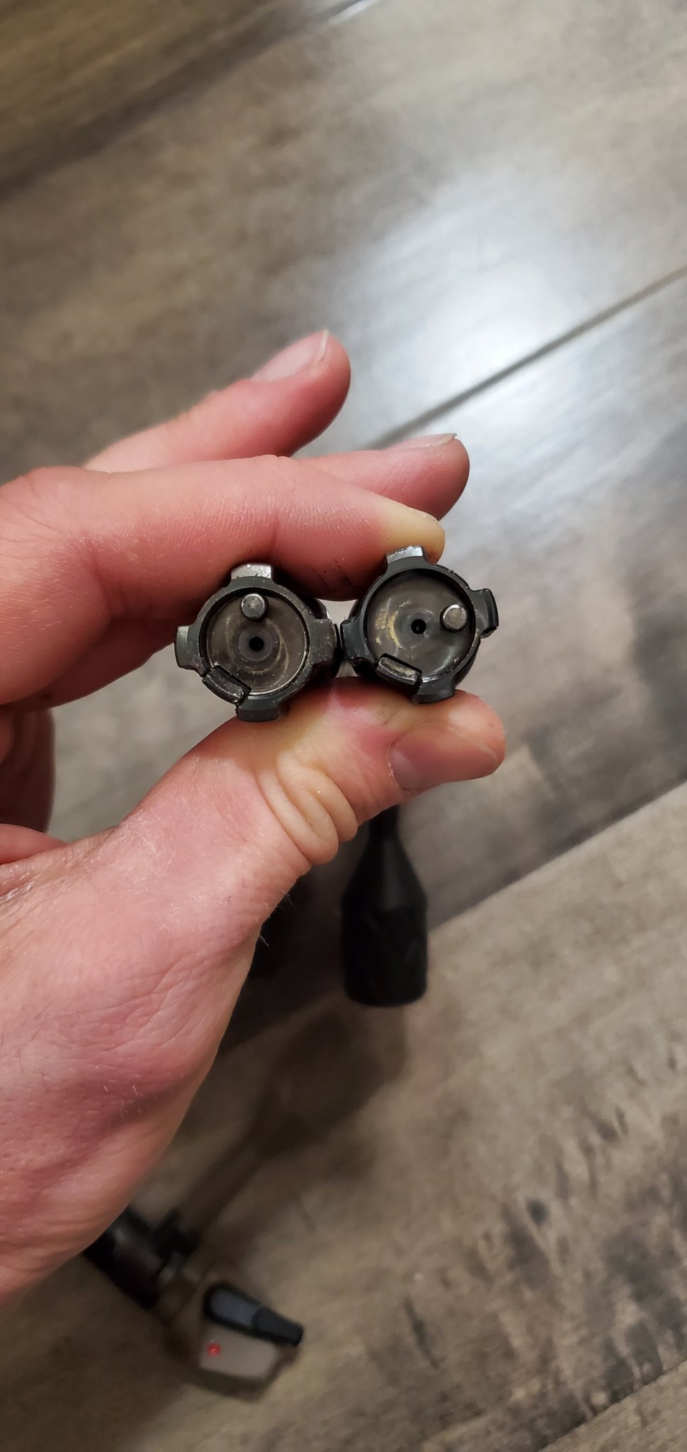

They do. Left to right... CDX-40 bolt for 375ct, CDX-30 bolt for Mags, R7 Shepherd for mags, R7 Sheepdog in SA mag.
Then the second and third pic is of the R7 cadex bolts themselves. These have 4 lug bolts. The CDX actions are 3.

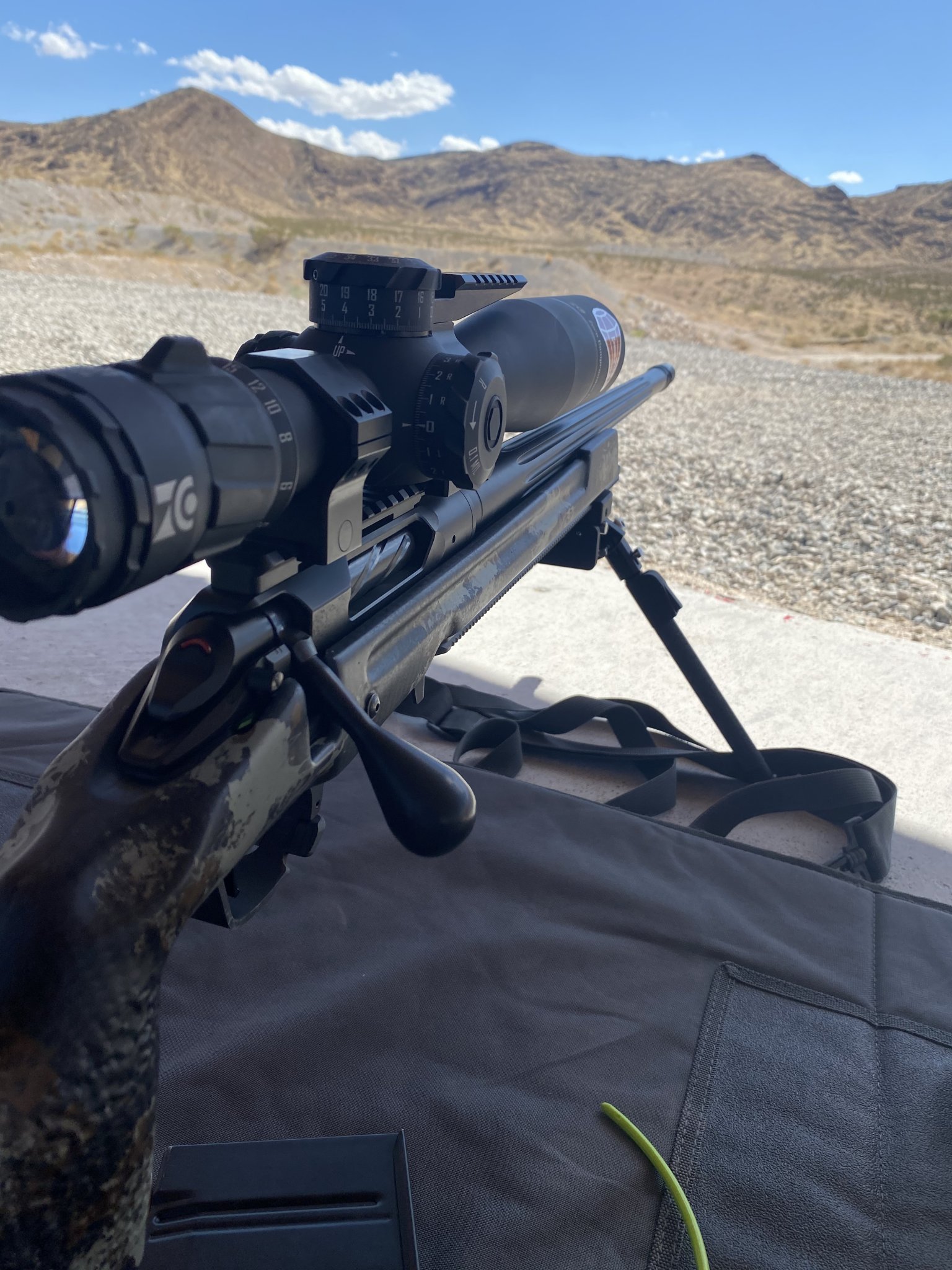

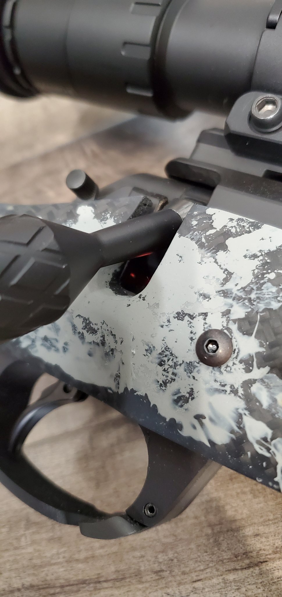

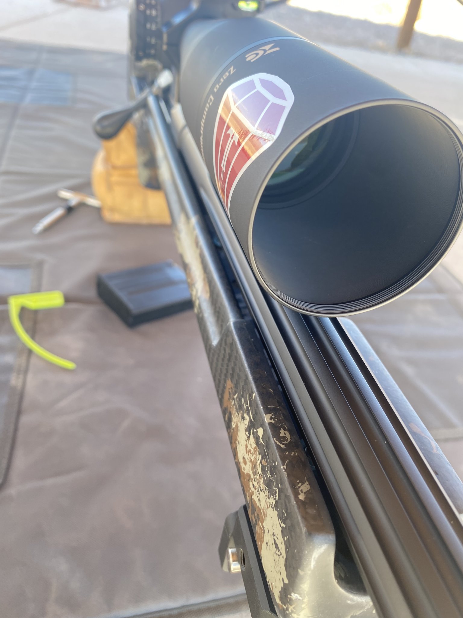

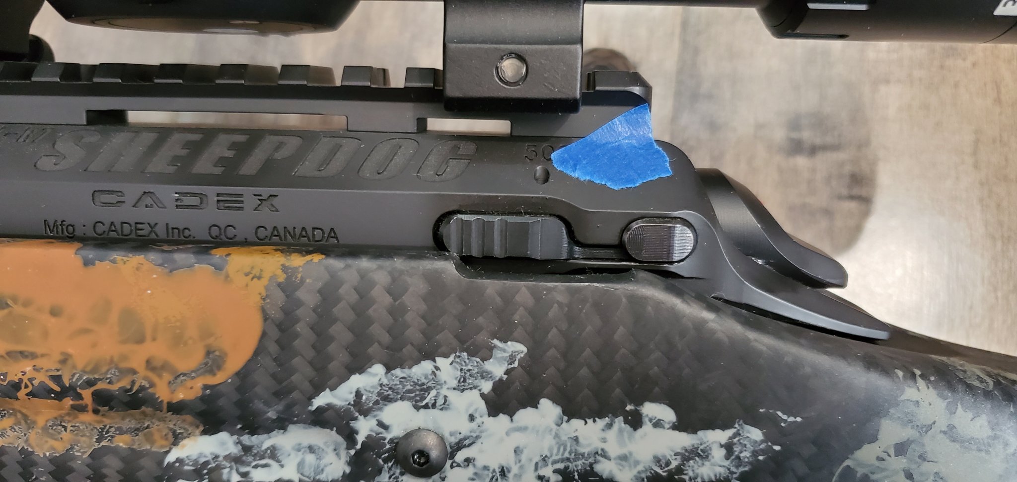

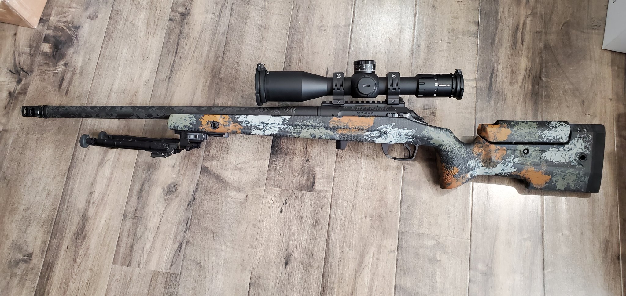

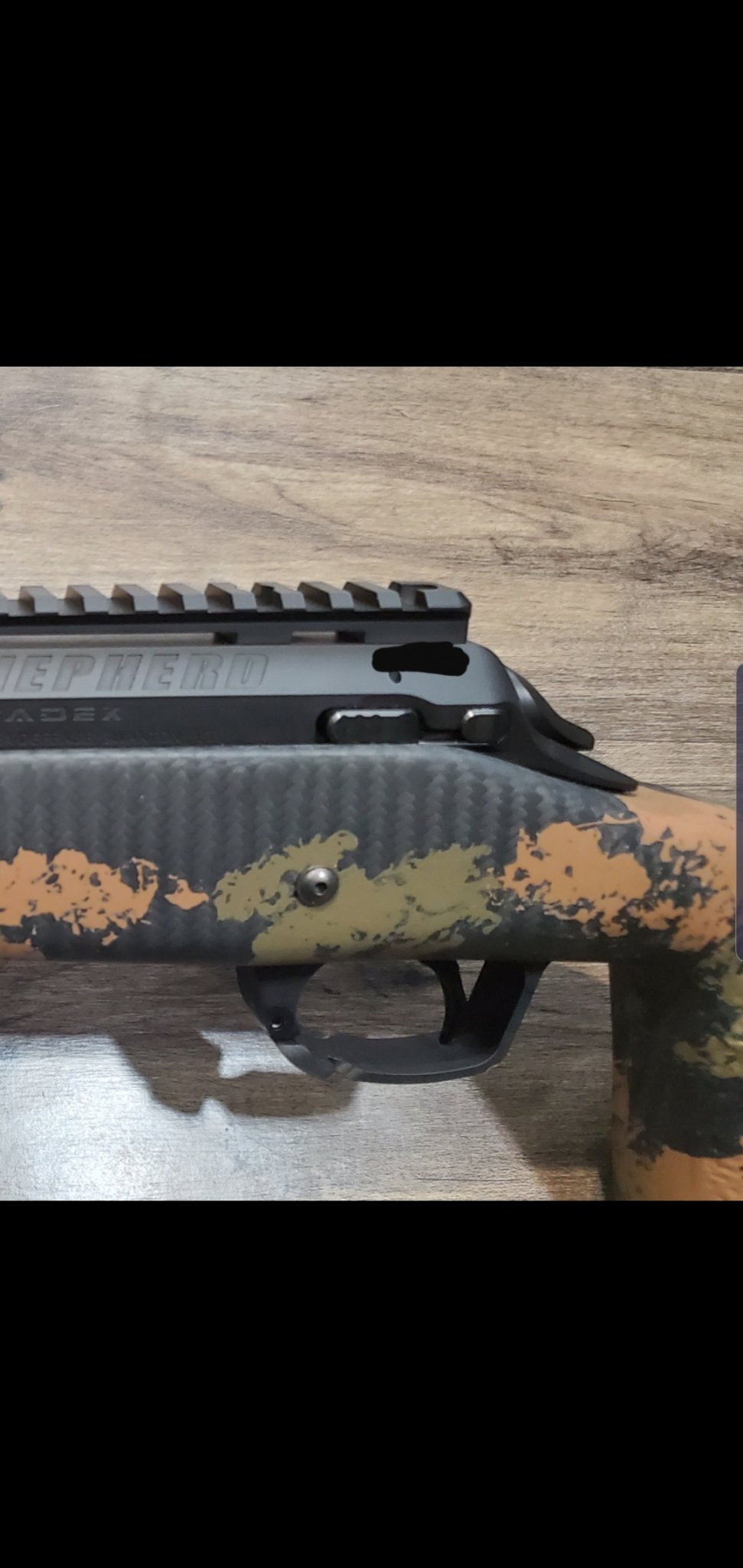

Here’s to reviving old threads, I just got a sheepdog R7 rifle currently sitting on a strike nuke which I really like. Been looking at manners stocks and am glad I saw your post about fitting. We’re there any ejection issues due to the cut out not matching or was it purely cosmetic?
Cosmetic only. Fed and ran fine for me without issue.
Reactions: Islas82
Yes. I’m debating on getting a Cadex barreled action and dropping it in the TCS. I already have a Cadex Shepherd and enjoy it, just wanted to try something new. Any other feedback/thoughts with your current setup?
I love it, the cadex action fits perfectly and there’s a lot of clearance for a bigger contour if necessary (currently running cadex barrel contour) I have not fired the rifle yet on that stock but I will this weekend
Wonderful to hear. Let me know your thoughts after the range session. Much appreciated!
