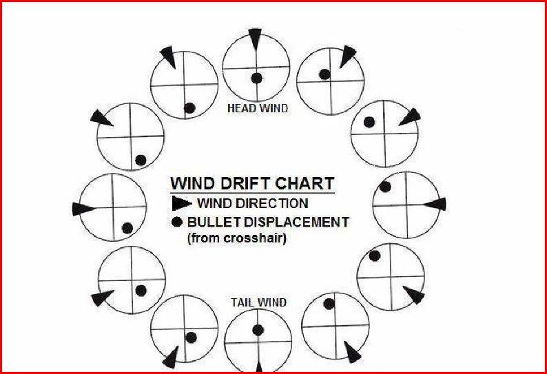

Hmmm??? Maybe this will help you figure out what might actually be at play:
This is all fine and dandy theory, but every bullet will have different deflection due to MV. Your gonna have to shoot and dope the wind. Sorry but there is no easy button on this one. @Jack Master and @lowlight will no doubt have some additional color to add. And oh, what if I’m using a LH twist?

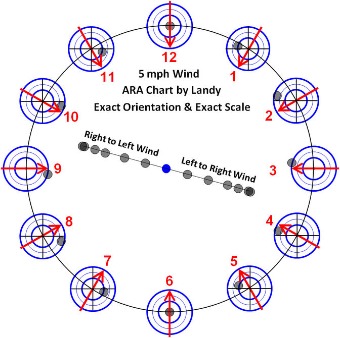

Those charts are close with centerfire rifle, but I have experienced the same thing as the OP with 22LR. Both occasions the wind was over 17mph, seems like 15mph and under, no issues, it is just backwards from what we are told to expect.

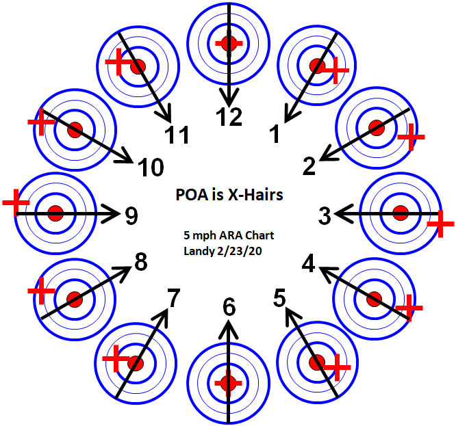

To me its most likely the wind was not at 6:00 but possibly switching from 5:30 to 6:30 or from one of them constant and you could have been missing just left or right. A 12:00 or 6:00 wind condition is the hardest to shoot in because a very small switch changes which direction you bullet drifts.
Before we blame the bullet or gear we have to really look hard at the environment and the shooter. They are usually the source of errors long before the system.
A pure tailwind is very rare.
What usually happens is a switching 5-7 o’clock. Enough to push the bullet off for a miss.
Combine that with hard to see Rimfire bullets and/or not great spotter (most people aren’t that good at spotting, especially if not directly behind shooter)……and you’re in for a rough stage.
As long as you checked parallax, like actually moving your head around, that should be fine. But parallax is larger the closer the target, so Rimfire is especially vulnerable.
As well as weird things like lighting. A switchy wind with some weird sun in your face + across the target at a weird angle = rough day.

Headwinds and Tailwinds never are, true head or tail, as in 12 O Clock or 6 O Clock, it, like all wind, moves, and the misses are not high or low but left or right because there is always side elements to it.
And the key, it switches, on my range. , constantly, one round could be held left, the next round held right, then back to left, it might be, left, left, right, center, left, right, left, right, right, left, right, left, center, left, right... all in one minute
So the idea in these winds you are calculating based off a .1" measurement is a joke, or at least the internet version of a bad plan.
Headwind and tailwind talk is amateur hour
