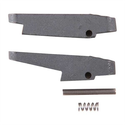

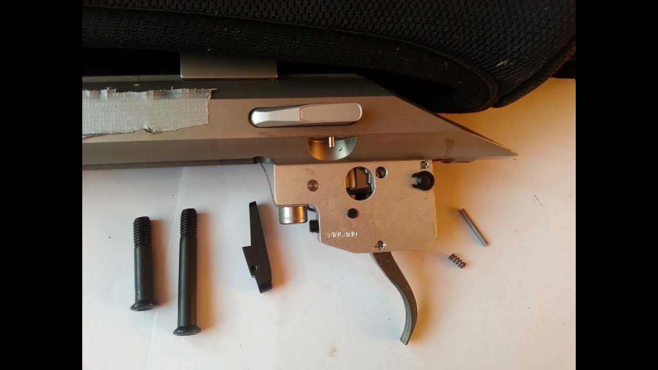

The difference between the tikka actions is just the bolt stop length.
So its not really a "modification" to the action, just a part swap.
But you dont have to put in a shorter one to make it work or anything, you will just be able to pull the bolt back a bit further than necessary.

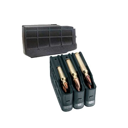

As you can see, the 223, short action and long action mags are all the same outside dimensions. Its just how much of a space there is in the back. It shows how much further you could pull the bolt back beyond the end of the next round with the longer bolt stop installed feeding from a shorter cartridge magazine.
So really the only issue is trying to swap cartridges that have different bolt face diameters, say a .384" bolt face for 223 to a .473" bolt face. Going from .473" cartridge to .473" cartridge like with a 270 to 6.5 creed will be just fine.
