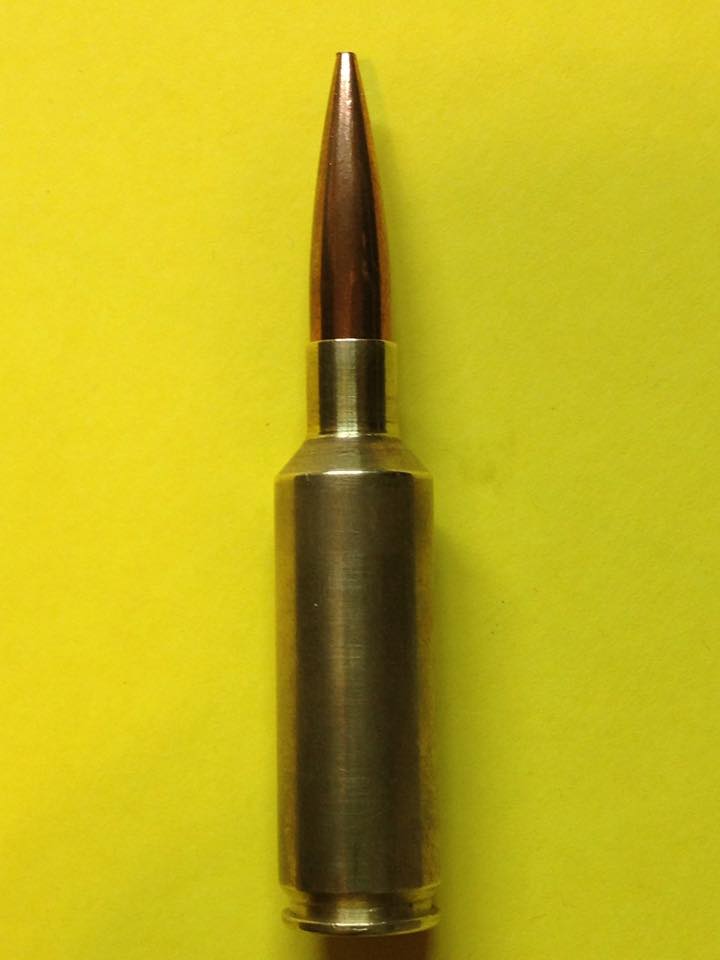

    I've got a 6.5 saum, but am thinking about a 7 saum also for hunting larger game, elk mainly. I like the velocity of the 130gr at velocity. I'm thinking the 7 for heavier high bc bullet.
    Deano
    If you don't mind a little expense, fire forming, and going wildcat i recommend either the 6.5 sherman shortmag or 7 sherman shortmag. Basically a shortened SAUM with a 40 degree shoulder, so fireforming is required but you can run a 180gr hybrid at mag length at 2.960 and not protrude into the case capacity. Same scenario for the 6.5 SS.
    I've seen a member on LRH push a 23" 7 SS to 3300fps with a 180gr Hybrid. Well past what i'd consider safe. Having said that safe velocities from Rich's testing look like this out of a 26" tube. Step down to 6.5 SS and 3000fps with a 140 out of a 22" barrel would be easy. He sells prepped 7 SAUM brass from Norma (expensive at 2.70$ a pop) and has 6.5 SS and 7 SS brass coming form ADG, which would just have to be fire formed like the prepped norma.
    168s at 3200fps
    175s at 3100fps
    180s at 3070fps
    195 at 2955fps
    I'm building a 20" 7 SAUM to run in a short action with a suppressor. I wanted a rifle that would stay supersonic to 1200 for steel but short enough to hunt with from a blind and conveniently stalk with.
    Based on Quickload I can run the 168 VLDs around 2850 fps with RE17 or Norma MRP. I can also push the 175 Elite Hunters around 2800.
    Those each improve on the ballistics (less drop and drift) of a 300 WM pushing the 220 smk from a 26" barrel @ 2850.
